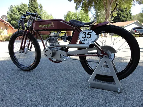

We did some pretty serious testing today. Leaving the front primary gearing alone and working with the split rear sprocket system we had the following results:
48t rear sprocket at 71 mph
44t rear sprocket at 76 mph
40t rear sprocket at 68-75 mph
It would appear that the 40t in the rear is just a little too tall to push. The 44t seams to be the best balance. All speeds were measured with a properly calibrated digital speedometer mounted on the bike and a chase vehicle so these are accurate numbers. Bike was rock solid stable at these speeds, too. Speeds were also not just momentary numbers. I held it at 75 mph for at least two solid miles before I let off. It's a big claim but I think I now own the worlds fastest motorized bicycle!

WHOA!!!!!!!! That thing is bad. I love this bike. One thing though, the bike is perfect and far beyond anything i could ever build but to my eye, one small thing that looks odd to me is the silver secondary chain guard. I dig the silver primary chain guard but feel your bike would be that little bit nicer if the secondary was red. Just a small criticism, just thought id share my $0.02.
Either way one of the nicest bikes ever built here, and definitely the fastest.

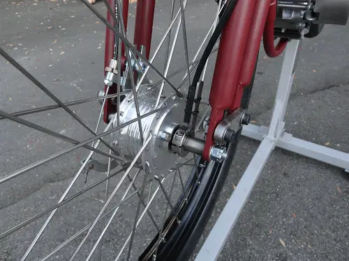

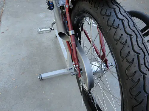

Can we get a nice shot of the wheels and tires. Going with motorcycle wheels was a great idea.
My brother Rich get's credit for pushing us in the direction of motorcycle tires. It's nice not to worry about a tire exploding at speed, and 76 mph on H rated rubber is nothing to worry about. Rims are custom drilled for our spoke selection. Hubs have a fair amount of custom parts as well with upgraded axles, backing plates and spacers. Here are a couple pictures.
