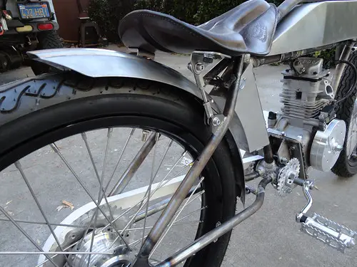

Seat and fender detail. Fender is a reproduction of a vintage Harley, rolled with the center raised section, and is tough as heck. Seat is a Mesinger Racer with my custom mounts.

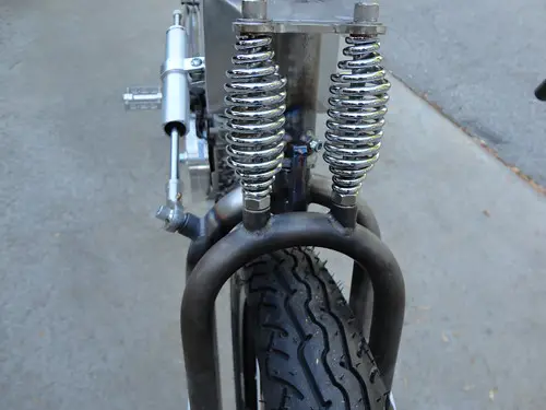

Fork detail with steering stops and steering dampener/stabilizer.

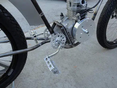

Reduction drive system installed. I turned both pedal crank arms to the rear and then locked out the pedal system. Can be converted back to pedal operation for street use.

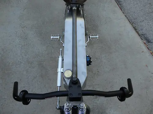

Top view showing layback pedal system, centrifugal clutch assembly, steering stabilizer, and a vintage cruiser style Tuf Neck stem because I had one!

The backwards chain guard is a nice detail and the fender is really cool!
Did you build rollers to form it or is it a one up hand fabbed?

Beautiful work. On your reduction drive, how did you lock the pedals in place?
Normally I run a small idler just behind and below the pedal sprocket. The idler mounts on a lever arm and is adjustable. I shortened this bracket and bolted through one of the sprocket holes.

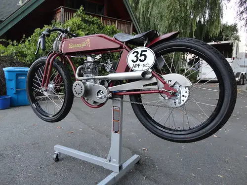

I have been a bit busy with no time to update this build thread till now. Here are a couple fresh pictures. Bike is painted in a satin finish Indian red. Most everything is ready to roll. I really like how the forks came out and the 21" motorcycle tires should be safe at WOT. Rear split sprocket system will make gearing changes easy without wheel removal. I added extra chain offset to clear the 3 1/4" wide tires, and then reduced the same amount between the primary and secondary sprockets on the BB reduction hub. Engine remains centered in the frame for proper chassis balance. Final drive ratio is in the mid 7's.
Bonneville Flyer by Sportsman Flyer, on Flickr
Here is the primary guard, and behind that the chain guard. I have been drawing away on the computer then testing my patterns in poster board mock-ups before cutting steel. Both guards are stainless. 175 cc engine recorded 17.5 hp on the dyno. Shane at AGK built the engine and did all the dyno work.

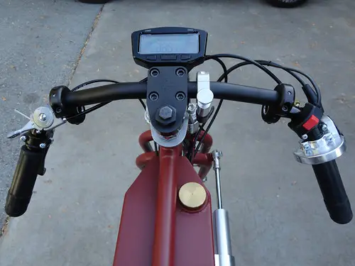

Here is the BTR handlebar detail. Computer will give us engine RPM, temp, and speed. It's a complicated layout. Much more going on here than my previous builds. Left side of bars carries fuel petcock shut off lever. Just to the right of the stem is the lanyard kill switch (lanyard removed), then toggle kill switch. Below that on the right side of the tank is the steering stabilizer.

The handlebars are pointed "business end down" like the original BTR's. That will cheat the wind for sure. Where is the extinguisher system? Lol. Looks fast standing still Pat!
