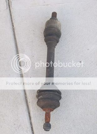

Finally getting back to working on my 'Intrepid' cyclecar again. Something I have discovered though is that the splined shaft on this Peugeot CV joint.......
..... matches the splines at the centre of this 16 inch scooter rear wheel I purchased recently.
Discovering this chance fit makes setting up the drive just so much easier than I thought it would be. :D
That modern alloy wheel should be able to be disguised with a disc cover if I find I can't stand the sight of it.
