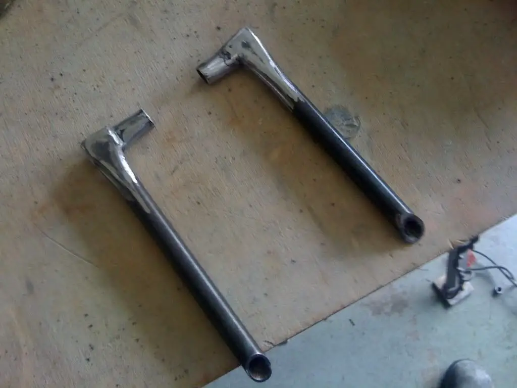

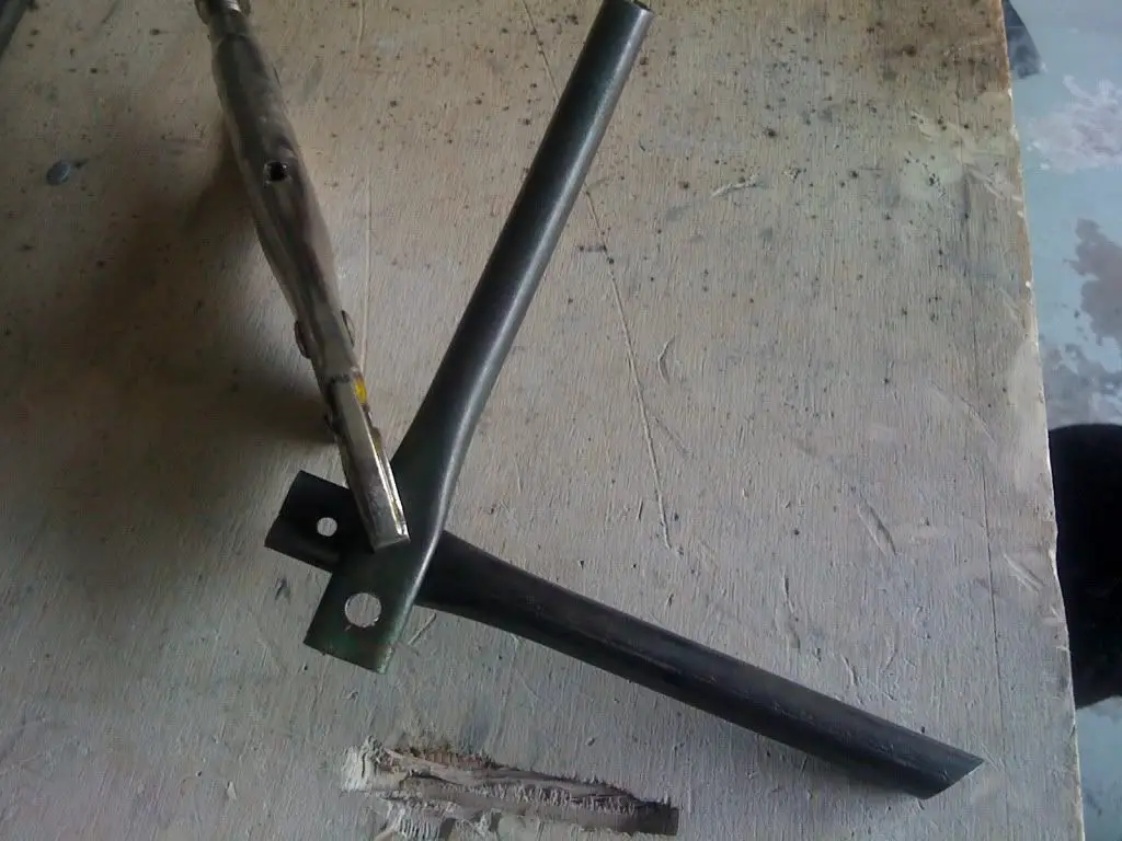

Its been raining here for a few days (we needed it) and ive found it hard to move from the couch, but i did a little this morning: i scut down the throttle assembly i had....
Before:
After:

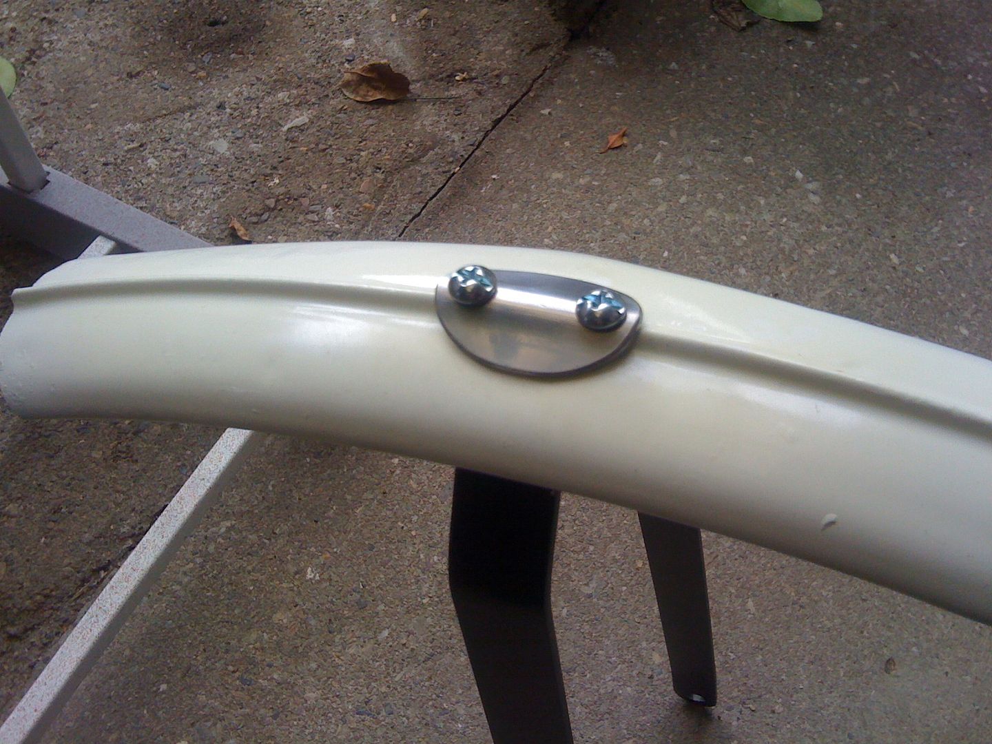

I fitted the stainless steel fender brackets i made to the guards, i sanded them up and gave them a polish and they came up like chrome.
