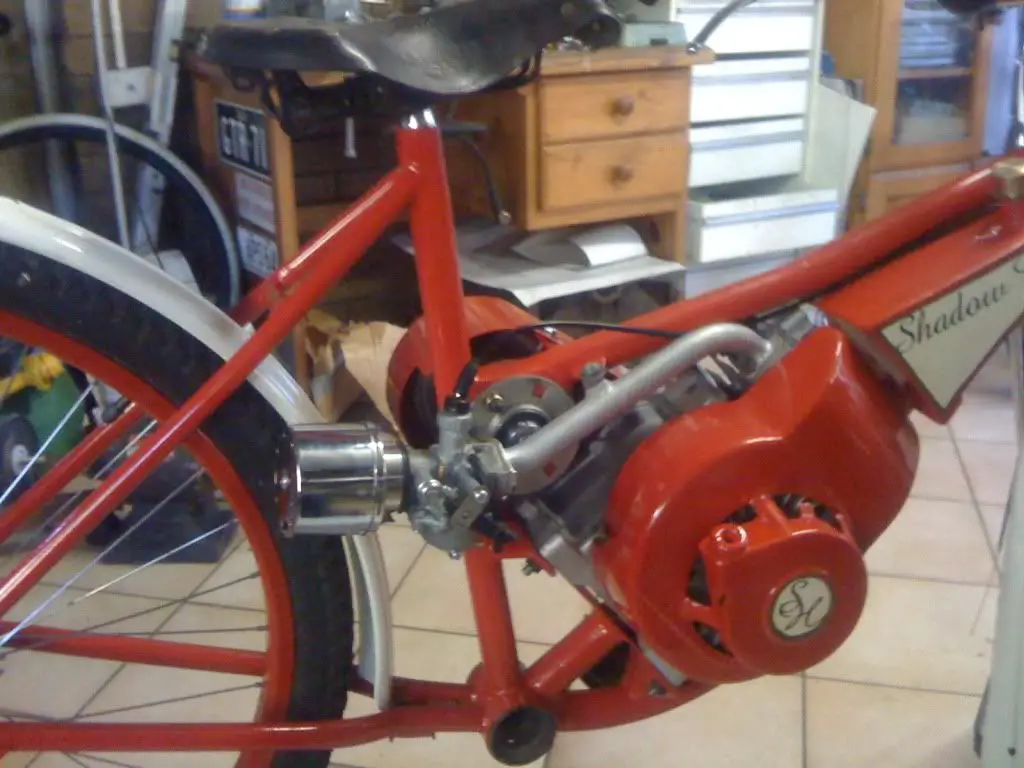

Msrfan, I may have already asked but i cant remember your answer. As i never pulled this motor apart, im not sure of the position of the oil slinger. So do you know or could advise me how much oil you think i need to put in this engine?..... dont worry i obviously wont blame you if it it blows up. Your advice is always greatly appreciated....
Hey harry. 600cc should do nicely.

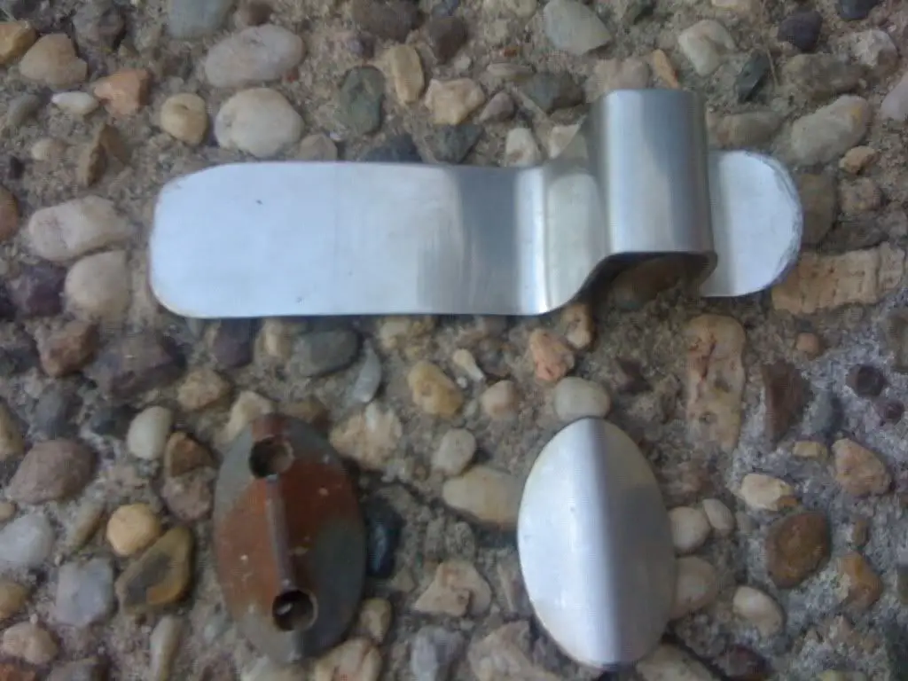

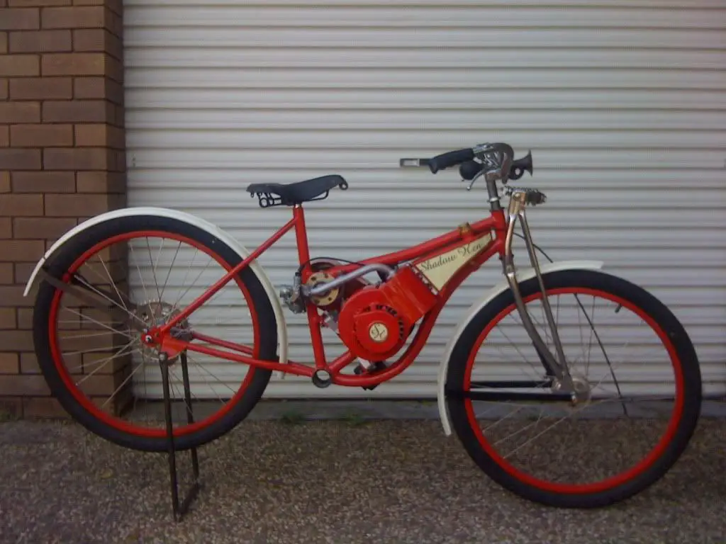

I havent had a chance to do much since ive been back at work, and a couple other things...... anyways hopefully i can finish my rear stand today, i need to make the support part that will rest under the frame. Ive still got a few finishing touches to complete.
I made a stainless steel rear stand catch for the rear guard, as well as replicating the rear guard brackets out of S/Steel
I also got a pretty cool little vintage style horn, i also need to buy a chainring and then i can put in my cranks and hook up a chain. I also need to run copper fuel line and then i can think about starting it....

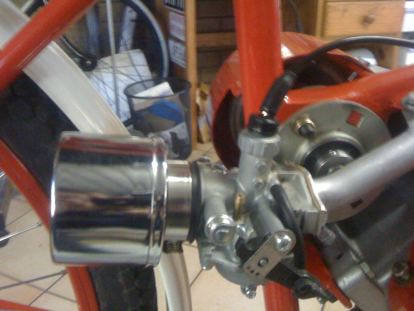

Hopefully not, a long manifold is meant to help with torque and bottom end i thnk, which will help make for a nicer riding bike. But is it too long? And what happens if its too long? I have no idea but i guess ill find out. I positioned the carby there because it is out of the way of the rider and that was my main aim..... if its not right ill just have to make a new manifold

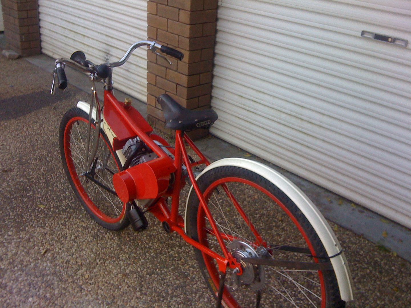

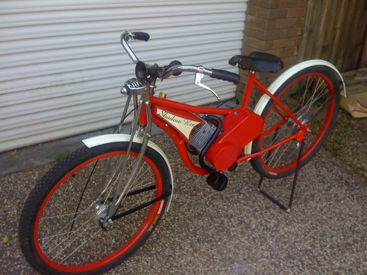

Harry, Finally took some time to see what you have been up to. Nice job! Neat clean look and a great paint job. I stuck with the satin black for now and may do a little lettering and small bit of striping, but right now just having fun riding and getting the bugs worked out. Congratulations on your project. Dan
WOW! what a beautiful job. I have been silently watching this from beginning to end and that is a nice looking machine. I hope your lady friend enjoys it.
I love how you left part of the down tube to mount the engine.
Harry, keep going, your doin it right I see! Neat!!!
The intake I have is with an elbow bend is going to go to an air intake that is quite long, the intake I see you have has a bend like a 45 degrees, mine has a 90 degree bend.
I can try once I have it ready to run try with and without the long intake to a higher on the frame point corrugated hose to keep away from off roading dust. Then I can see if there is much difference.
If this gives additional low end torque, I'll be real happy for hill climbing. I only have an 8.3 to 1 ratio gearing down.

Seems the length is not so much an issue, but I think if too tight bends could be a problem, but not like I see with what you have done, should be OK.

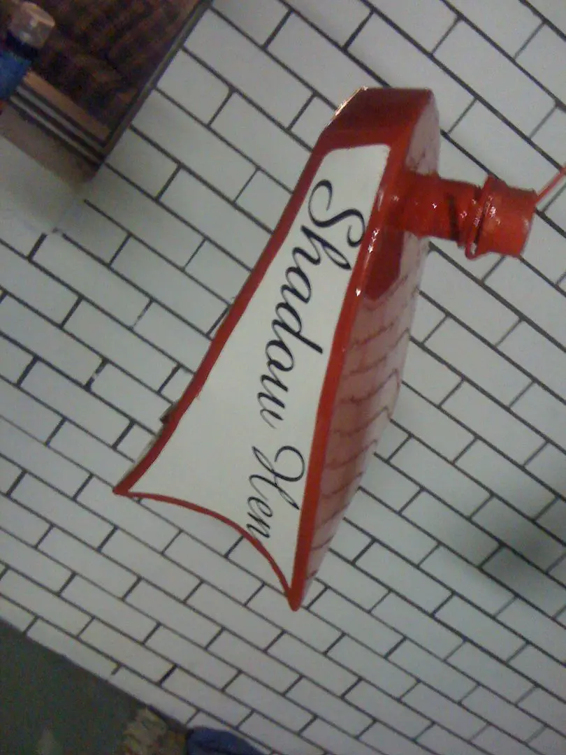

One thing i meant to ask was, and maybe you guys noticed but it seems that when i cleared the tank the white went a little yellow. I used Dulux color and Dulux clear coat and ive had this problem previously... im guessing ive used too much clear or maybe the coats were too thick (the guards didnt go yellow)?????? Could i repair it by maybe doing a very light sand on the clear, or i could just live with it. It is a tad yellow but its ok

Didn't notice it really. I think it looks great!
I did not have yellowing on my red painted over with clear, with the base being resorcinol glue cover for strength wood parts, but it was hazy.

Maybe if the color white paint and the clear coat are incompatible you could get yellowing, but if they are of the same type and brand they should be OK?
I used some varnish that had a yellow color once but not all the pieces of a wood oak bench have that happen. I think it was due to dew …. Moisture condensation over the night to morning hours and it cause that.

I just tried the zoom in on the tank and your right. Other thing I thought, can the metal underneath have any reason for it if it is a different make up than the fender material?
I can see your point now, but let me know what you find out and if the parts were painted at the same time, just trying to figure if anything I mentioned could be possibly the reason for the difference in color.

I think i put more, heavier coats on the tank then i did with the guards. So im guessing its that. Both the guards and tank were left to properly dry and i think i painted the white at the same time...... I painted a bike for my girlfriends daughter and the white on it went yellowish as well. And it was all dulux products as well

Yeah i just meant sanding (extremely fine grade sandpaper) the clear. Much like a color sand..... but most likely ill just learn to live with it and be more careful next time
I planned on making an air cleaner for it, but i still needed the rubber part. So i found an air cleaner off EBay meant for a Honda monkey minbike, and i dont mind it. Its vintage looking so i think itll stay as is
