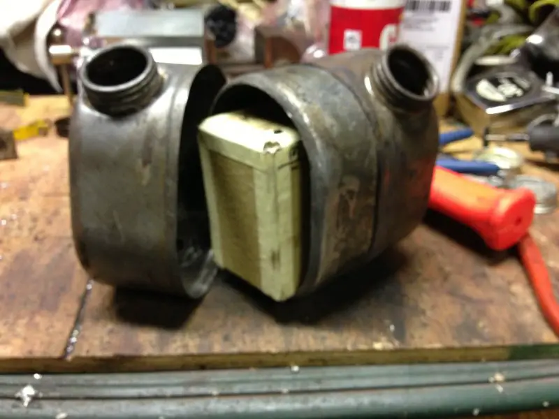

Worked on the AMF's battery box that I am making out of an old chain saw gas tank.
