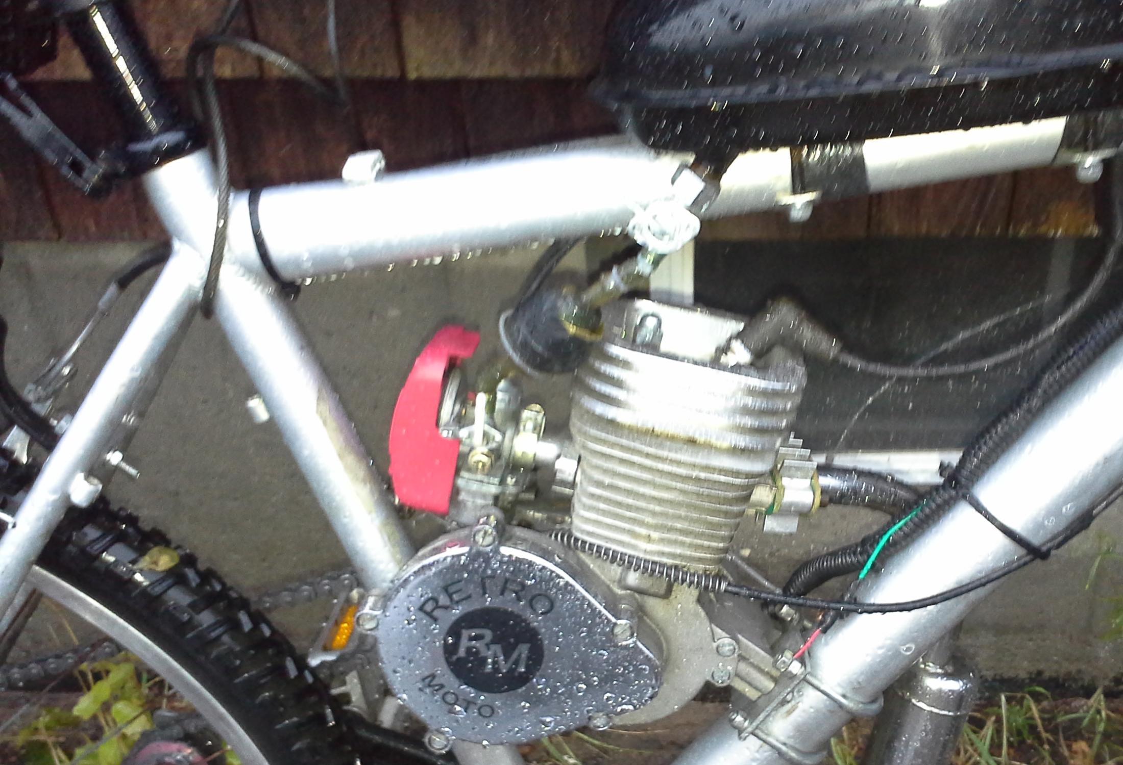

what are some of the best mods to do?
wb.jpgMy daily rider !!
Tops speed of 39.8 M.P.H. with 44 tooth sprocket & a 6'5" 295 LB 46 year old well driller on board!!
