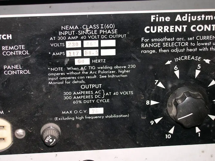

I use one machine for most everything. A lincoln TIG 300/300. From pop cans to plate, it will do anything I need. Makes a great stick arc machine too.
Of course it draws a bit more than 35 amps. In fact it would blow a 125 amp breaker in my old shop...
