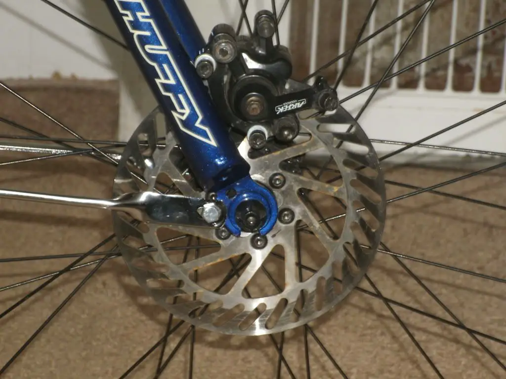

    I need to weld brake caliper mounts to the forks of a new Huffy cranbrook.
    [​IMG]
    The bike shop guy said welding destroys the heat treat on the bikes.

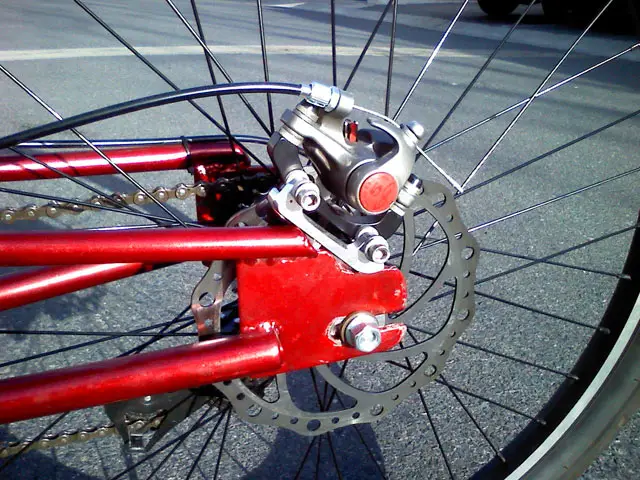

    Betcha it would be be easier and cheaper to just buy one of these. Disc Brake Bracket .
    Note: They only fit 180 mm rotors. ​
    I have on my springer forks and another on my rear axle. My stretch cruiser frame doesn't have standard axle brackets so I did have to do a little cutting on the frame but was no big deal.
