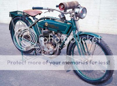

This is the style motorbike I'm thinking, 1913 Reading Standard

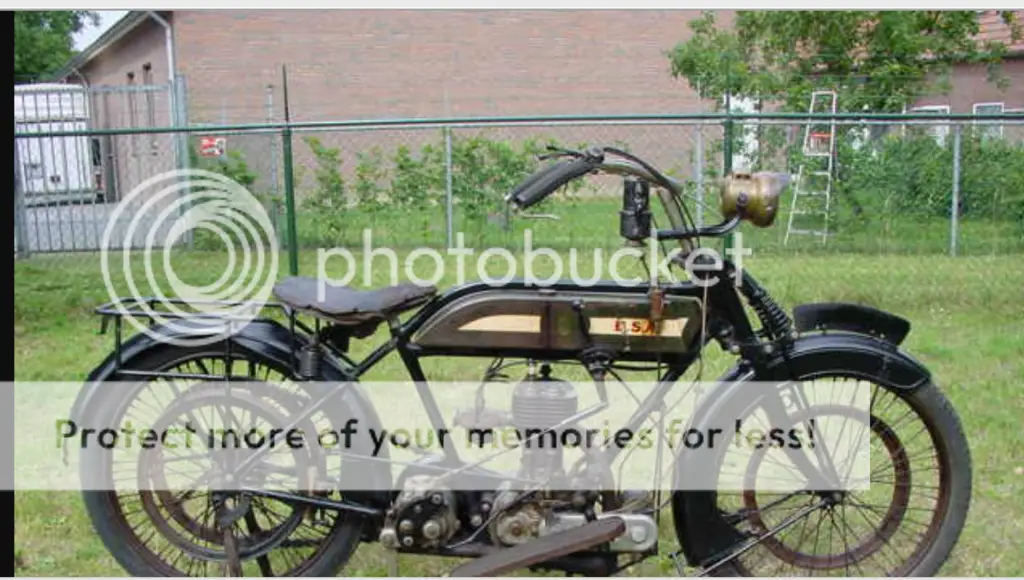

The 1919 BSA

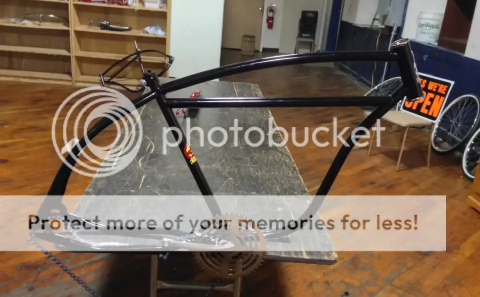

My Frame

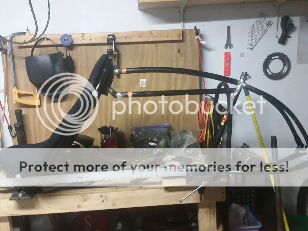

So as you can see I've decided to go a totally different way with this build, I was looking at the frame one night and had been over the Atomic Zombie site earlier in the day and this popped into my head... a fastback tadpole. I've got some 16" motorcycle rims on order for the front and a 19 for the back. I can't really get going on building this until I get the wheels all set ...and I will start a new thread in the proper forum. The seat is a KMX recumbent tadpole seat.

I really like the looks of this, and some of the plans I have from AZ use a dual pedal system.

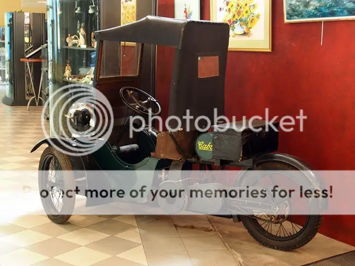

I'm seeing some great possibilities in the tri car. Rear clip from an old motorcycle mated to a frame to the front axle which could be either an old go kart or better still a golf cart front axle. Honda 90 front wheels with the bearings swapped out ( I have the bearing numbers if you need them for 3/4" spindles.) and a moped rear drum so you have the pedal and motor drive sprockets laced into a Honda rim.
The rest is pretty straight forward. Do you have a link for the photo?
