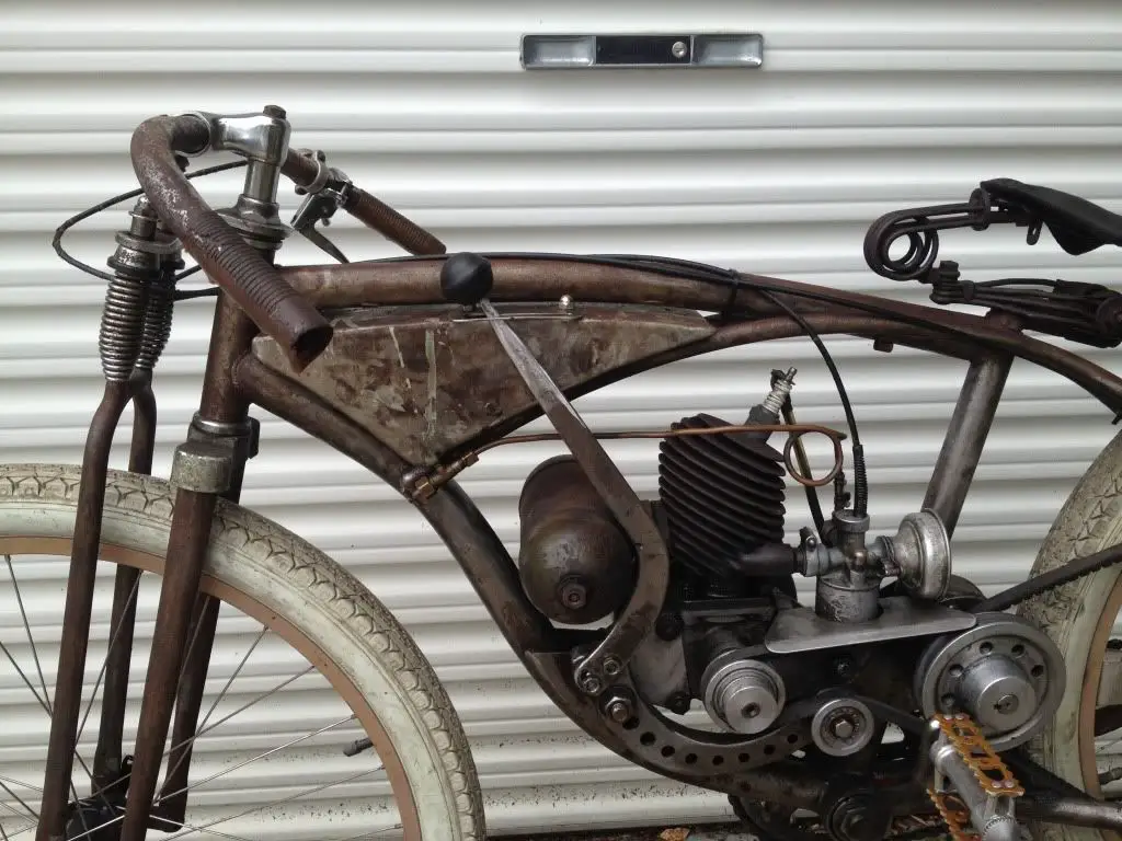

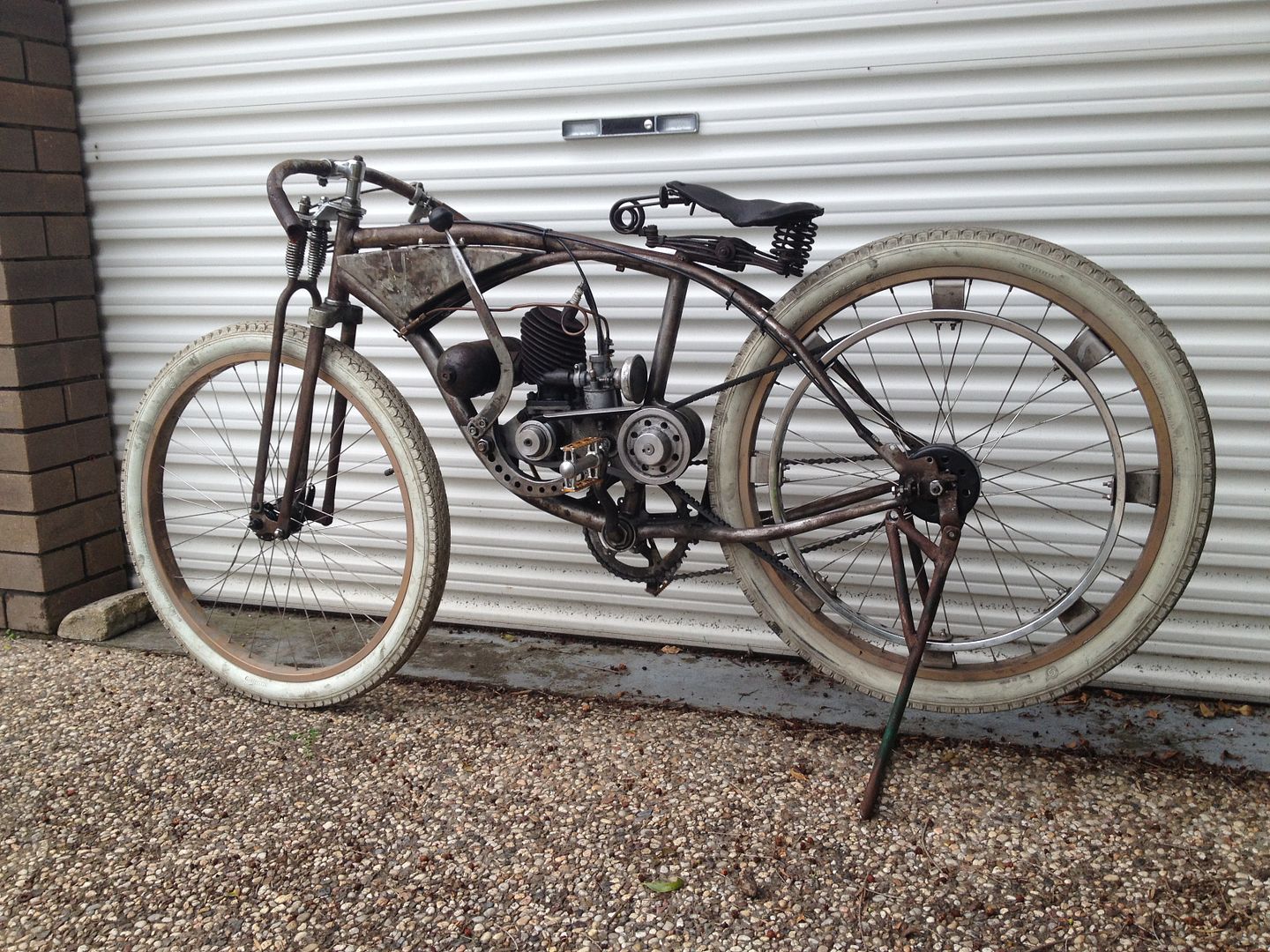

Im updating a few of the cosmetic things on my bike that are bothering me.

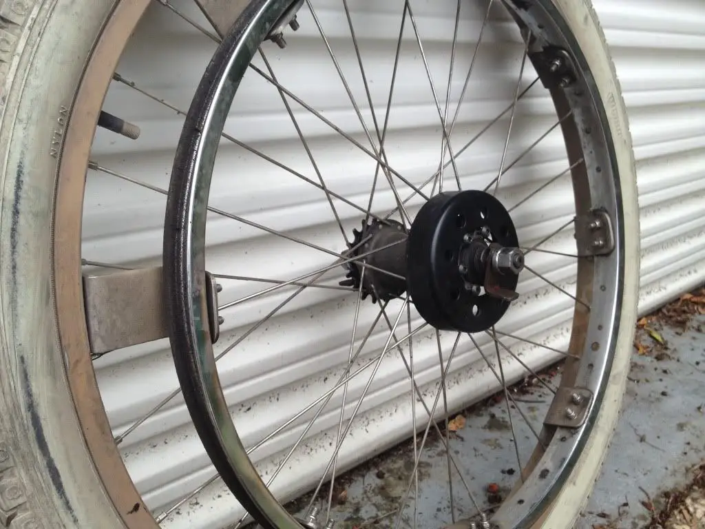

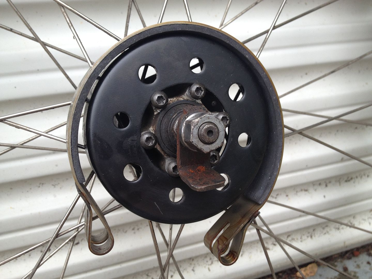

I received my bandbrake to replace my disc brake yesterday and trying to figure out the best way to mount it, ill have to make an adaptor plate and spacer.

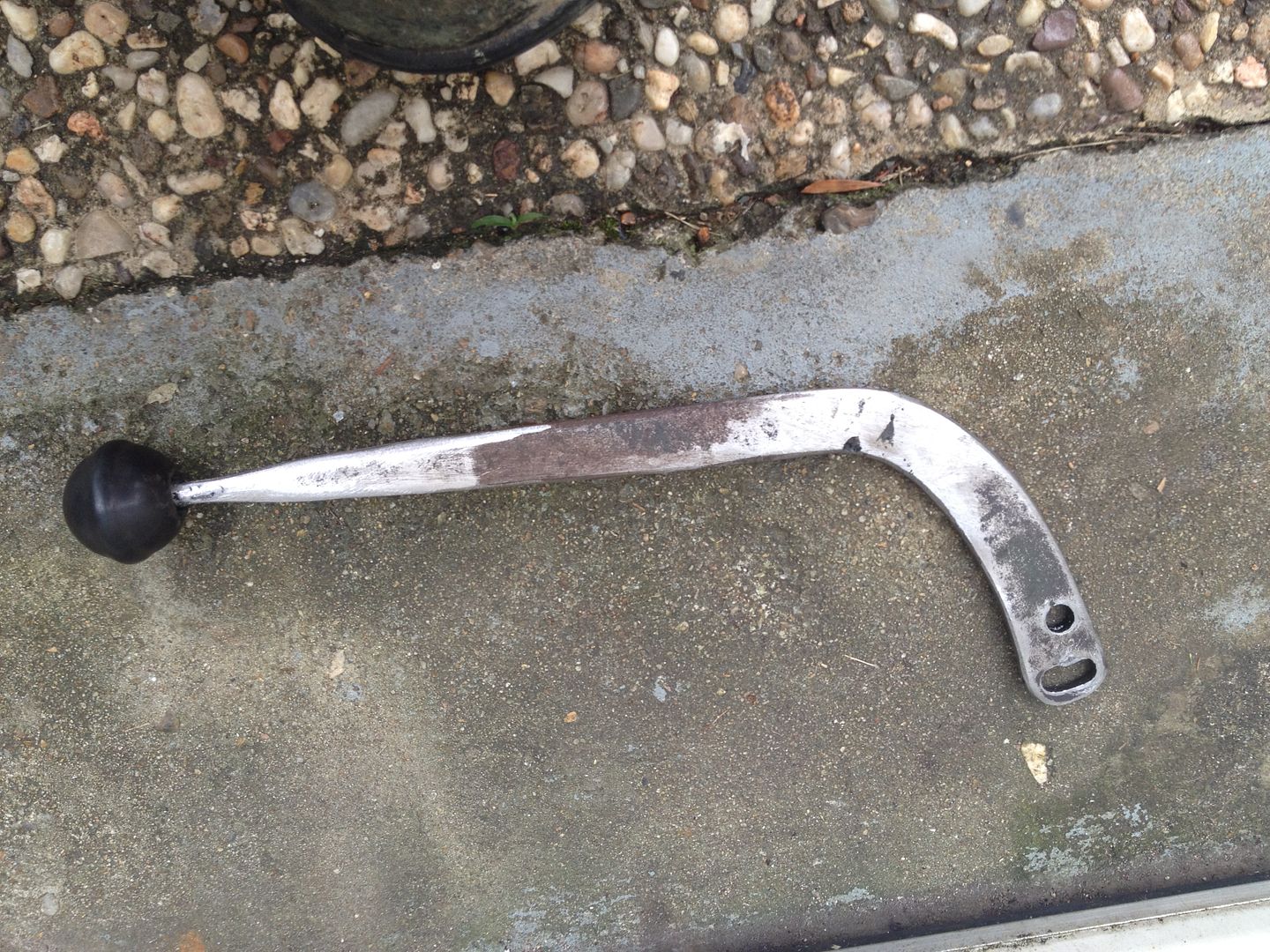

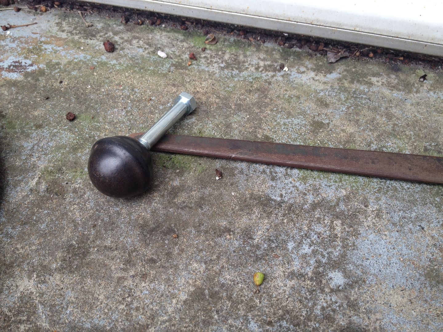

I found an old knob on an unused truck at work, i went and bought a bolt to suit an will fit it to the end of my hand shift lever.

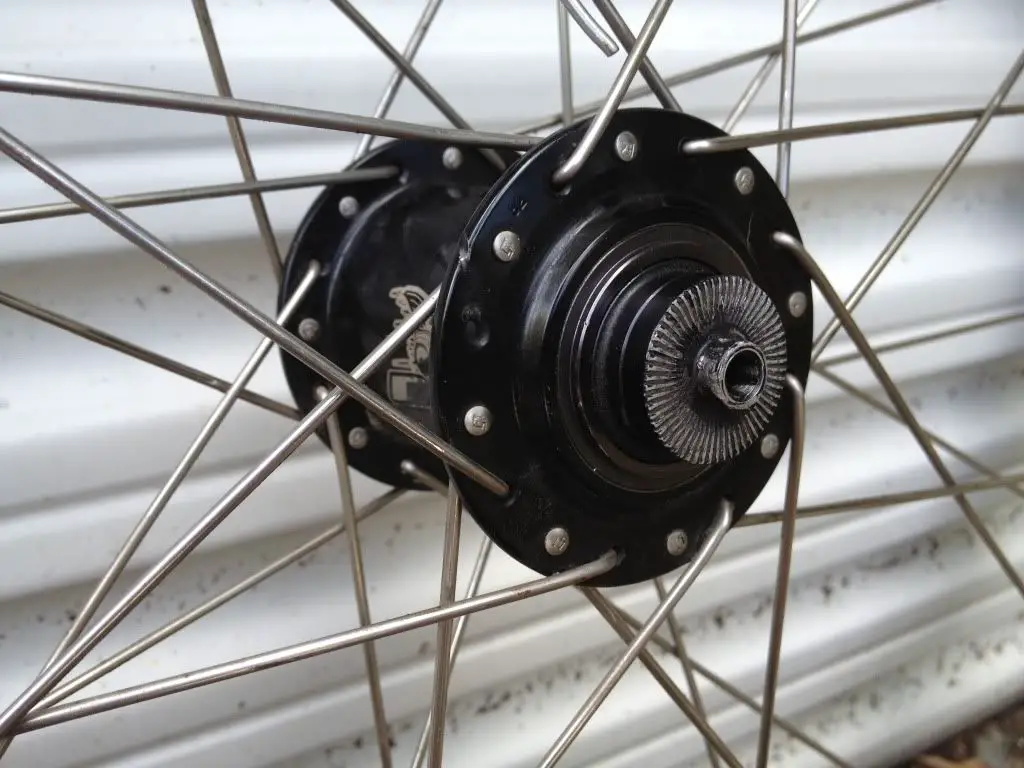

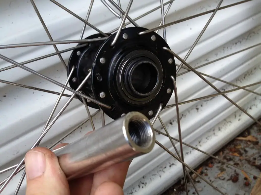

I also went to the bike shop today to get a spoke to replace the broken one and see if they had anything to make my front hub accept a solid axle. As its a modern disc brake hub it has a skewer which bothers me, i know i could replace the hub with a more vintage style but i dont wish to spend the extra money. The front hub is a unoversal one that accepts both mountainbike skewers and a 20mm thru axle.
So i went to the bike shop and asked if they had adaptors or knew of a way to make it accept a solid vintage style axle...... the bike mechanic said there was no way to do it. I then asked if i tapped the end pieces if that would work, he was quite rude and said there was no way to do it, he almost laughed at my suggestion and looked at me if i was from another planet. I explained my situation and said i realise it was an odd request but he still just gave me a dirty look and once again said it wont work!!!!!!!!
So i left and went to buy a tap from the local bolt shop, they didnt have one but ordered one for me, while im waiting for the tap, i thought i better see what you guys think, i think my idea will be fine but dont want to wreck my hub.

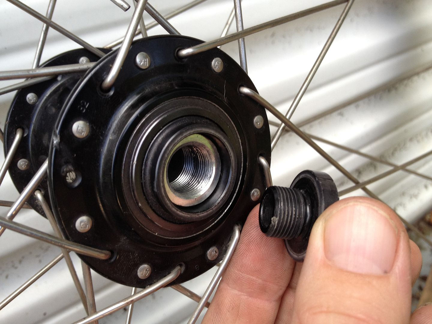

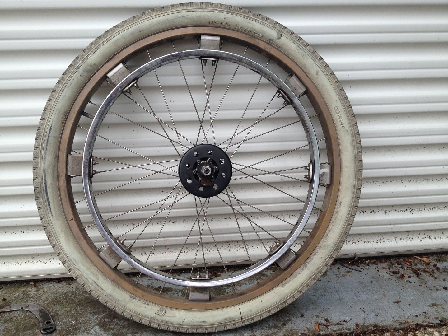

Here is the hub complete, you can see where the skewer goes through

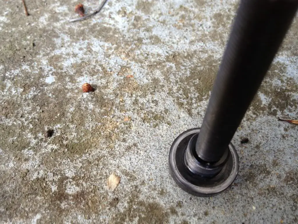

Here it is with the end adaptors unscrewed (these are the pieces i plan to tap a thread into), and you can see the adaptor piece inside

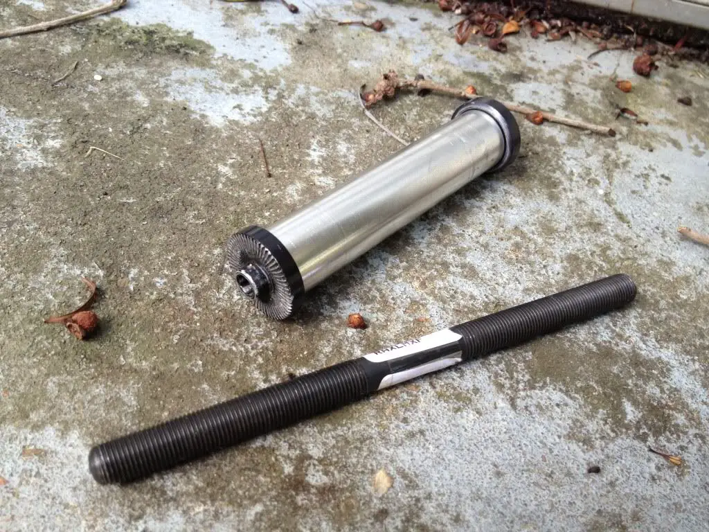

This is the middle adaptor piece, and you can now see how the hub is designed to take a 20mm thru axle

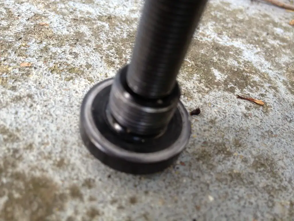

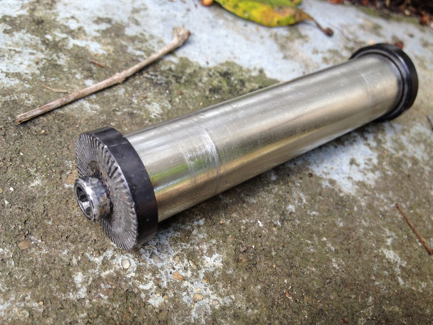

Adaptor piece and end pieces

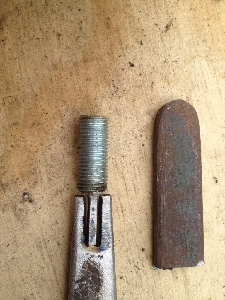

Adaptor piece and axle i had at home
So i

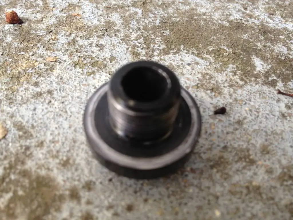

Heres a better view of the end cap
And a couple of pics of the end caps i want to tap a thread into to accept the axle
So i hope i explained what i wish to do ok, the bike shop mechanic didnt really wish to tell me why he didnt think it would work other then to just say "there is NO WAY to do it".
The way i see it my idea will not only work but will be stronger then what was there previously.... that axle will be stronger then that end piece of aluminium. And as im threading it the axle wont move, and it will be mounted very much the same as the skewer was...... thoughts anyone?????
Many 'mechanics' only know how to do repair by replacement jobs. So often they have no training at all in machining or fabrication...and some people just can't think outside the box. He probably just thinks your some kind of stupid know-nothing-bohunk. Make it work YOUR way, then take it back and wave it under his nose.
I agree with Goldy. Make sur you put the tap in a drill press turn it bay hand you will get a nice strieght start o it wont bind when you put the axel in........Curt

Gosh Harry, that's a nice hub!
Probably strong enough to support a small auto.
It seems the whole assembly is there just to adapt to a skewer design!
You should have no problem as long as you have a way to deal with side thrust.
I also agree. Great tip on holding the tap in a drill press to keep it straight. I've been doing that for years and it works really well. Your idea looks good. You're a natural fabficator.
I also use my lathe a lot same there put the tap in the drill chuck,good for small stuff.........Curt

Thanks Curtisfox, i hadnt thought of using my drill press by hand, i will do that for sure.
And Rustycase, i will be tapping the end pieces, and those end pieces screw into the adaptor piece so there will be no side movement, im guessing this is what the bike mechanic was concerned with. But the original skewer actually has nothing to stop side movement besides when the wheel is tightened up...... and yes you are correct that entire setup is there only to accomodate the skewer but is also meant for a 20mm thru axle that are used on downhill bikes.
I actually have another set of similar wheels so i will be repeating this process if i dont have any problems, and i cant forsee i will, but im not trained in any of this and when a "mechanic" tells you something wont work it can make you doubt yourself. I feel fine now you guys agree. Thanks guys!!!!!!

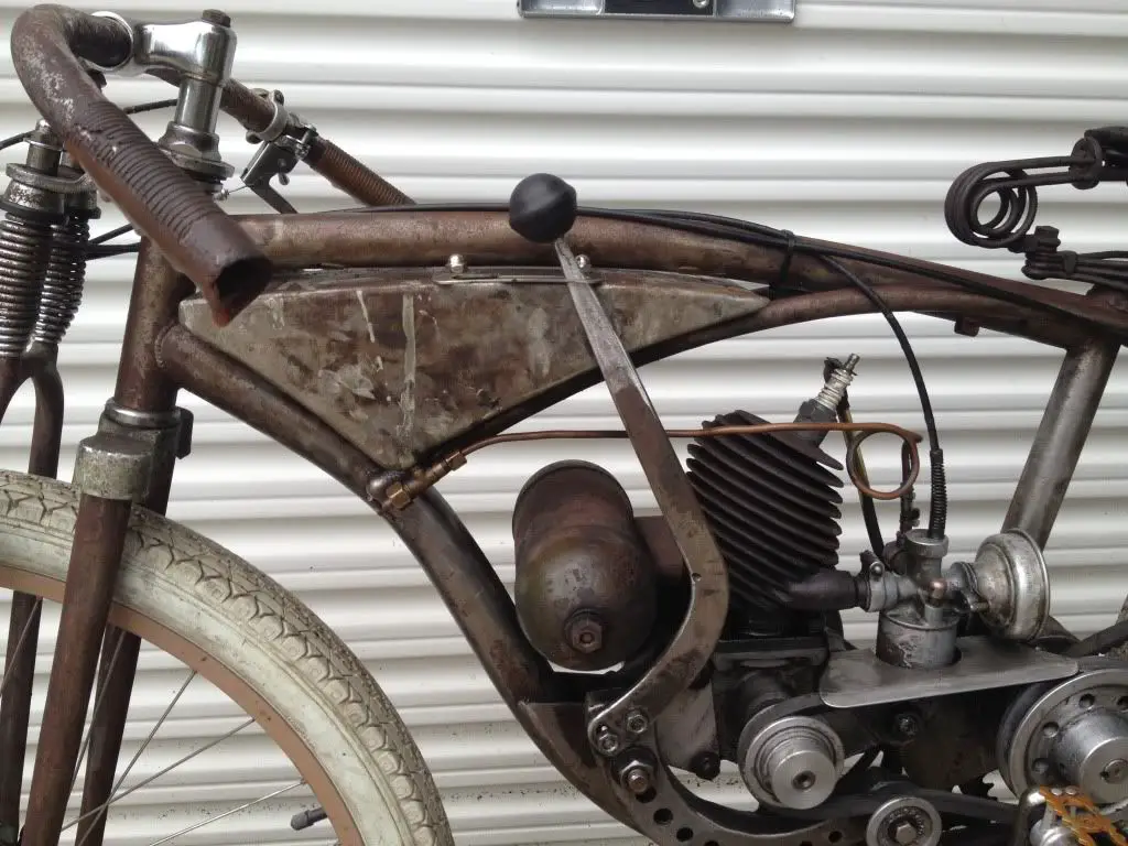

I welded on an old knob i rescued from an unused rusty old truck at work :-)..... im not sure how much i like it, but i think thats just because i removed some of my beloved rust, im sure in time it will look as good as it did.
Heres the band brake test fitted, i still need to cut out a spacer/adaptor plate and work out the best way of mounting it, as well as aging it substantially.
