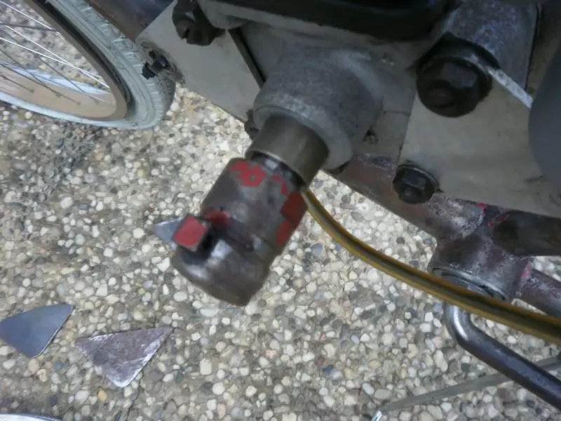

I'm having a bit of trouble getting the clutch off the crank, do you know how these fit on? I removed the nut that's on the end of the crank inside the clutch basket but can't get the actual basket off
Hi Atco, welcome to the forum, and good choice buying an Atco mower, im still on the lookout for them and just got outbid on another on EBay yesterday.
Im not sure which part you need removed, maybe pictures would help.... yours may be a little different to mine as mine only had an adaptor screwed to the crank that simply slid into the clutch. To remove this adaptor (not sure of the correct term) you may need to stick the flywheel in a big vice to stop it from spinning.
Either that or you may have a different clutch.... perhaps one of the ones that Camnz thought that other New Zealand builder uses on his Villiers bikes, that would be nice, id love to see pics
I was going to redo the atco on my tank, and put under it boardtrack edition,
The clutch should be on the taper on the crankshaft, should come off piece of cake with a set of pullers, don't advise hitting it with a hammer.
Cheers, Cam.
Hey Atco is this the thing you are tyring to remove? If so it should just unscrew, or do you mean you cannot get the clutch to disengage from this? Or do you have a different setup?
Forgive me, yeah harrys right those are screw off ones, and can be a real bugger to get off if they have rusted on!
