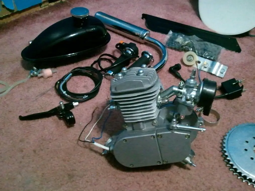

66cc Motor kit, also bought off craigslist. $80 brand new in box (from demonbikes, any feed back on these kits?)

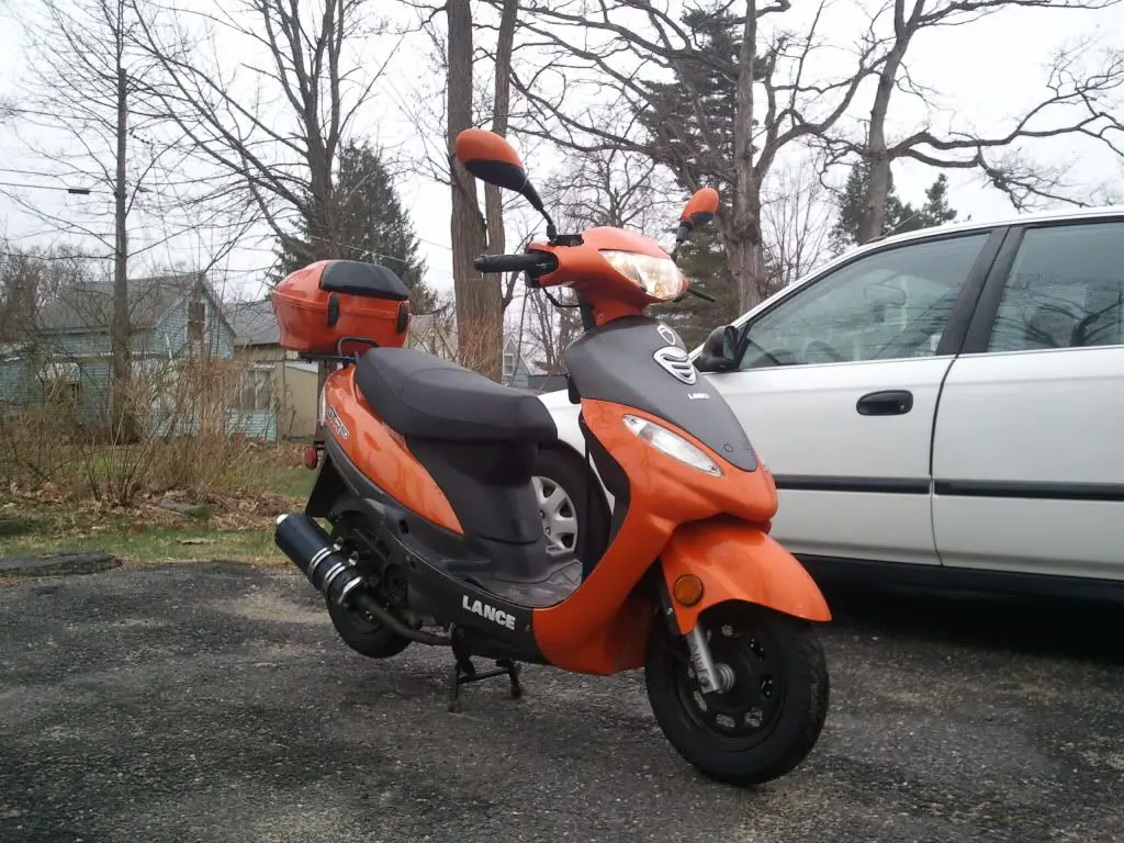

Oh and here's one of my other rides :)

I've been researching a lot so I can hopefully build it correctly. So far I've mounted the motor to see if it would fit the frame.. its a tight squeeze but ill be able to pull it off. The only real modification needed will be to reposition the carb to mount on the side. After mounting the engine I got carried away and ended up hooking up the throttle and cluth cables mounting the tank and just about everything else.

I kinda harp on this but a tap set is needed. The Chinese have a tendency to not tap the holes to the bottom. You also need a beam bar type of torque wrench for the head studs. I use a 3/8ths inch one. Don't trust Torque by ArmStrong. You can easily either pull the threads out of the block or snap the threads off in the block. Blue Locktite them in the block, some will JB Weld. I would JB Weld a stripped out stud hole if I had to but doing it from the start.... :p
Oh, yeah, Sick Bike Parts have replacement bolts and head studs. First mod I did to my bike :)

Throw the red Loctite in the trash. It has no business on a motorized bicycle. If you ever need to disassemble something the red will hold...the threads will not. This is especially true with steel fasteners in an aluminum case.
As DaveC suggested, buy a torque wrench and use it. Overtightening the fasteners is the single most common problem with first time builders. Use that torque wrench and avoid fastener/thread failure.

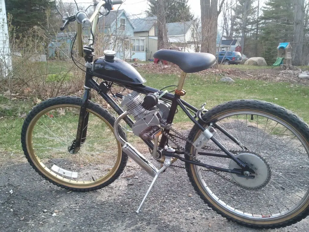

So I accomplished a lot of the things on my list today, put some gas in and got ready for the first ride... As soon as I got it rolling and dumped the clutch; the line snapped. Awesome.. So then I threw my new brake line on it and it actually pulled a lot easier. Then tried again for a bit and and wasn't getting any spark. Easy fix tho just wired the kill switch in wrong. So again I tried to get her running AND SHE WAS OFF! After a few carb adjustment it was running great. Cruised slow for a while and climbed 2 good sized hills. Then my cousin hoped on my moped and we went for a speed check on a nice strait by the house. Got it up to about 32 mps :) Called it a day after that. Here's a picture from today. More coming tomorrow and maybe a video..

Now that is a cool ride! Let us know if that Sting Ray feels erratic on the road at speed. I chose a Beach Cruiser for my first build. Pictures will follow.

Great looking bikem, I like the look of the bmx motored. You might want to move that tensioner to the bottom stay. Probabally take out a few links as well.

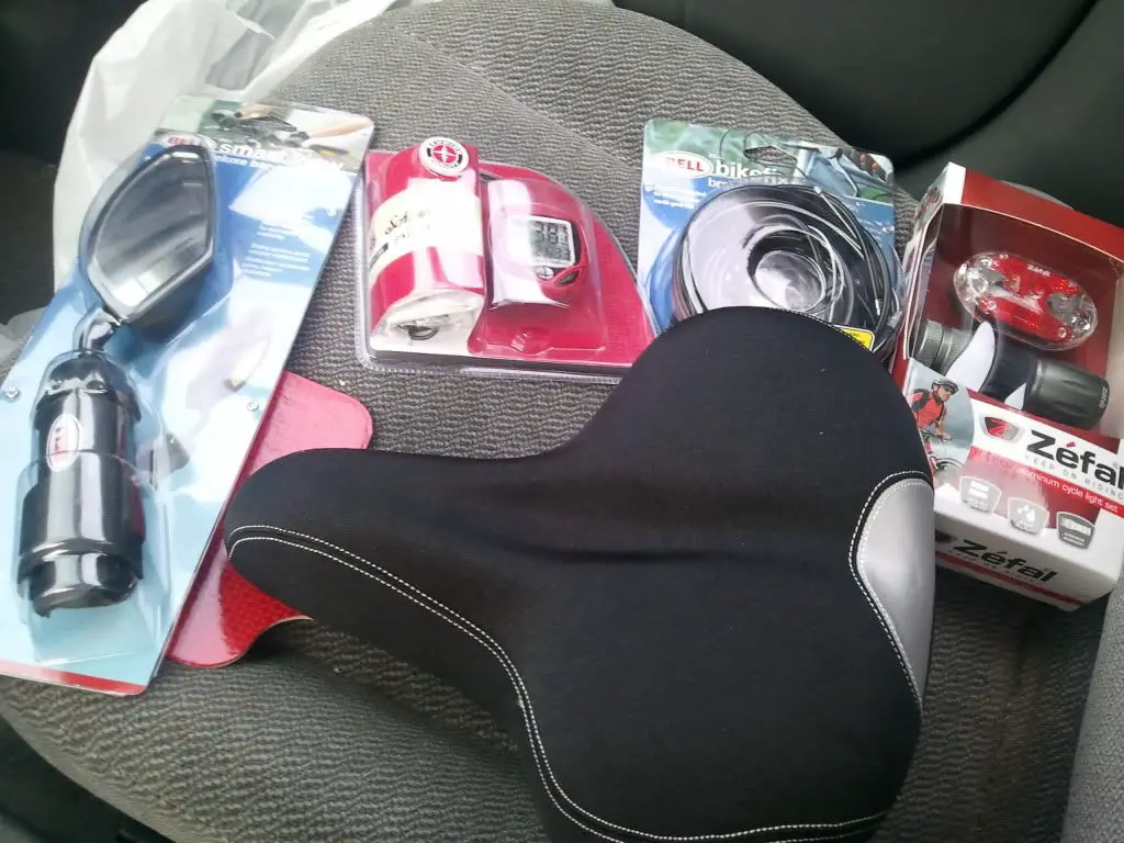

Sorry to tell you this, but the mirror you bought is junk. The velcro will not hold up to vibrations from the engine. Get a solid mount (all metal) mirror. Probably find those cheap on ebay too. The engine might cause interference to the speedo, you will need a choke core if that happens. I had 3 of the wally world speedos, had trouble with all 3. Didn't know at the time that interference was the problem. I went with an analog speedo and it works great.

also your right about the mirror butterbean. I used it for a day and couldn't see anything out of it lol. Then my bike tipped over and it snapped anyways lmao. As far as the speedo goes. I did a speed check with my moped and its accurate within 3mph which is good enough for me..

Yeah, that was the very first mirror I bought. it never worked good for me. My wallyworld speedo worked good at first too, but after awhile, it would reset itself every time I drove the bike. You can get a snap on choke core at radio shack for around 5 bucks. It snaps on to your spark plug wire and prevents it from throwing off interference. But its up to you. That was good thinking, buying another kit for spare parts.
