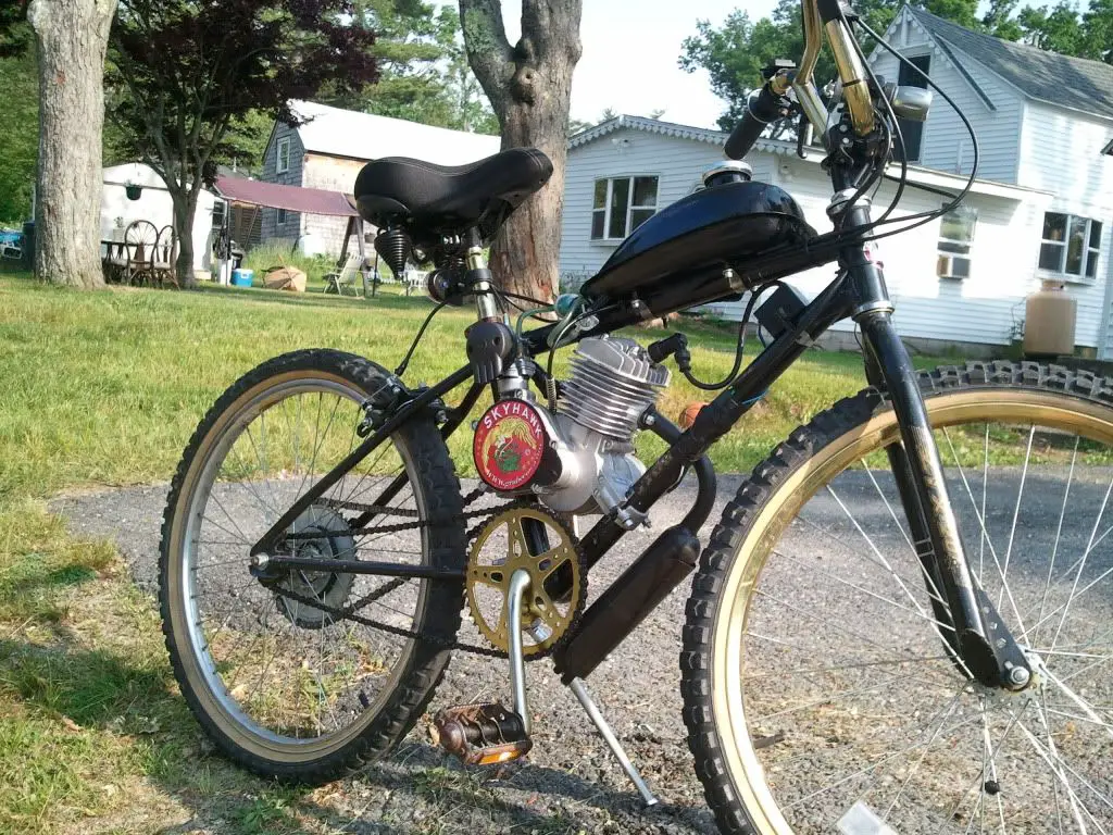

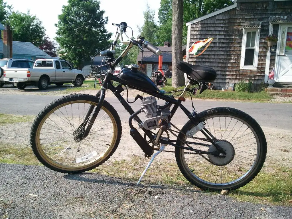

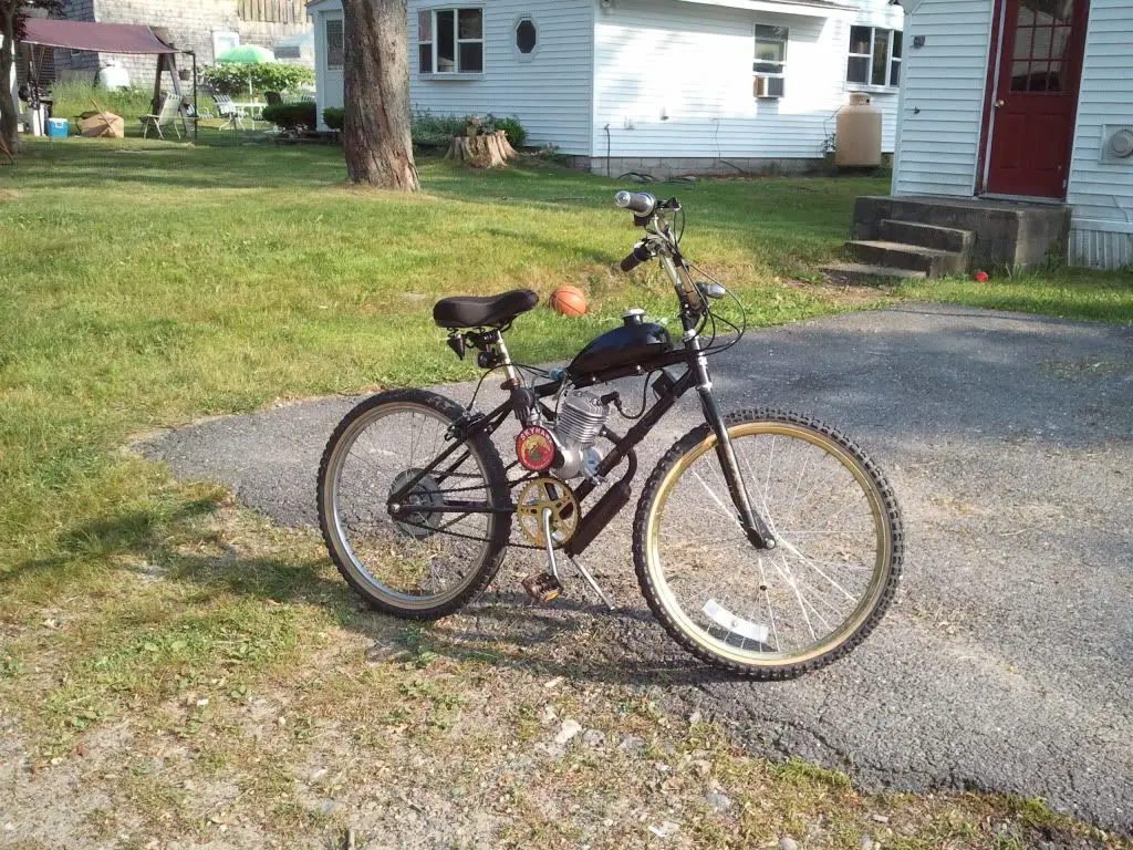

So I got my new engine in and running today. Used my old carb didn't wanna mess with the v2. Ended up riding it about 15 miles to work.. Ran great the whole way.. let's home the ride home goes as well. Here's a few pics.

I woud get another set of brakes on the front if i was you.....the extra weight and speed you'll need them.....
you can get a dual pull leaver to operate both at the same time...
