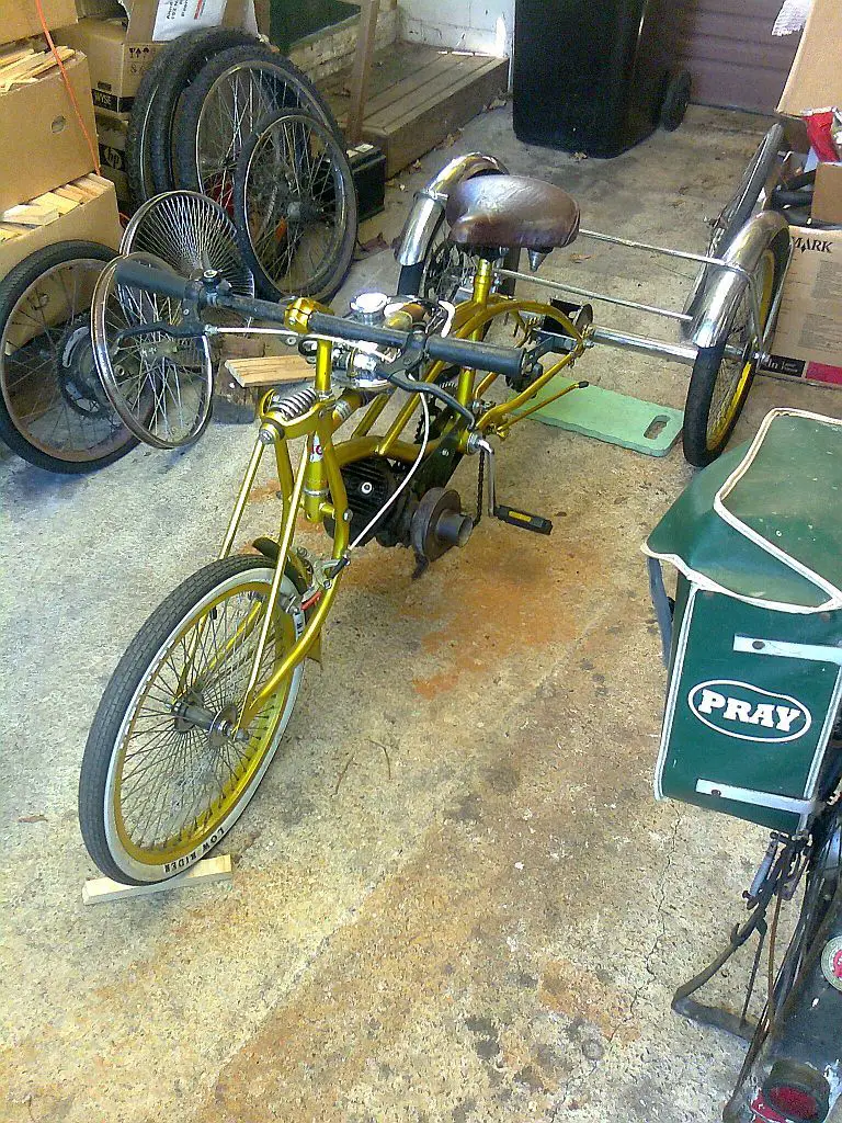

Finally - pictures!

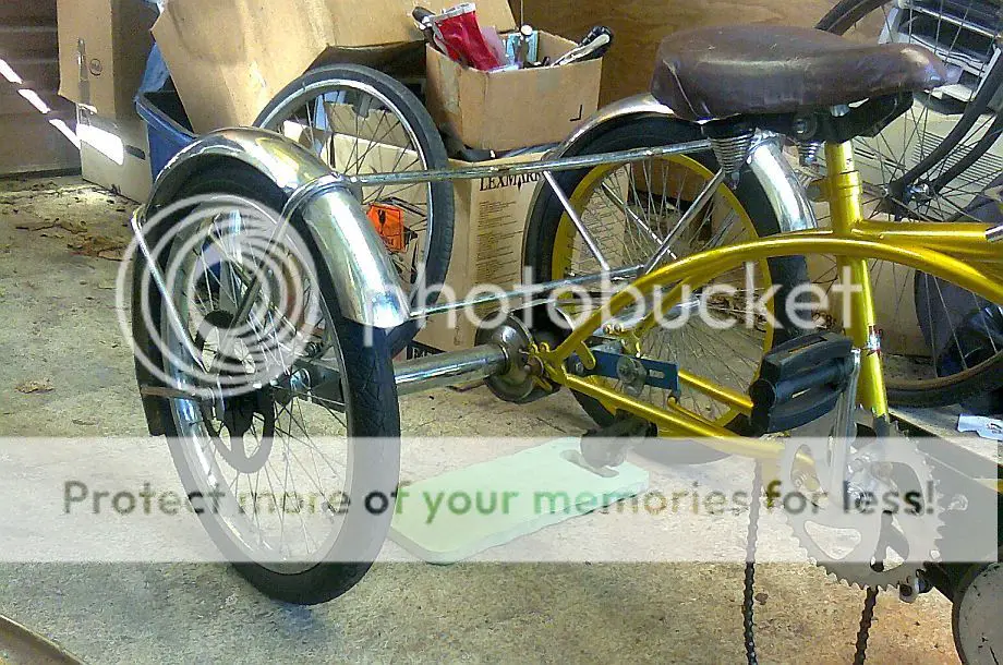

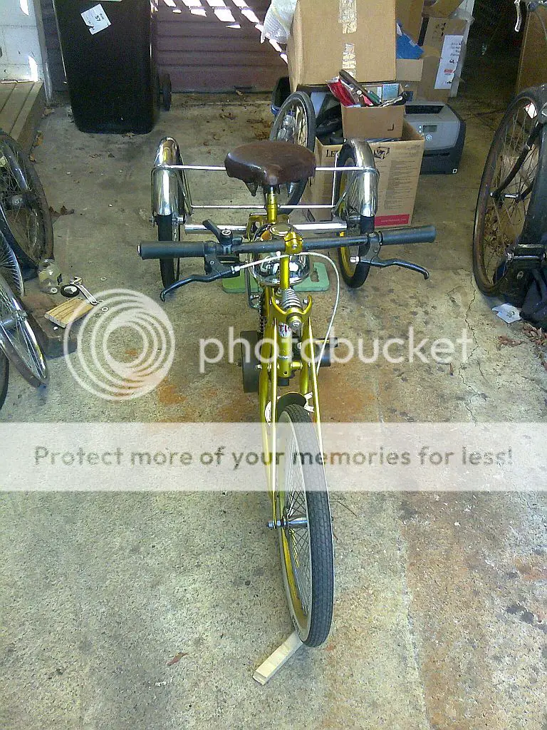

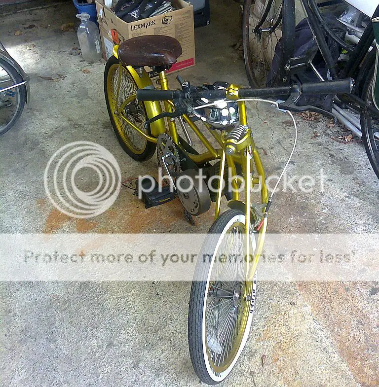

This is the starting point, my old Villiers lowrider project. The Villiers engine is going to be removed for duty elsewhere.

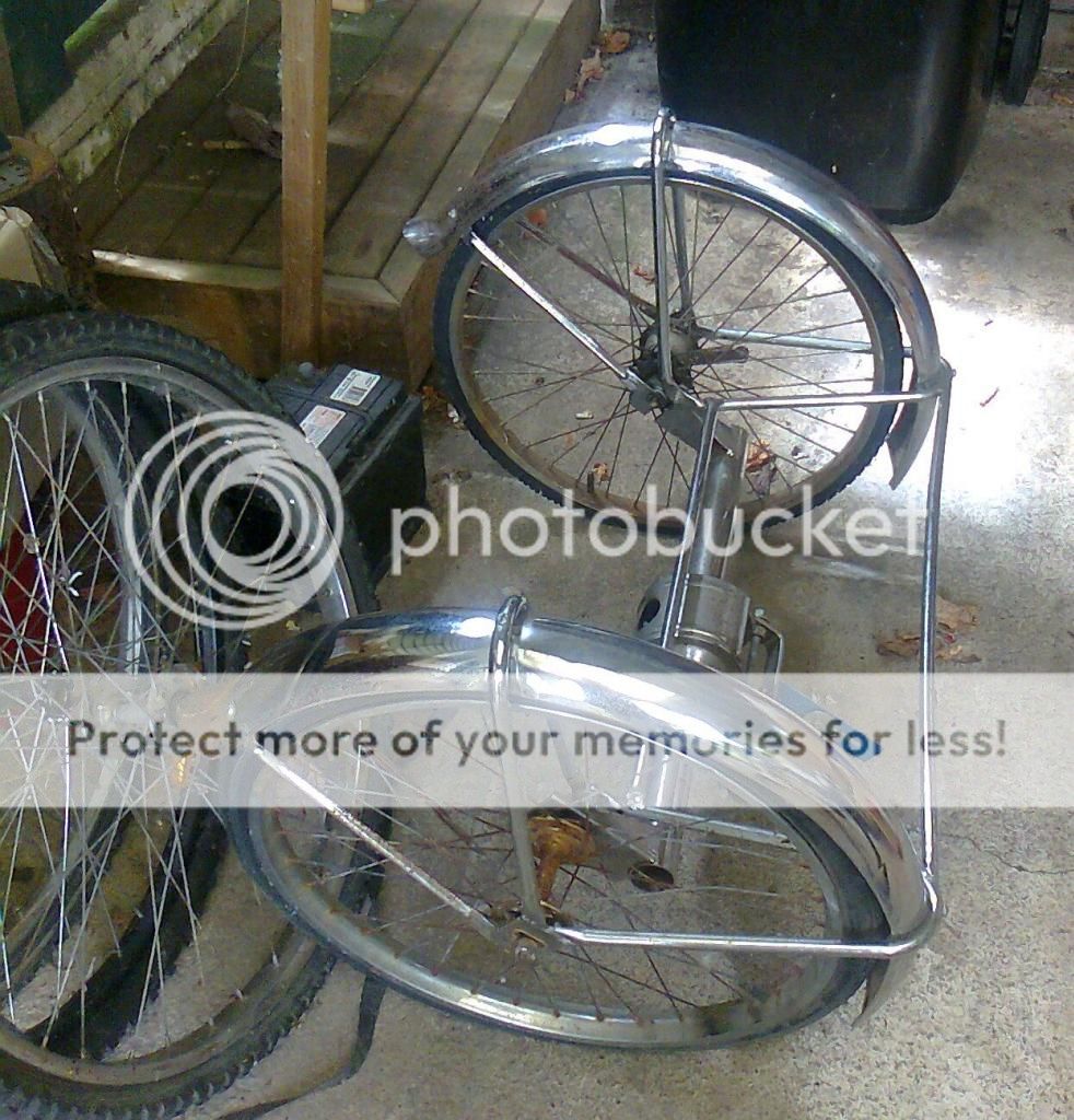

This is the trike axle I will be using. These are not the best trike axle on the market, but with additional bracing they can be made to work Ok.

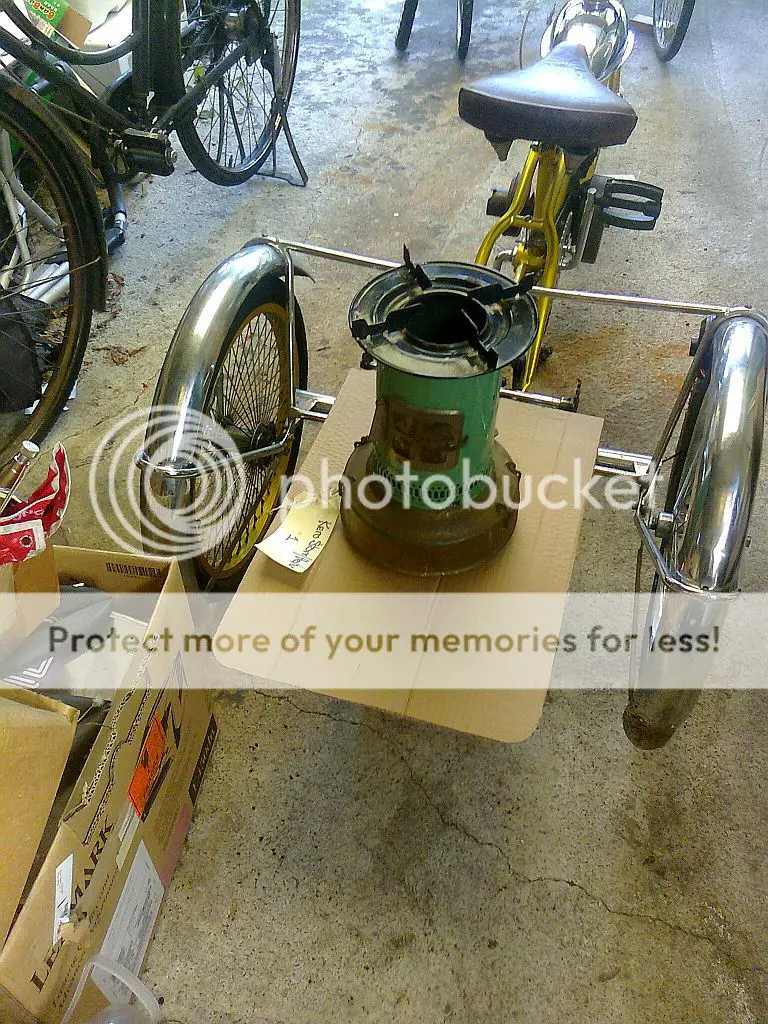

The trike assembled for mockup purposes.
Gratuitous shot of my faithful old Hercules trike.

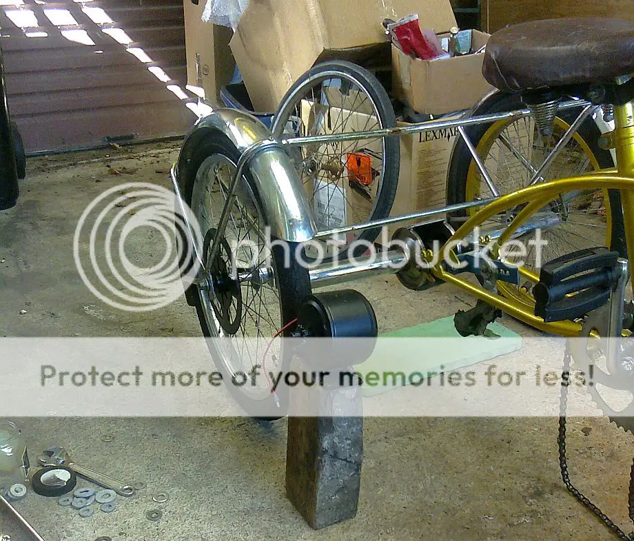

Drive sprocket mounted on rear wheel. I think the sprocket is for a Chinese scooter, - I'm not sure as I picked it up at a clearance sale.
24volt motor mocked up in position.
Basic quick mockup to show where Stirling engine will be positioned.

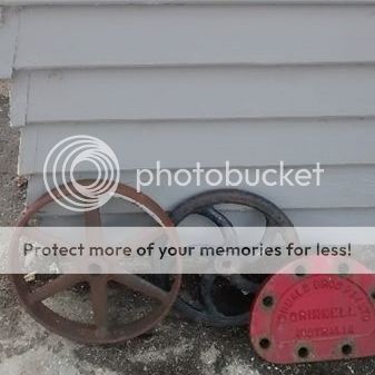

I did manage to buy the flywheel I wanted after beating off hordes of tendy airheads who wanted to put such valuable pieces of machinery in their gardens to rust away. Grrr snarl.....
The flywheel I will be using is the one on the left. It's just over a foot in diameter. The other pieces will be put away in my workshop for research purposes.
