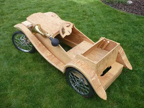

Magnificent wood-work there - pity that he didn't finished it for kids...

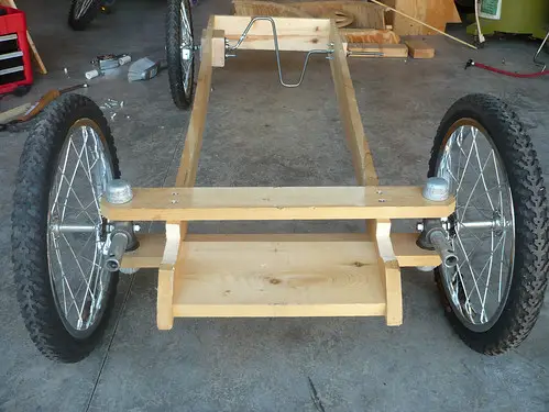

That is design of Stevenson Project, precisely of Pete Stevenson, my old Internet friend that passed-away a couple years ago. They still have plans for half-a-dozen of pedal-cars! On internet could be fined similar diary about building Stevenson's pedal-Bugatti!
Genial ideas that could be used for velocar? Interesting is their front "suspension" and steering. I asked a few times on similar forums, but no answer: could such system be used for adult vehicle with bigger and stronger components?

There is a little more to getting steering to work well at speed than I think this idea is capable of, but I love it.

I have the official plans for the Stevenson's MG pedalcar as I was going to settle into building pedalcars for fun and profit, only I got sick (again!) and it all came to a screaming halt.
The 'Intrepid' threewheeler is supposed to be a trial run exercise to see if I can manage to build car shaped objects in my own little workshop and this Summer that's exactly what I shall do. We're still in our early Spring monsoon season with heavy rain and thunderstorms which is annoying, but when Summer arrives we'll get the big dry which always makes the local dairy farmers' faces go all long and sad. Good bicycling weather though :D

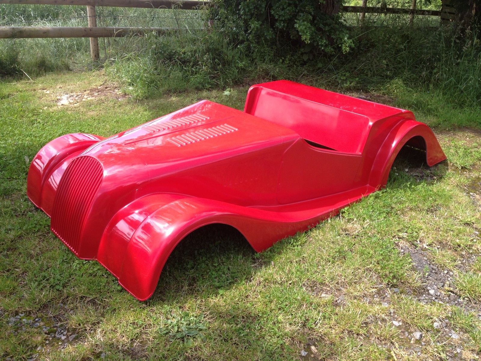

[FONT=Comic Sans MS, cursive]Hello Annie,
After a few nice days, we had now thunderstorm - Autumn is here after no-Summer period.
In spite looking nice, such body shouldn't be for my velocar (if ever built): too expensive - and, too nice for amateur build! Beside, I would prefer real Morgan, if not such Plus Eight then one 3-wheeler!
During my internet friendship with Pete Stevenson, we discussed building pedal-cars by their plans, in Serbia. He gave me permission for that (without any compensation for produced cars), but didn't believe that there could be any money for me. Production could be cheaper in Serbia, but final prices lower than in USA. Who knows: maybe possible business and pleasure? Or his Buffy-Person gravity racer (down-coaster car)? Maybe to cut all wooden parts for dozen of them and assemble one per month? As Richard done – some photos attached that illustrate his “serial production” for charity purposes!
