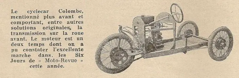

I found a photo of a Colombe cyclecar at speed yesterday which cheered me up no end. These little cyclecars were quite successful in competition, but apparently they were chain and sprocket eaters under racing conditions.

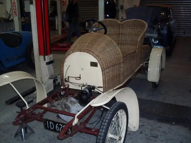

Yes wicker/basket weaving is still very much in my thoughts to use as a bodyshell building system. Could be good therapy for me too as I could quietly work away on it even if I'm not having a good day with this illness I live with.
The problem is of course to find a supplier for the raw material as last time I tried I came up empty.
