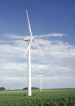

1500kW = 1.5MW
You sure about that slim? That's the same output as this windmill here. LOL

1500kW = 1.5MW
Oops, actually it should have been 1.5 kWh. Thinking in terms of watts is new to me. I usually only think about amps in my work.
