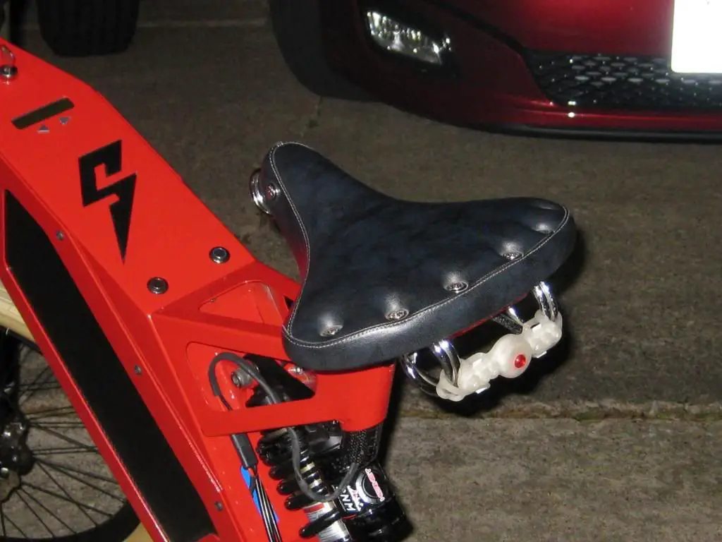

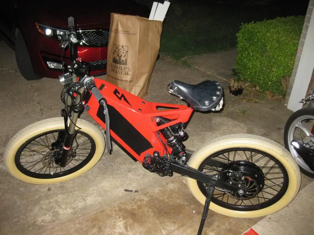

I made an executive decision today and changed my seat. I'm sorry, but I stole it off of Stunner. That's just tough tookies when you're number 2. I've always liked this seat. I don't think you can buy them. You have to buy a Felt Deep 6 to get one.
I think it works with the look I've got going on here. The chrome buttons. Hide of a Naga. Tractor seat shape. I've never been a huge fan of the hairpin look, but this seat doesn't show it off as much as some. It also seems to sit a little lower then the old one, so I like that too.

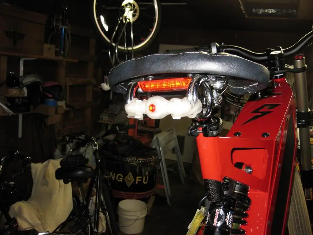

Here's a better view of my hardwired taillight, and my bicycle taillight back up. You can also see that I raised the fork tubes in the clamps.

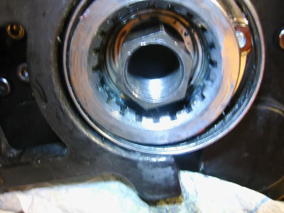

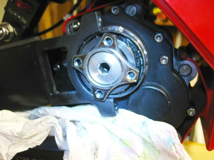

My bike suffered it's first major failure at 3000 miles. One of my swing arm bearings failed, and lost it's balls. I'm thinking it may have failed a 1000 miles ago, but it took me this long to notice, because normally it's hidden behind the pedal sprocket.
I accidentally discovered the problem when I was changing my tires. What tipped me off was when I got the bike off the ground I noticed my chain was too loose. Before I got it off the ground, it was too tight.
I did some research about how to repair the problem, and found a warning not to move the transmission output shaft when the part that holds the sprocket is removed, or parts inside the transmission case will come apart, and you have to disassemble the transmission to put them back together.
I made discovery of the failure on a Friday night. Since my bike is still in warranty I sent an email to Stealth explaining the problem, but I sent it the wrong department. I didn't get a reply till the following Tuesday that said my email was being forwarded to the correct department. The next day I received a reply from the warranty repair department asking for information about the failure.
By then it didn't matter anymore because I had already located new bearings locally, and made repair on Tuesday. Total cost for 2 bearings was $36, and I was able to just walk in and buy them. Now my bike is as good as new, and back on the road again.
I was surprised this bearing even failed in the first place, because it's not terribly stressed for a bearing this size. I'm pretty sure it was a Chinese manufacturing defect, and not caused by excessive wear and tear.

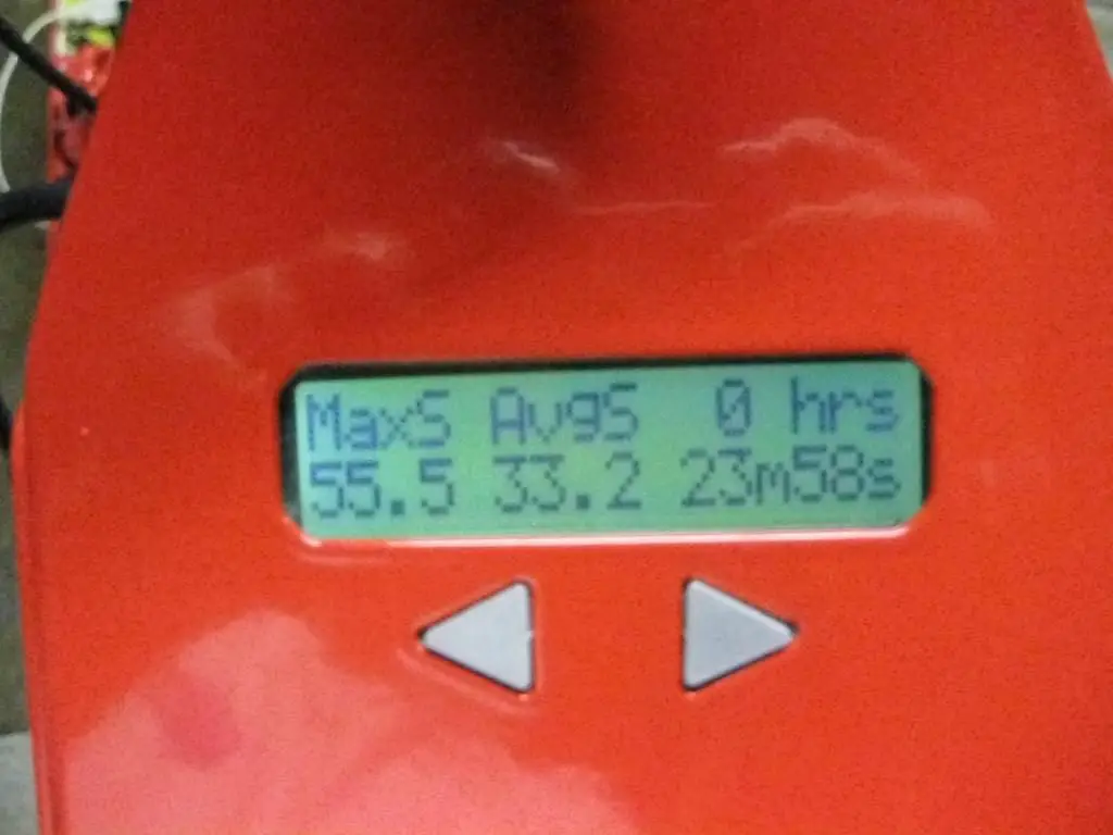

I don't think there's much more speed left in it, and I'm not really interested in trying to find any either. To tell the truth I wasn't trying to top it out when I hit this new record speed.
Now that I have a second charger at school I can ride both ways on a full charge, so I don't have to hold back. It's only 13 miles each way. That being the case I don't pay that much attention to the CA on this commute, and it's not in a line of sight position that makes it very easy to see when I'm going fast anyway. I just check the statistics when I put it on the charger. There is of course some up, and downhill grades on the route I take, so it's highly possible this speed was recorded on a downhill.
Have you guys noticed this on your bikes? I've observed that downhill doesn't improve the top speed very much on this bike. I've had it over 53 mph on level ground, so 55.5 isn't much of an improvement if it was on a downhill.
I've noticed that this bike goes whatever speed the throttle is set at. It's not like a regular ice motor where the speed varies depending on grade, with a constant throttle setting. This bikes runs like an electro magnetic force holds the speed constant to the throttle setting regardless of the grade, even downhill. Of course it varies a little bit, but not very much.
