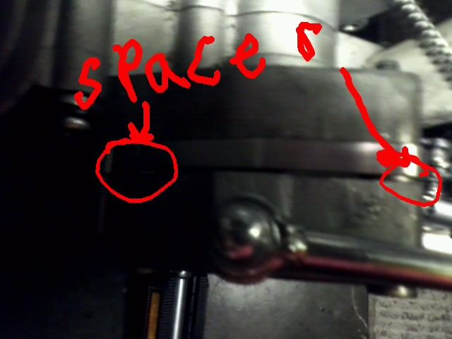

This chain tensioner?
The KIP tensioner adds a quarter inch to the space between the clutch cover and the motor. So you get longer screws and a longer engagement pin. BUT the pin is ever so slightly too long so that the plate (when screwed down all the way) pushes the pin into the motor. I don't know if that's what the process is but the result is that the back wheel spins like I'm pulling the clutch in UNlESS I loosen the clutch screws. These are the washers.
AHAH! it's the disengager shaft. The Clutch cover forces it in.
OK, Now I get it. And what I've found is not all bucking bars are the same. I've had to shorten them or make my own, longer, a lot. Take your bar to a hardware store and get a long, mostly smooth shank grade 8 bolt the same diameter. This is to insure you have more bucking bar stock in case something goes wrong. Then use the bolt (or the bar) and cut it,(or grind it,) to the length you need. The different factory's in china, about 10 of them, are supposed to make these things to a certain spec, But with chinese quality control every factory makes them a little different. You'll find a LOT of times you can't just take a bucking bar from one engine and put it in another, too mant different lengths.
When it's the proper length, take a very fine file and round the edges(just a little,) and smooth it up. Apply a lot of grease(on the bucking bar and the flat part of the clutch lever,) and install it. A PITA but I promise this will work. I've done it a lot.
fatdaddy.
P.S. The "Disengager Shaft" is called a bucking bar. And Get rid of the washers(spacers) first.

Dude, The bar is too long already. And just HOW do you add length to a peice of metal anyway? Sending it back would take WEEKS. All he has to do is spend an hour fixing it and he'll be riding in an hour and 2 minutes.
Let the brother build his bike his way. And please read the post just a little closer. The bucking bar is plainly too long, not too short.

I'm really enjoying this and the only thing I could add would be that a new pin (bucking bar) can be made from a 5/16" drill bit. Harder metal than a bolt and if you want to decrease the pull of your clutch you can round off and polish the ends of the pin and the contacting surface of the cam in the clutch actuating cover, then lubricate the parts before reassembly.
The length of the pin (bucking bar) is critical for proper clutch operation. Be careful with how much material you remove if the pin is too long. A few thousands of an inch will seriously effect the amount of travel needed to disengage the clutch.

I just looked at the ebay add instead of the pic of your install.. The thing is supposed to go on the OUTSIDE of the case, not in between the case and the engine. If you did it the way it is meant to go on you wouldn't be having problems with the bucking bar.
fatdaddy.
P.S. Or maybe not. It doesn't show a clutch case at all in the ebay pic. So I would try what I suggested, shorten the bucking bar. And 2door is right. A little goes a long way.
P.S.S. And I looked a third time. I was right the first time. The thing goes on the OUTSIDE.
Look closely at the pic.http://www.ebay.com/itm/motorized-b...Cycling_Parts_Accessories&hash=item35c1166991
I wish I would have looked closer at the tensioner before I went into all the "not so good advice" I gave. I assumed it was a frame mounted tensioner, not an engine mounted one. I apologize for that.
Of course the bucking bar wont work right, The bucking bar is blocked by the tensioner plate, and NO WAY could engage the clutch lever. Cutting down the bucking bar WILL NOT WORK. This tensioner is supposed to be installed on the outside of the clutch cover using the longer bolts or screws supplied. I think you said they supplied another bucking bar. I don't know why they would give you another bucking bar because the plate is not designed to interfere with it at all when installed properly, on the OUTSIDE of the engine. You should be able to use the one you have.
Again, I'm very sorry for not paying closer attention. But please, TRY IT ON THE OUTSIDE OF THE CASE as shown in the pic.
If you've already cut down the bucking bar I will send you another one, on me.

lol I bought the KIP tensioner. It definetely goes between the plate and engine.

The pic in post#1 is where my confusion started. The Pirate Cycle Kip tensioner does have a hole for the bucking bar. So my First advice was right, and I should quit second guessing myself. I should also read the threads more closely then I did in this case. As soon as you get the bucking bar lenght straightend out you'll be good to go.
Anyway, If you want to just use your old stock tensioner you can make your own frame mount spring tensioner, that all they did and want to charge good money for it. Use HEAVY steel and get yourself a heavy duty spring and yer almost done. But I think you already have a good tensioner. Like I said, figure out the bucking bar and it'll be fine.
I still think you should get rid of the spacers before you fix the bucking bar. The case is meant to fit flat to keep a little water and crap out.
