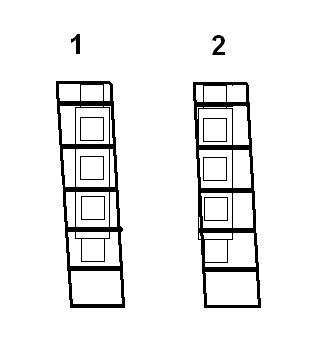

Cool, but if you look directly down the bike frame, is your motor mounted exactly in the center, or is it leaning ever slightly to the left to accept the chain better? My motor is exactly dead nuts in the center but someone suggested loosening the mounts and positioning it so it leans slightly left to stop the chain popping noise.
I like the way it's mounted nice and square, but maybe I could grind the outside edges of the teeth in the small drive sprocket? Do I have to take the sprocket off to do that? Or can I just dremel grind the teeth making sure not to get shavings into the motor, etc?
That pop sound is likely the edge of a tooth snagging the chain and pulling it up until it gets tight, at which point it "pops" off the tooth and back down. If you grind the teeth to be more rounded, it may or may not get rid of the sound. Having the front to rear alignment perfect helps with this. I know mine has just a barely noticeable tilt to the left (mount is a little crooked) and my chain has always fed fine.
I do have a theory of why a left-tilted engine may make the popping sound stop. If the engine is leaning left, the sprocket leans down toward the rear sprocket, causing the chain to fall the furthest it can outward. If your rear sprocket sits further to the right than the engine sprocket, the chain will want to curve inward from the engine sprocket to the rear sprocket. Because the chain is already sitting further out on the front sprocket, there's spare room for the left side of the chain to clear the teeth without touching the sprocket and bending the links.
#1 would be my leaning engine theory. Engine sprocket, viewed from above. Sorry for terrible MS paint quality.
Thanks! Yeah, I've tried some alignment things and it seems pretty good, but I might have to resort to grinding the teeth. Do I remove the engine sprocket first, or just have at it after removing the chain?
That diagram is perfect. That's what I think this other guy in Lexington had just learned through experience but you've shown the reason why. Thanks.
I would personally remove the sprocket to do it, that way you have more room to work, and there's less chance of getting metal shavings / dust into grease or bearings. If you take the sprocket off, you can spray it down with brake cleaner before reinstalling it.
