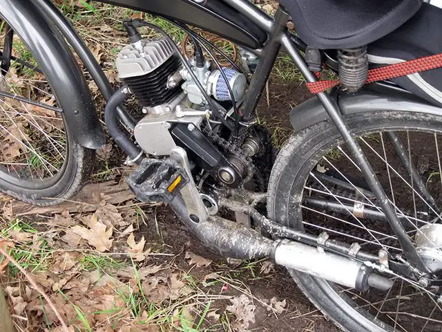

It's a modified SBP expansion chamber, ported stock headpipe & extended glasspack silencer. While the spring retention system on the SBP manifold is great and reduces metal fatigue - I couldn't bear to have the blue hi-temp silicone on my vintage ride... it just kinda clashed and Ima slave to fashion I guess. The extended glasspack quiets the exhaust to roughly equivalent to stock (sounds different/better - but no louder) and other than being 6" or so longer has little/no effect on backpressure as it's a clear passage straight through.
It's a pretty easy mod (glasspack) as it's simply 2" aluminum conduit, a chunk of metal window screen, a lil fiberglass insulation stolen from my wall & a coupla pop rivets, the stock head pipe slid right in to the expansion chamber with a lil chunk of the SBP system as an adapter (yus, I still need to trim & paint the one lil exhaust clamp) o.o
We chat a lil about runnin' it under the bracket & alternate expansion chambers etc. here: http://motorbicycling.com/f13/catalytic-converter-mufflers-15857.html#post166497

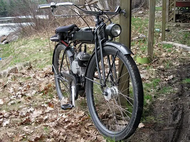

Here's a shot of the Rollfast patiently waitin' fer quittin' time, I've noticed it runs better w/a thermos o'coffee strapped to the rack - it's tru!

K, sos the truth of the matter is thus - despite the "pretty" of the Rollfast build, it is in fact jus' another el'cheapo Chinese 66cc 2smoker (Grubee Skyhawk) and I just can't resist experimenting, it's part of the fun of these engines as I see it... so I've been doing... stuff o.o
The port & polish is pretty standard, but the CNS carburetor is the source of much debate here on the forums so I hadta get one and see... as well as throwing caution to the wind and not just running, but breaking in a new motor with Amsoil's 'Saber Professional' with one tank full @ 80:1 and switching to 100:1 after that ran out ('bout 6 1/2 gallons used so far). Can't forget the SBP shiftkit goin' through a Sturmey Archer S30 X-RD3 3 speed hub...
So far so good (^)
Nothin' much to report about the shiftkit & Sturmey save it's still makin' me giggle, now that I've gotten a few miles on the engine and a few kinks sorted the 3rd gear is proving to be about right... tho I'll prolly still mess w/it a bit heh As for the Sturmey's durability we'll just hafta wait and see, but I've noticed if yer not really careful with throttle control you can "slam" the drivetrain, when downshifting the engine needs to spin up a lot faster to "catch up" with the speed the wheels are going and it's awful easy to forget to "roll" the RPMs up gently to match - not hard to do at all... but easy to forget if yer not used to it. Same goes with giving the engine a sec to spool down before up shifting, jus' letting off the throttle isn't quite enough as it needs just a lil more time than it takes to just twist the shifter. There may be more to it than that... but I gotta wonder if this isn't why other ppl have had hub failures, or a contributing factor anyway.
As for the CNS I wonder how much of the discontent ppl have expressed may be due to the poor assembly of the carb from the factory, not only is there a lack of any coherent/comprehensive instructions, there were assembly "errors" that made my life... interesting. A jet hadn't been fully seated so it fell out & down into the bowl, confusing the heck outa me as I tried to set the fuel/air to compensate (oddly, the bike still ran pretty well), the slide retains the cable in a slightly different method than the NT - it's got a lil clip instead of a slotted washer and that clip did nothing for me hung up in the spring and not where it was supposed to be so while the slide would return - the needle would take it's own sweet time to do so. Additionally, while the remote choke is sweet and quite useful - if the cable is even the slightest bit dry or routed with too much a bend, the plunger within the carb won't descend/retract fully and continue to alter the mix, making adjustment fun as you can't tell if the choke is partially on/off by just looking at it.
Still, after a careful rebuild it's actually been a pleasure to use and the ability to "fine tune" the fuel/air mix a relief, particularly given the oil ratio I'm using heh While I can tune the carb so there's absolutely no four stroking (except cold ofc) even when it's not under load, I'm runnin' it just a hair rich in my persistent paranoia... I'll get over that sooner or later methinks. It is a bit more complicated than the NT so I can't really recommend it unless you're already familiar with other carbs as it could drive the unwary insane heh... I also can't quite define how much/little the lack of four stroking has to do with the better carb and/or my other mods & experiments, the classic "too much at once" experimentation method - I'm psyched with the results tho!
Speakin' of which, the 100:1 ratio, even breaking in w/it has been a complete non-event with absolutely nothing to report... which is a good thing lol
I guess at this point only time will tell :p
