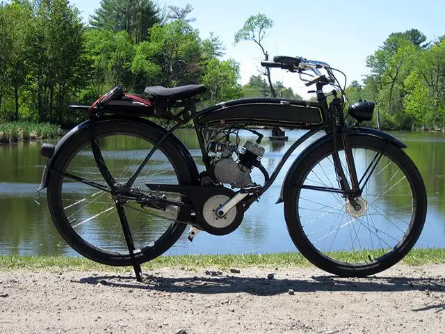

It's been awhile lol, but I managed to stop riding the Rollfast long 'nuff to get the dropstand on! Still crusty & the mounts raw steel - but it works and looks right methinks... I don't remember where I left off, but it's simple 'nuff sos I'll just post it anyway o.o
1/8" plate steel & a buncha ungodly dremel noises - I had to make an extension out of a lil chunk of stainless to relocate the cable mount for my rear brake;
(click to view)
Welded on the inside of the dropouts (I'll prolly fill the seam), the lil nubbin in front I left long so I can grind the ends flush. I thought I might hafta regrind the tabs too to get 'em to hold the dropstand at the right angle - but it worked out & I don't hafta touch them *whew* The spring clip under the fender... well, I've got one less stainless ruler lol, but it had just the right thickness & springiness so it got sacrificed for the cause heh
