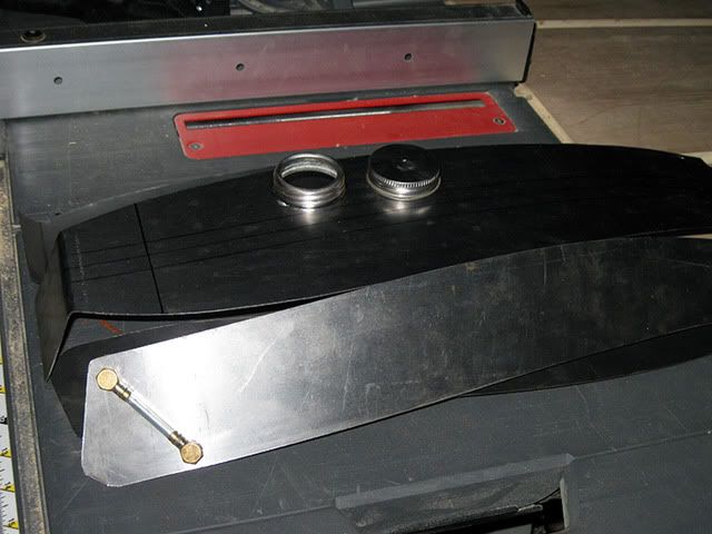

The tank welding done, it wasn't quite flawless - but far, far better than I feared. A "small" detail overlooked when setting alla this up is my poor buddy's lack of a foot control on his TIG machine... essentially just a stick welder with a TIG gun instead of a clamp - he's got no amperage control and the machine's lowest setting 'bout twice as much as needed for this lil project. With that in mind - I've nothin' but respect for my friend as he managed to not incinerate alla my work lol
Upside? While the welds may not be the most cosmetic in the world - they're freakin' strong and with the over-penetration developing a consistent bead on the inside, it's "gusseted" so to speak. So... a lotta grindin' and a lil filler... and a bunch more sanding and I've my fuel tank FTW ...and no, it's not gonna stay flat black heh - there's more sanding and painting to be done ofc... which is all that managed to prevent me from stickin' my nifty fuel filter and sight gauge on it for the pics.
The temptation was there tho lol, bad enough I hung the chainguard just for the pic - let alone the tangled nightmare of cables o.O

The tank has no leaks (whew) but I just "plugged" the fittings to test it... any fitting leak can be dealt with anyway should I need to.
A "fuel sight gauge" is so basic it simply can't help but work lol, but as the tank does curve down (in the back) and the size of the fittings it's not gonna be able to register... oh I dunno - like the last 1/4-1/3 tank at most? I figure when I can't see the fuel anymore - that'll be my "emergency reserve" and cause to start lookin' fer fuel.
I plan on usin' it mostly as a warning device to mark "the point of no return", that I'm down to 1/2 tank and should I not turn around and head back - I ain't gonna make it heh... and TBH it's mostly for the "stylie" factor as I suppose I could just take the cap off and have a look-see ;)
In case ya missed it (or ifn I forgot to post it lol), this is the sight gauge in alla it's glorious complexity :D

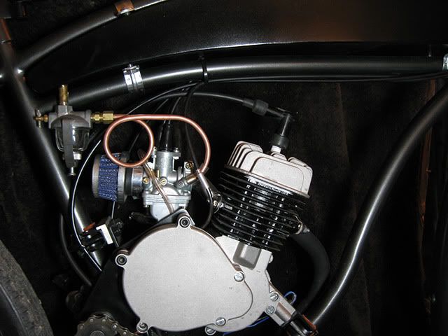

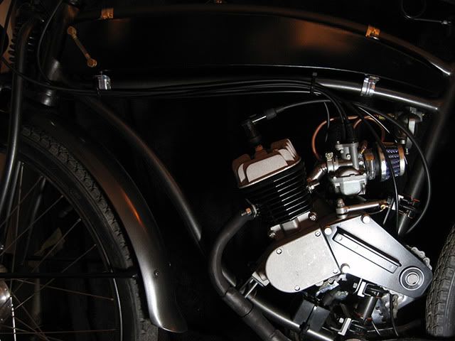

I actually managed to get a bunch done yesterday - tho little of it is apparent in a pic. One of the things that's not blatantly obvious in the photos is the fact that my bike's hasn't actually been truly assembled - tho the parts have been in place, it's just a "fitting" as I've had to fabricate so much, there's little point in gettin' stuff dialed in when I hafta just take it all apart again and again and again... Yet yesterday morning I got up and started sanding and painting the tank (more is needed still ofc) and while it dried I tackled the rest of the bike, sorting out details and adjustments and tryin' to beat the cables into submission.
I needed to grab a few things from work (longer plug wire & NGK cap, copper tubing & compression fittings etc.), as it was sucha nice day I wanted to be able to pedal in on the Rollfast - to not only strut my stuff but to see how "dialed in" the bike was. I'm happy to report that although it's freakin' heavy it rides like a dream, the sturmey archers not only working flawlessly but surprisingly silent, the bike also coasts foooorever with little to no drag. If it weren't for what will be a screamin' 2smoker - the name 'Gray Ghost' may be more appropriate than I thought heh
I thought I was used to the responses with my Schwinn, anyone that rides one of these things gets inured to the flattering but incessant questions... but even though I was just pedaling an incomplete project - people FREAKED out! While with the Schwinn I expect questions and comments when I come back out of the lil convenience store - I had not one but TWO cars pull over and stop while I was rollin' down the road, just to ask about my ol' bike o_O The first was an old fella that recognized the Rollfast for what it... well... usta be as he had one when he was a kid, the other a buncha motorheads that I imagine will now be ordering kits of their own lol
I have noticed I get lots more questions/comments when it's simply nice outside - no one cares much 'bout motorized bikes when there's a blizzard heh
Anyhoo - here's a coupla pics, I managed to get all the cables routed about how I want them, their curves right - I just need to have 'em on top of the lower tank tube instead of under it (didn't bother as I need to pull the tank again), bairdco will be pleased to see both the brake noodle on the clutch and the CDI tucked away under the motor (I fear he'd hunt me down ifn I didn't lol), The lil copper fuel line sorted and the SBP exhaust completed - except lacking an exhaust clamp and those pesky hose clamps on the chainstay. The hose clamp method of mounting the glasspack silencer works great, my Schwinn not only had thousands of miles with it mounted like that, but it even survived being cartwheeled in a pretty epic crash (my buddy crashed the Schwinn months ago) - I just don't think them up to the same standard as the rest of the build. I'll be welding a mount plate to the backside of the aluminum silencer... at some point lol
*shrug* There's still no electricals... I don't think I'll be wiring up a kill switch on this 'un as I'd rather keep the wires to a minimum (and use the button for the horn that's in the headlight housing), there's more than enough blasted cables on this thing as it is. Besides, the CNS has that nifty remote choke so why not use it? The gen hub, headlight & taillight... yea... I'm gettin' to 'em heh
