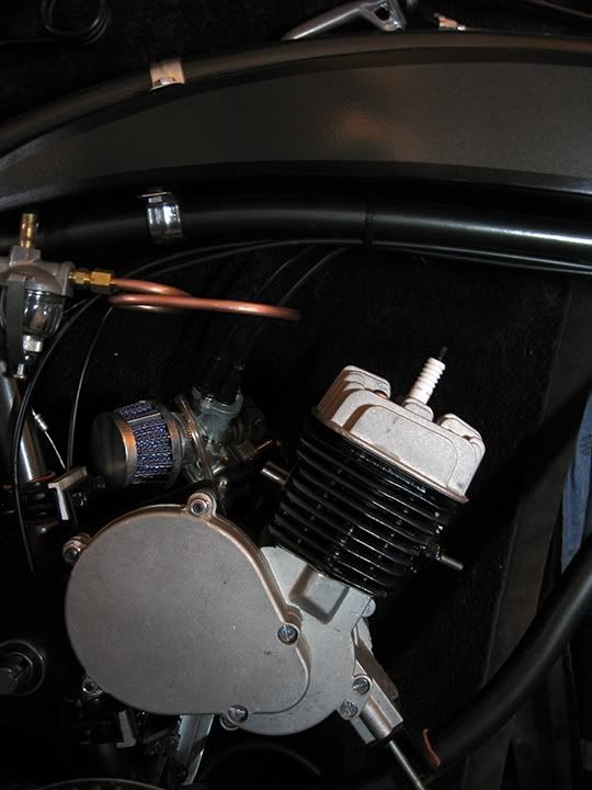

Well, I've got a few things to iron out before I take more pictures, but here are another two I took before the run yesterday. I heard a rattling behind me as I rode and figured I needed to check the skirts and rear fender over when I got back. Then the rattling pretty well stopped and I thought, "that's good" and rode along for awhile until it dawned on me why the rattling got better. The right skirt had come clear off. Ah man! I should have known better than to rely on the original setup with how the skirts attach to the fenders. The skirts have little housings with the nut inside so that a short bolt fits through the fender into the nut on the skirt. I had figured I'd just check them every so often to make sure all was well. Instead I should have used a smaller bolt to go inside of and through the nut with a locknut on the other side. Anyway, I backtracked hoping nobody picked up or ran over the skirt. I did find it unharmed other than a bend when it came loose and some scrapes from the road. One of the holes in the fender was torn from the bolt that didn't come loose. So, there's that. I think I'm going to just repaint the skirt, touch up the fender hole and bolt it back on more securely this time and leave it as is until I get back to Minnesota. Chances are good that even with careful packing 1200 miles in the back of my truck may leave it with some paint damage anyway. I'm also less than happy with the paint job in general and that rear fender is still not right and could use more work unless I luck out and find another in good shape to replace it. Looks ok from a distance, but not up close. I don't think I'm going to try painting again in cold weather outside. Maybe somebody else would do it well, but not me. So, I may end up taking it apart this summer and trying to do the paint right this time. Other than that the bike ran well and is a very comfortable, solid ride. I'm not sure, but I think the NGK Iridium plug has given the motor more power as it seemed to handle hills with a little more enthusiasm. You ride the same route with hills and you know which ones you can pull without bogging down too much. On the other hand I had that engine on my Schwinn American, so I'm also comparing two different bikes. Anyway, it starts very well. First pull with no choke. I had to search around to find it as the local Napa would not order it for me ("I'd hafta order a box a ten"), Advance Auto did order two for me. At least for my own bikes, this is the plug from now on. With a stock motor every little bit helps, so come summer I'll also do a little porting cleanup. Anyway, in general I'm pleased with the bike and will ride it as it is until I get back to Minnesota. Then it will get finished off to sell. This will give me an opportunity to enjoy it while it's mine and make sure I have things right before passing it on to the next owner. I'll know a lot more going in to next winter's build of the 34 Elgin which is pretty much the same model design as this 39 with a few smallish differences. When you do the same model bike more than once you get familiar with its peculiarities and fixes. The next one will be better yet.
Baridco, I'll give some thought to the CDI going inside the little tank. Thanks for the suggestion.
SB
