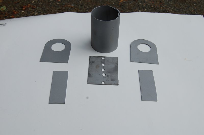

Have the next jack shaft attempt cut out and ready to weld up. The first one didn't work out the way it was supposed to. Just didn't look right more than any thing so it was on to the second one. I'll get some photos of it tomorrow before I start welding so you can see the parts before they go together to give everyone an idea of what I'm trying to do.

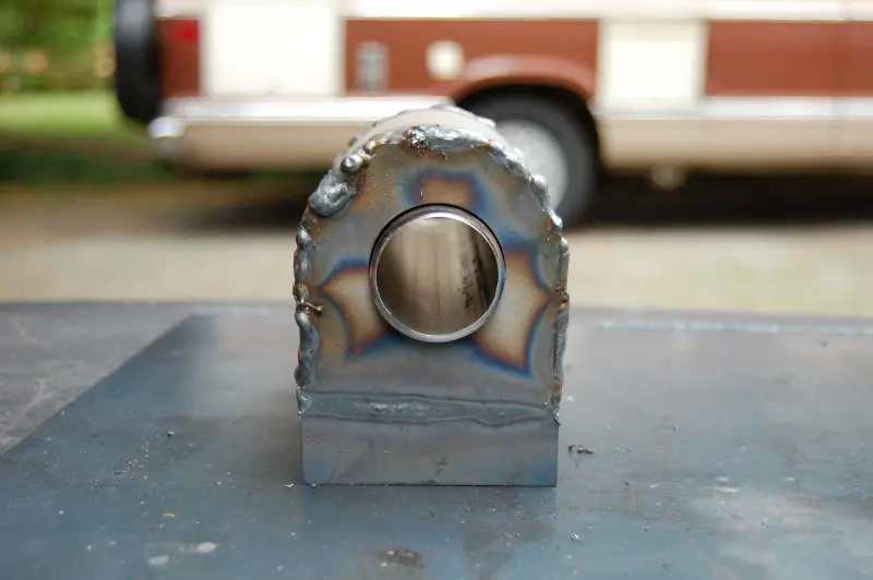

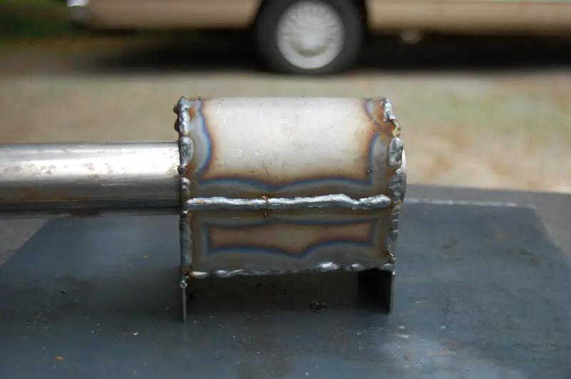

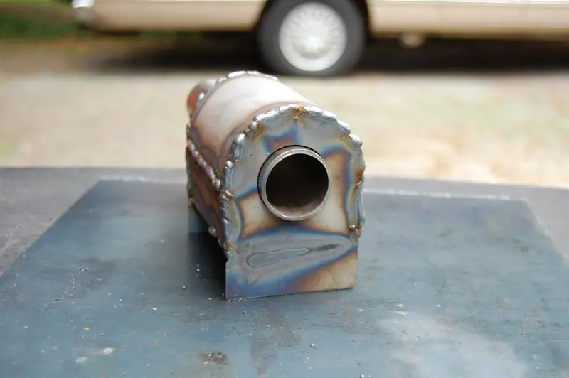

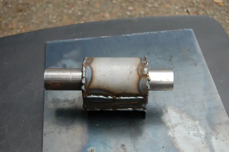

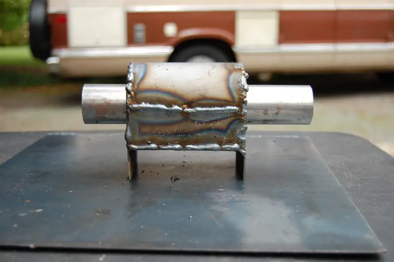

The jack shaft cover is welded up. Not the prettiest welding but so long as it holds together after it's trip through the belt sander it will be OK. The tubing in the center will be welded in after it's cut down to size and flanged bearings will press into the ends. The jack shaft will turn in the bearings.
Next week I'll put the carb together and weld up the intake manifold.

I can weld like that with industrial grade miller and gas shield. The goober welds don't, as we all know and Uncle Arnie would say it's all about the penetration.
Not setting on true granite surface plate and indicated .01mm side to side. Stand back three meters, looks good is good.

The welder is a 110v Miller with a gas shield. Had to go back and fill up two or three burn holes.

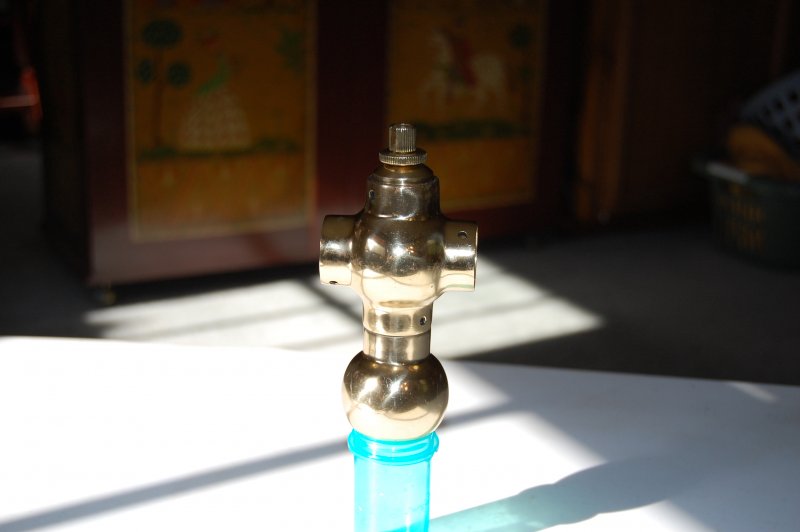

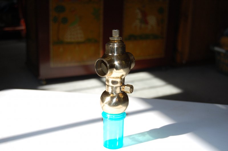

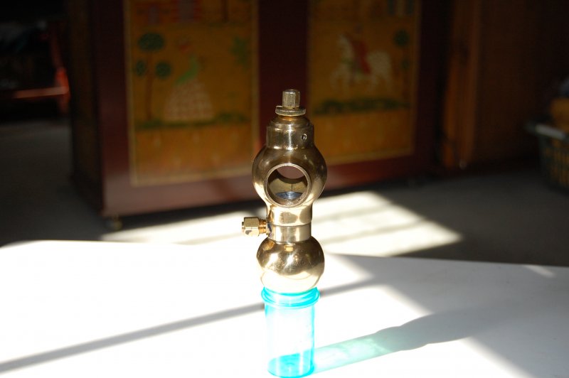

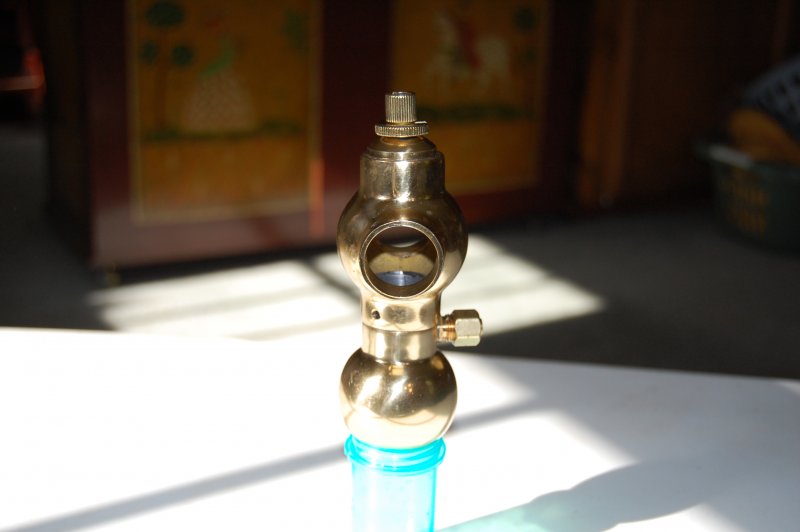

I made a brass carb for the tri car. In one of Rick's, {Indian22}, photos I saw a brass railing connector and that started me thinking about a carb. I purchased an antique brass carb from what was possibly a tractor but it was heavy and a bit too large.
I used 1" fittings. One was a four way T connector for the main body. The bowl is a ball that fits on the end of the brass tubing. The top is a plug that fits inside the tubing to finish it off. I purchased both a flat and domed plug. the flat plug worked best for me. I'll include a parts list and contact information for the company I bought them from.
The brass cable adjuster is something I had in the brass parts bag. If I hadn't had that I would have used a 1/4" brass gas line fitting. It doesn't need to work since the carb isn't real. Just improves the look.
I used some 1" outside diameter towel bar I had to join the T section to the ball on the bottom. J.B.Welded it after scuffing up the surfaces to provide a better grip for the epoxy. The top cap I epoxied the towel bar tubing to the inside of the T section but left the end cap loose so it can be removed so I can secure the cable inside the cap. I have a brass bolt and it will hold the end cap in place after a hole is drilled and threaded.
Parts used.
1) 803-10 single ball outlet-1"
1) 835-10 ball cross-1"
1) 809-10A semi domed end cap-1"
1) 809-10 domed end cap-1"
This is the end cap I didn't use but I included it in case you chose to.
