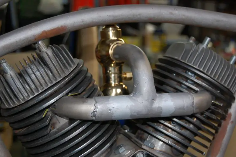

I went out to the garage today with great revised plans for an intake manifold then had to revise, the revised plans, that I'd already revised. How hard can it be to weld up some tubing?
Came up with something that is finally working and if I can get back at it tomorrow I'll take the camera with me.
Steve.

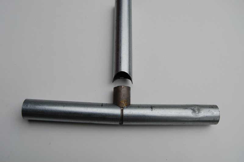

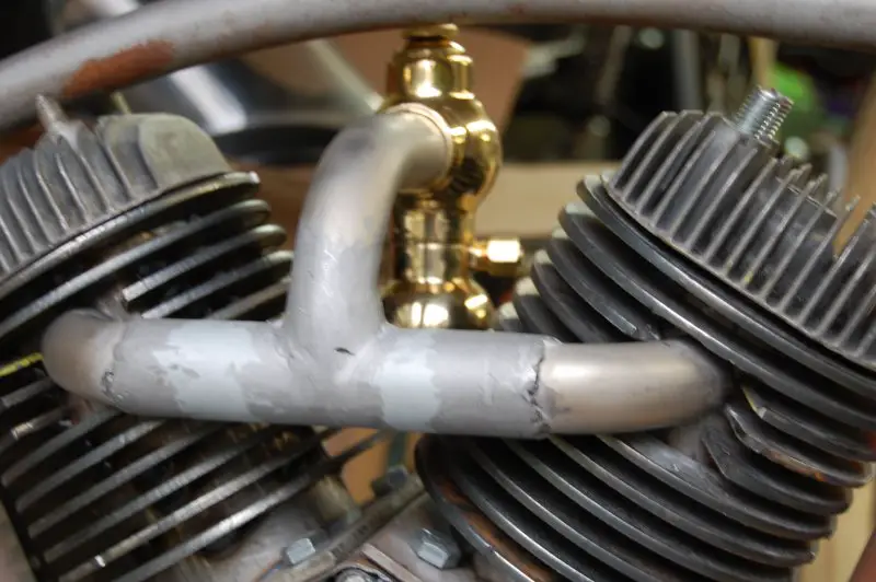

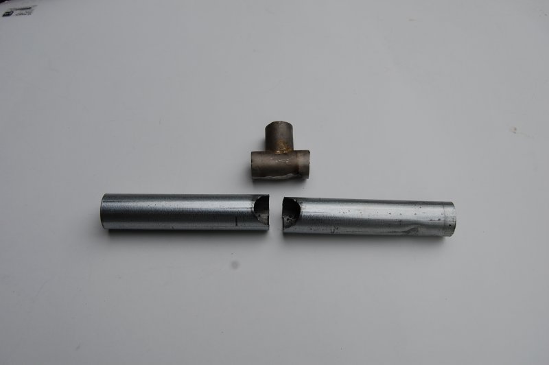

After trying different ways to make the manifold I decided to use a hole saw to cut a hole in the tubing on one side and then split the tubing at the hole so I could slide a T section I had into it to act as support as I clamped the two halve back together and spot welded them. Then I used the hole saw to cut though another piece of tubing and cut it in half at the hole so I could slide it down over the upright part of the T and weld it together.

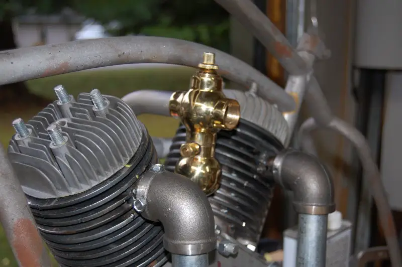

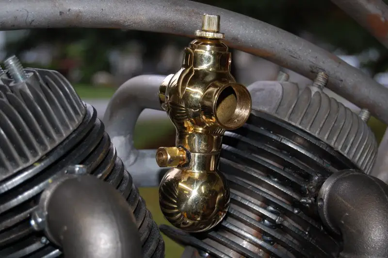

Two curved parts from the same safety grab rail connected it to the cylinders. Carb is held on with a bolt though the carb flange and into the manifold.
We have ten day of rain forecast for the Wet Coast so I'll take the motor out of the frame and smooth the welds on the frame if it isn't raining and work on my grand nieces side car when it is.
Steve.

Hi, Measure Twice,
I will touch up the headers with a torch and blacken the exhaust pipe tip as well. I haven't lost a jacket to heat yet but I do have scars on my inner wrists where I took my welding gloves off then knocked what I was welding over on them.
I have a dandy left over from when I was welding up Silverbear's side car frame.
Steve.
It's looking great Steve the carb & intake are working well. No help at this point but I could have supplied various individual fin profiles for different porting tapers and fins in asymetrical shapes to accomidate exhaust port styles or to accept push rods or tubes. Regardless the round fins look fine and yes pre shaping each fin before welding is the way to do it, but you managed quite well on the fly.
