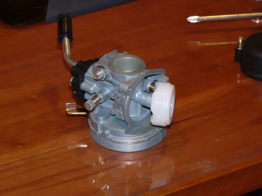

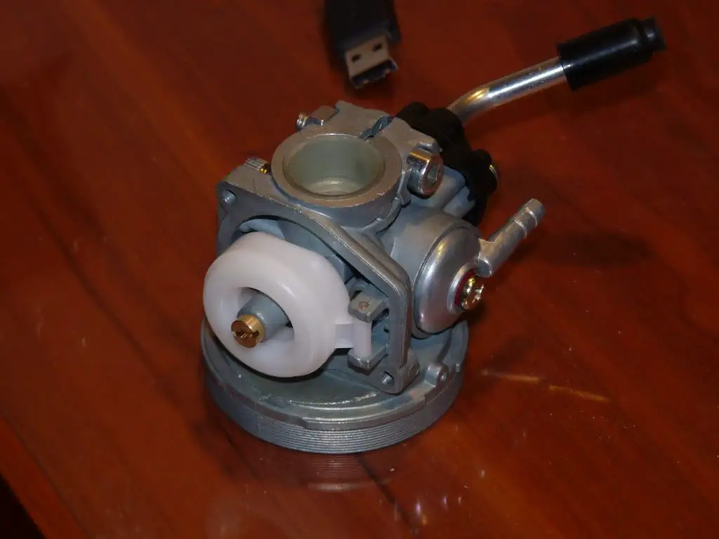

Here is the float (it is on a hinge! No more leaky float bowls...)

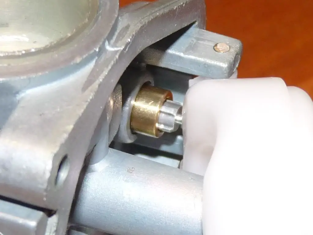

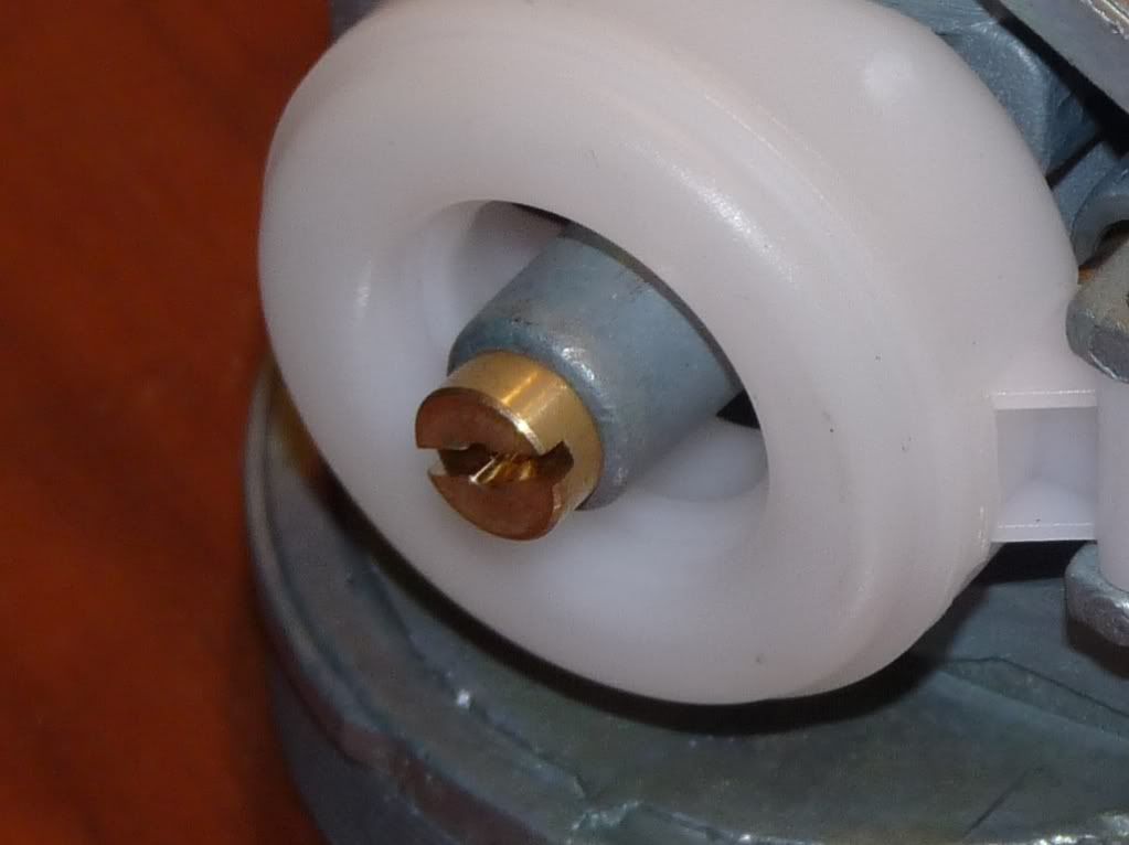

Main Jet:

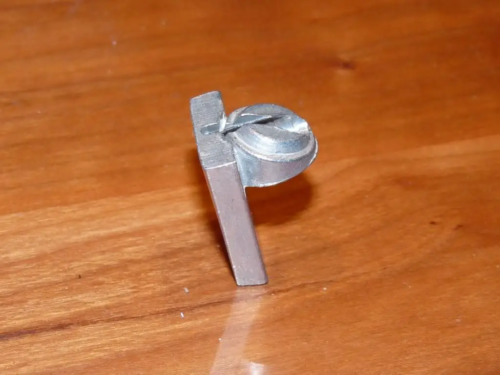

Rectangular Slide:

That is my exact question as well: Which size to get M5 or M6? I removed the jet from the carb and I was wondering how you determine if it is an M5 or M6 thread. The measurment across the threads with a digital caliper is 4.97 mm...
I'm glad to see that someone else had the same problems. I'll go ahead and switch to the #70 jet. Did you drill that one to get to #67 or were you able to find a #67 jet?
I soldered it and drilled it out to 0.67mm (#67 jet), with a #71 drill bit... But I would prefer it if I could use a manufactured jet because they have a better shape and are stronger. I could actually lean it out a bit more, I think a 65 would be about perfect...
The #70 jet is installed. I'll report how it goes tomorrow. It almost gave me a heart attack though. When I removed the jet(that sucker was in there tight), the bowl fell out. There was a funny looking pin with it too. I looked at the hinge on the carb and saw that the hinge pin was barely hanging on. What the **** is this mystery pin? After about thirty minutes of studying it in my hot garage, I decided it slides into a slot on the float and is inserted into the idle jet. I have no idea what it does I just hope it does what it is supposed to do. At least that is how it was re-installed. it cranked and I made a couple of very short runs and it seemed to run and idle OK. I'll find out if that sucker is in there correctly when I drive it to work tomorrow.
If you take pictures I can verify that you installed it properly...
