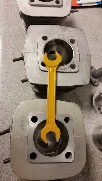

Ok... took some pics this morning... this is my very first powdercoating and was mainly a test to see if my setup would work... You can see on the end of the wrench where I picked it up with my fingers to set it into the oven but other than that (and the ugly mustard yellow color), the finish came out great. There are a few more little things I need to get like the high temp masking tape and the silicone plugs etc before I can powder coat a jug or carb body etc, but I'll be getting that stuff as I go... For now I'll be finding some more of these cheap wrenches around the shop and doing the same for practice...
That looks like Catapillar Yellow to me, one of my late Granddads favorite colors, he painted some of it on all of his tools to identify them, I grew up seeing that color a lot, wasn't my favorite color personally, but not to bad for some things.
I have a couple rattle cans of paint that color, lid showed a nice bright yellow, but when I test sprayed some it was that good ole baby poop Catapillar Yellow or could be John Deere Yellow also I guess since they also use a yellow like that on their Backhoes and Dozers.
The finish looks good, smooth and shiny, does it seem fairly tough?
Bad thing about rattle can painting things is it looks good until you touch it and then it scratches so easy, very fragile.

Dave did you buy your powder system from Harbor Freight?
If so, I have had the same system sitting in the shop. Not even sure where or when I got it....
Haven't used it yet .
The toaster oven comment turned on a light in my dim brain....
Thanks . I now will need to buy a new oven for the wet bar as I have new plans for the existing one......... Gregg...

On the powder coat, so far it seems to be pretty durable... noticeably more durable than paint but I will put the stuff to the test even more...
For the gun, yes it's the harbor freight setup and it does work pretty well.. I can only compare it to my friend's Eastwood setup and they're both very similar in setup as well as build quality. For the heating, the toaster oven does the job quite well but it needs to be preheated before putting the parts inside. I will do more experimenting this weekend and torture testing the wrenches I'm going to practice on.
For now, best I can say is so far so good since I've only done that one wrench so far...
good deal, Ill be watching your comments on the powder coat durability.
Yeah I decided the best way to test the durability is by doing some of those cheaper wrenches since they usually have a kinda textured finish so the powder coat sticks to it pretty well without the need to sand blast the chrome off... but since there's still chrome on the wrenches the powder coat wont stick to them as well as if I de chromed them first... this will ensure durability testing since the stuff is being applied to an improperly prepped surface... the surface is cleaned very well but its going onto chrome so if it canstand up to staying put on that I'll know for sure it wont come off a properly prepoed surface. Also doing the wrenches they will get pretty beat up pretty fast since they get used a LOT.
For the curing it only takes about 10 minutes at 400 degrees so the toaster oven works great since it shuts off at the set time and cools the parts gradually at the same time so you can set the temp, crank it over to 10 minutes and walk away... the only disadvantage to the toaster oven is its size if one wants to do larger parts but eastwood sells a powder cost curing lamp that heats the parts outside an oven and there's no size limit... just need to cure one section at a time by moving the lamp about every 10 minutes. I'll get one of these later on if I can do bike frames and tanks etc, something like that would pay for its self after just a few jobs.
