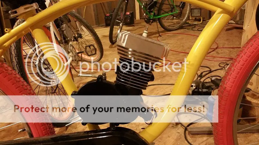

How are you matching the case to cylinder with the reversed top end?
No way to actually match it perfectly from what I have seen with my looking it over so far, but it can be done plenty good enough that it will not have any flow restricted between case and transfer ports, I'm not looking for performance gian by reversing the jug, I'm looking for an easier way to set up the exhaust I plan to use on the bike, I hate the limitations that we have by the exhaust exiting up front on these engines, I don't want to have to a long pipe or flew pipe for the chamber I plan to use, I have found that one of the reasons some of the smaller pocket bike expansion pipes don't seem to work that well is because most of the time people use to long of a lead off pipe from the engine to the chamber, seems that when the lead off pipe gets over about 10-12" long the pipes just don't work well at all in my experience.
By having the jug reversed I can keep my lead off pipe to the larger longer chamber I plan to use at a good length which will probably be about 9-10" or 11 inches long, I have a really nice Moped chamber that I think will work good on one of these engines but there isn't a good way to set it up with the jug in the stock position.
this will be my first engine to set up this way, but I think I can make it work out the way I need it too.
I'll likely need to build a custom intake and since I do a lot of dirt road riding, I plan to build a custom carb filter set up to get the fresh air intake up higher so the front tire wont be loading up the air filter with a pile of dirt, there will be multiple changes needed for that set up to work out good for me but I'll get it done and try to make it look as good as possible in the process if I can.
The gasket will need to be modified and the case and jug also, this case I have is different than any of the other I have seen in a long time, it has huge transfers compared to what the case we see now have and the jug that came with this case is on my Kulana bike and has big ports in every area, I'm curious to see what this engine is gonna do when I get it built, I'm not looking for high speed from this engine, but really good low - mid to cruise RPMs will be what I'm shooting for, low to mid 40's MPH and a good pull up to that point would be nice.

Shan, what's with that huge front mount saddle? Is it the angle of the camera or is that semi-circular area at least twice the diameter of any China Girl mount I've seen.
No Tom its not an odd angle, the front saddle in that case is much larger than a standard case, it will saddle over the frames with the large front down tube perfectly, I have two more engine with that same size front saddle area, it makes mounting those engines real easy on cruiser frames with big tubes up front like the Huffy and Schwinn frames we see now days along with most of the other bike tube frames I've seen.
This is an engines I bought from LEB about three years ago even back then this engin had the same crankshaft as what is in th GenIV dax engines now, I'd love to get my hands on several more of them and if I had known then what I know now I would have bought several of them, I think I paid about $60 for the entire engine, came with best looking jug I have seen as of yet and this case has huge ports and came with the better quality bearings that are smooth as silk.

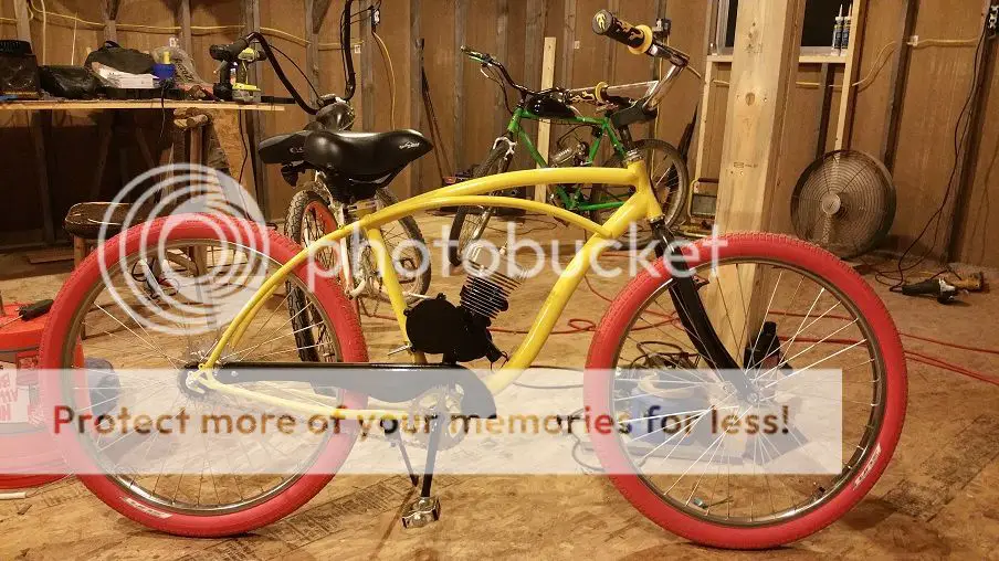

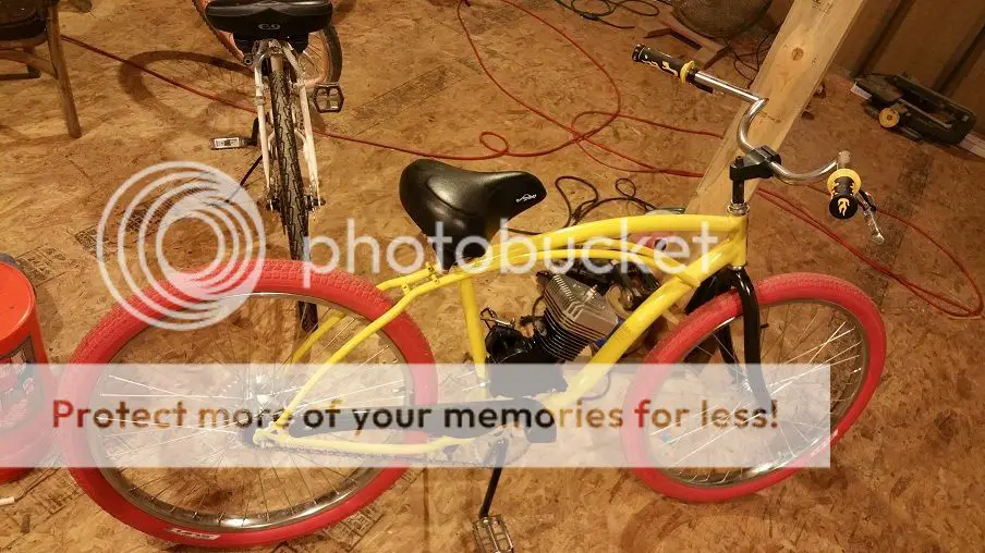

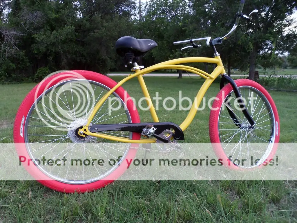

I took a few better pix of the Schwinn build and just wanted to share them, the other pix made people think I had Pink tires on the bike and in these they look Red like they are, Got my Yellow and Black flame grips in yesterday and had to see how they would look, also got the levers I had ordered and wanted to see how they would look on the clubman bars.
Ahhhh-Ummmm, Shan, they still look pink to me :)
Still pretty in pink!!!!laff Red or pink tires depending upon ones level of color blindness is not quite my thing, but I will say I love the yellow and black together. Looks real good!!!
Shan knows we're just having some fun at his expense. But it does make me think of the old Procol Harum song, 'A whiter shade of pale' or in this case, a 'pinker shade of red'. Maybe take a hint from Burt Monroe and try some black Kiwi show polish on those tires.
And I agree with Roo. The black and yellow looks great.
Oh yeah its all in fun and I had no doubt when I posted the newer pics that I'd get some more pinky feed back......
In reality tire have zero pink look to them in real life, but for some reason both of my camera's cause the pics to show the tires with a pinkish tint to them, I thought about calling this the clown bike, because the red tires on a yellow bike that also has the black trim so to speak is a little clownish looking, I wanted this bike to get attention whether good or bad, thats why I went for the funky tires, at least for now, in time it may get some Black tires with Yellow side walls which will go with it much better but for now its gonna have the red boots on just for the attention it will get, it will be an either I love it like that or I hate the red tires.... either way I dont care, just gonna have fun riding it when I can get my engine built and set up.
But yeah, the ribbing about the tires looking pink in the pix dont borher me a bit, I wouldn't personally put pink on anything myself but hey to each their own or whatever...lol..!
Its all in good fun in the family here.
Map
