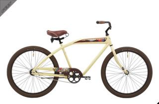

Awesome Oscar, thanks. I was wondering if I could do just that. I am (pending finances) doing a 4stroke build with a Felt Trestle. It begs for springers. ..and I beg to stop previous to the impending accident, lol
Once again, if I can dream it, you good folks can show me how. Does it get any better then that?
