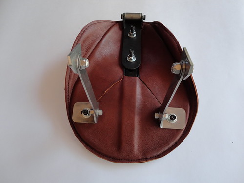

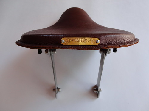

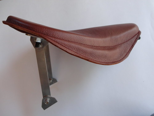

BTR Seat by Sportsman Flyer, on Flickr
Pat! you really need to stop. You keep coming up with things I really really want, but can't afford. Did it cost a mint to get your seat Pan covered?
I try to standadrize as best I can to keep things resonable. The guy I am working with developed a pattern and a few test covers in cheaper material to practice and get all the details worked out. First one was more than I wanted to spend. Future ones should be more reasonable. It didn't break the bank. Sorry about the thread hijack.........
