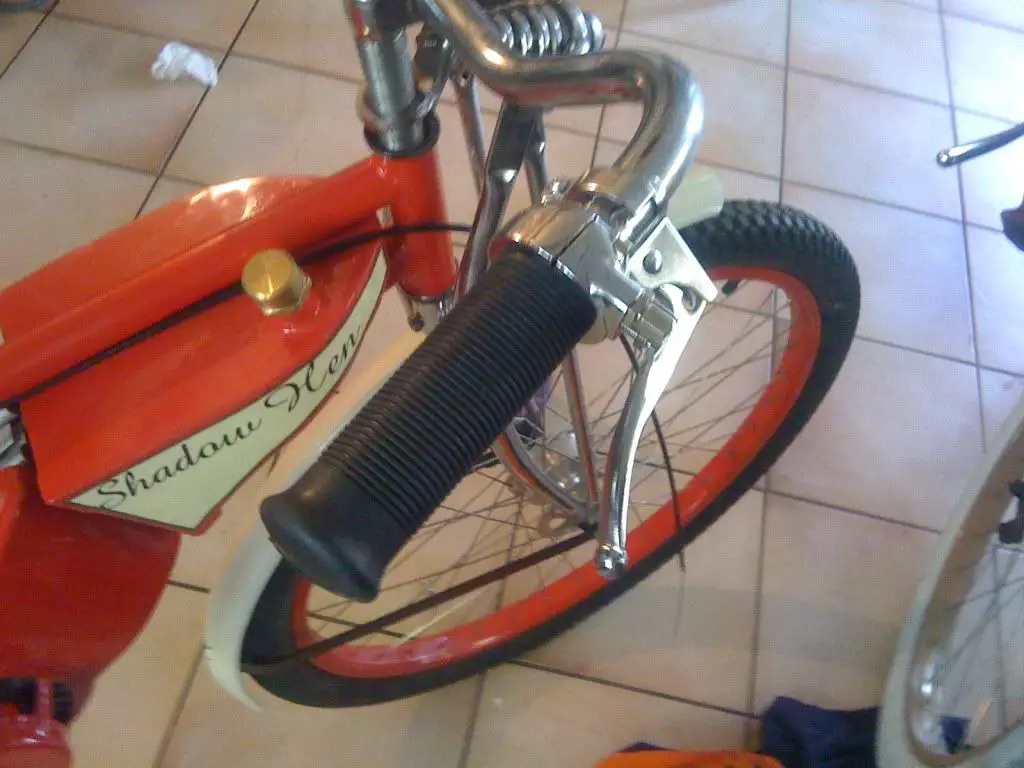

The below picture i posted earlier probably shows it a little (though not the best picture, sorry)..... the red rims on the left are those Alex rims, and the beige rims on the right are wider downhill rims (forgotten the brand name) and probably very close to the Worksman rims
