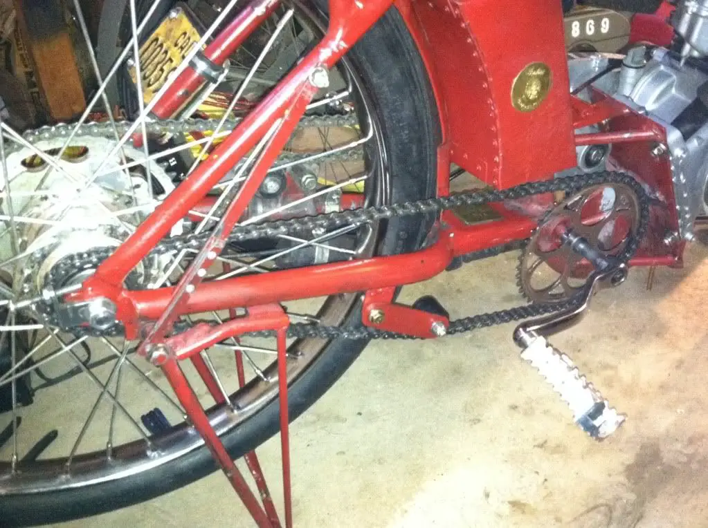

I will, once I add a half link (offset link) to the chain on the pedal sprocket side. The 2 chains are a half link outta sync with each other, if you know what I mean.
And yeah Pat's idler setup is much nicer, but doesnt give a very big range of adjustment. It'll be fine once I get the chain lengths sorted so I'll go back to it then.

Brett,
Sounds like a half link is necessary. So much I take for granted in the states. I have a bearing supply right around the corner and they keep #41 Diamond in stock for me. Why not just set up the motor side correctly and run the pedal side a half link too long for now. It's really no big deal. Other option is to find a front or rear pedal sprocket one tooth size bigger or go from an even number to an odd number of teeth in any size that will fit. Whatever you do don't cut the idler tab off. It is carefully located front to back and aligned properly. Looks simple enough but it is very critical to be located perfectly, which it is now.
Brett,
Yep you are right. When you've been messing with it for hours you start to have strange ideas! (which I then type out haha! but it's probably just a healthy part of the learning process; that's what I will tell myself anyway...)
I found a guy in NZ who supplies the engine kits who has a half link; he's not in our city so Ive ordered & should have sometime next week. Once I put a half link on the pedal side it should all be about right.
