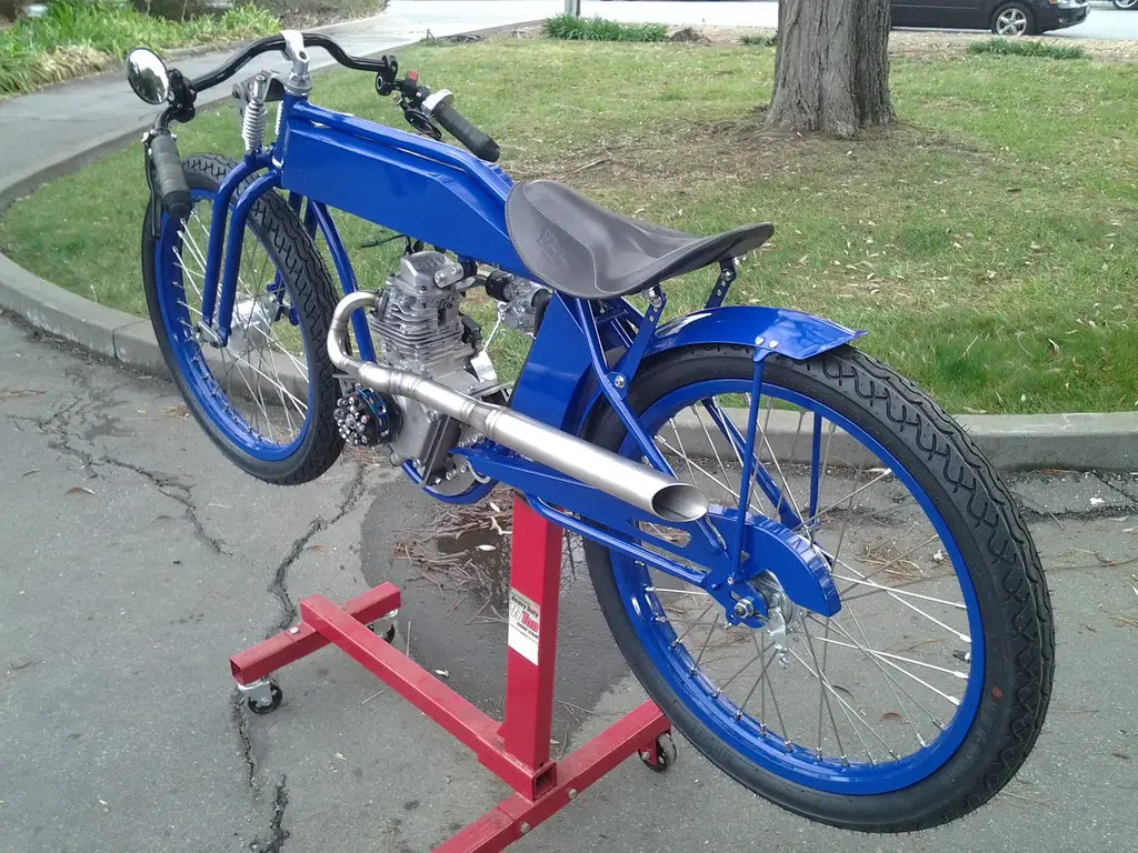

Couple more updates. Here it is now with the engine installed and wheels and tires mounted. Tires are Pirelli MT66 80/90-21's on 21 x 1.6 motorcycle rims laced to my drum hubs. My brother Rich did a nice job putting these together. Thanks, Bro!

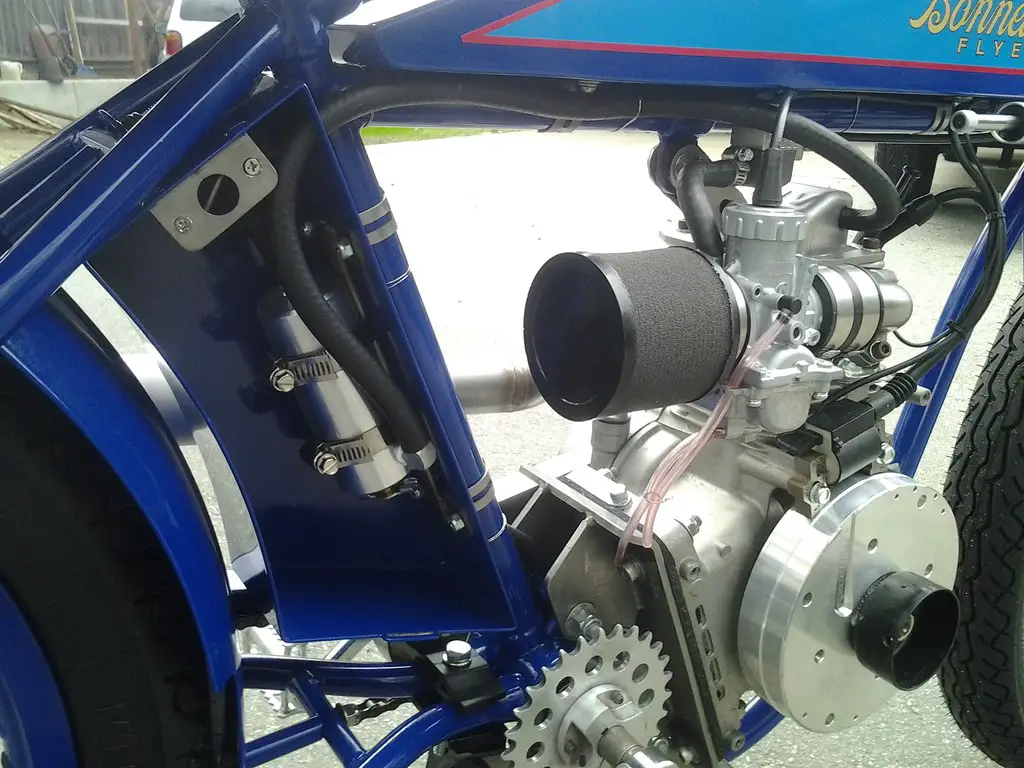

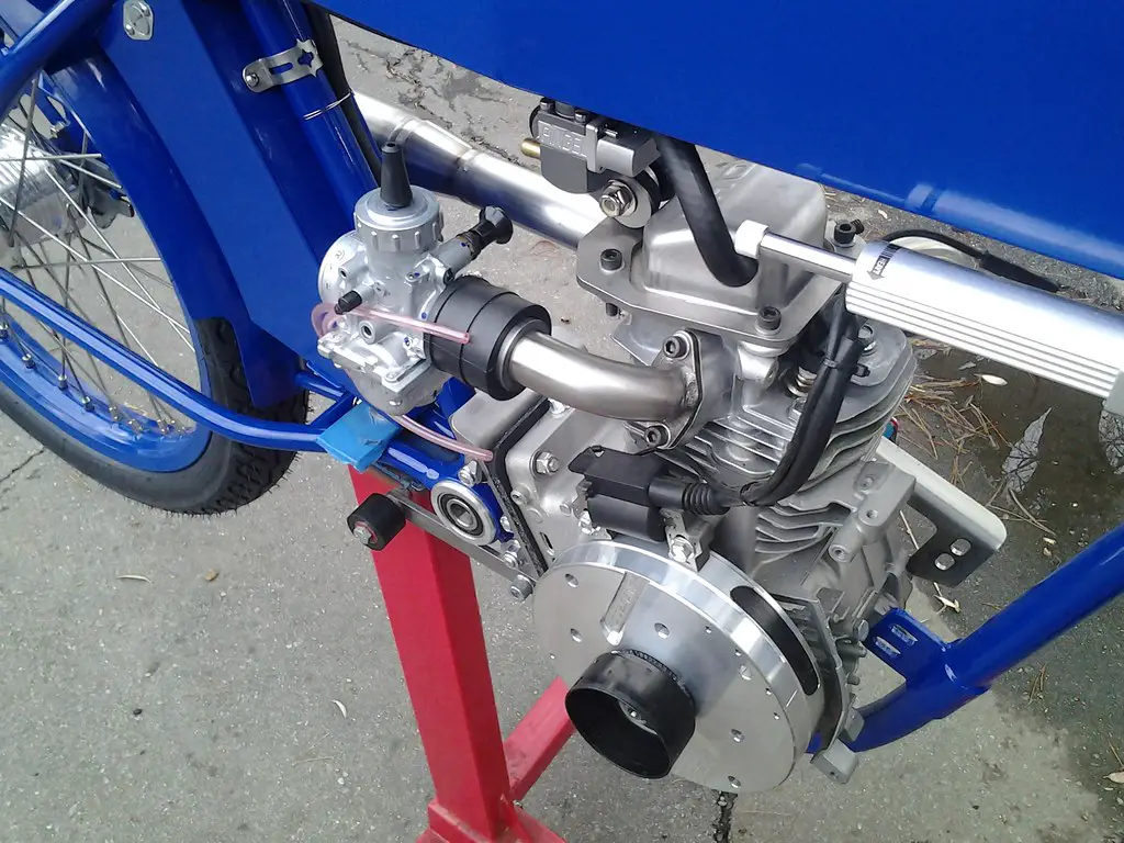

New style intake manifold with spigot adapter and 26mm Mikuni carb. These carbs are the way to go on a bigger GX200 build. No messing around, just straight up performance right out of the box. Remember that 25.4mm is 1" and the tubing I use is also 1" so the flow throught the carb and into the head is almost perfectly sized and only has one 90 degree turn. You can also see the SCTA required remote cutoff fuel valve and steering stabilizer.

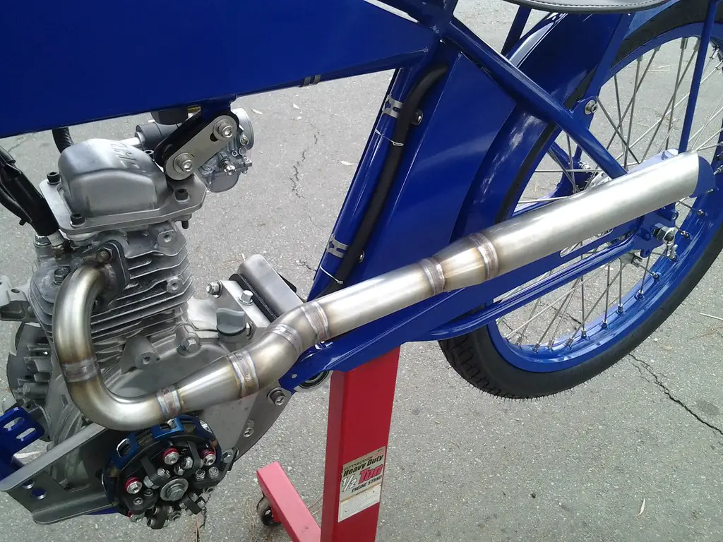

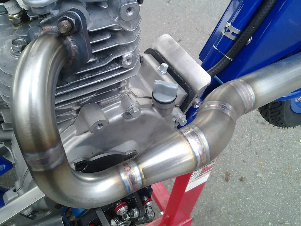

I have revised the exhaust pipe as well. 1" directly into 1 1/2" then 2" tube. Also been getting the welding really dialed in on this thin wall stainless tube. TIG welded and purged for quality welds with full penetration. Pipe will get a removable baffle. Running the new intake with 26mm carb and fatter exhaust has really improved engine performance.
Bonneville Flyer #3 by Sportsman Flyer, on Flickr
Here is a detail of the exhaust as it leaves the head. Really enjoying this build! Nice color and all the best parts.

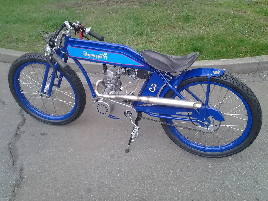

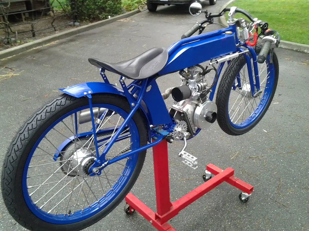

Very close to being done. Still need graphics applied, flywheel cover installed. and primary guard finished up. Oh, and some safety wire here and there.

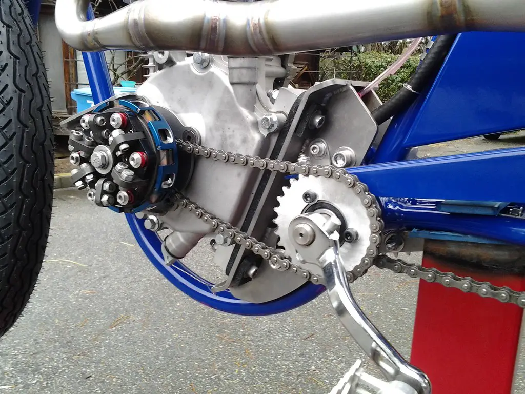

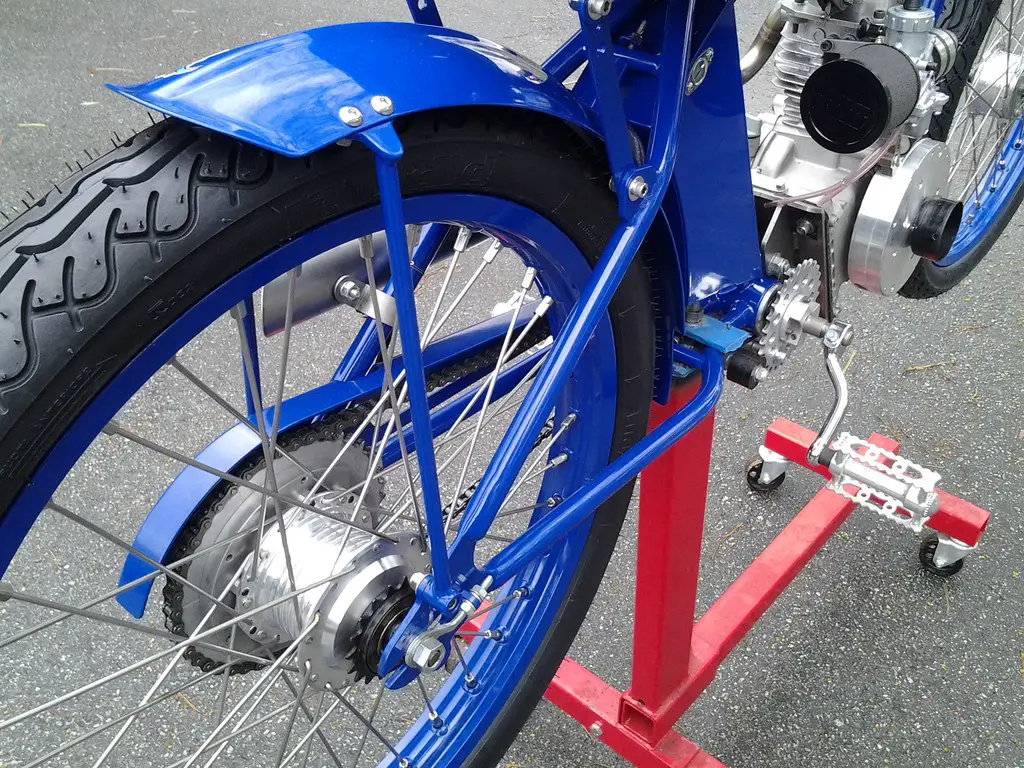

Looking at the sprockets shows how tall the gearing is. I bet it will cruise comfortably at 60 mph.
Locked out pedal crank and no pedal side chain, either. The SCTA will not allow a functional pedal crank. They also will not let a motorized bicycle run. I want people to see this bike for what it really is so I left the obvious bicycle components and still met the minimum requirements of the rules. This is now considered a motorcycle.

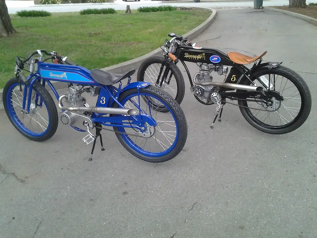

Basically ready to run. The race bikes sure take time to cover all the details....
Number 3 is now spending quality shop time with my record bike from last year, Bonneville Flyer chassis #5. Race bikes get kind of busy looking with all the required components, but these aren't beauty queens. The first thing we do is just ruin all the finishes with salt spray. Right now #5 carries a nice layer of patina from last year. Salt messes with EVERYTHING!
