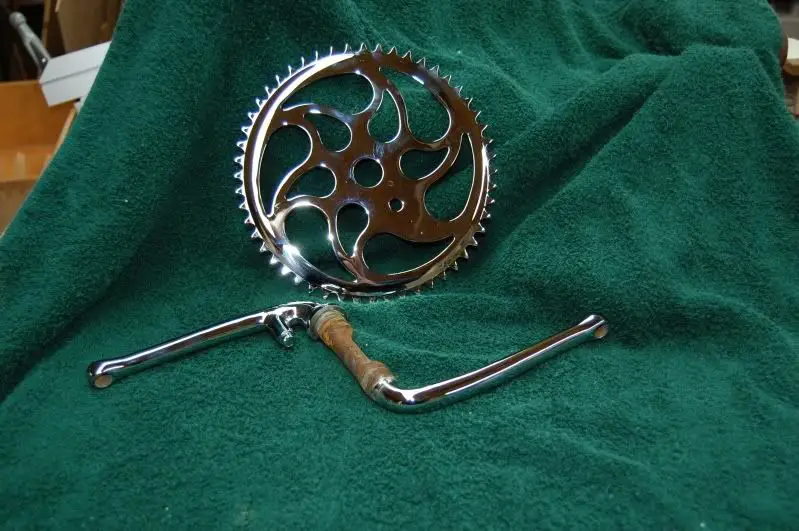

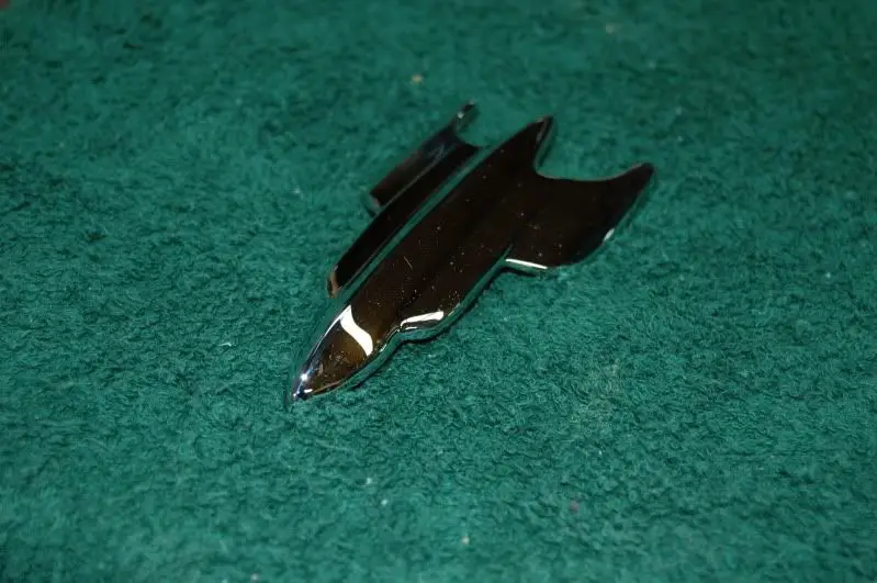

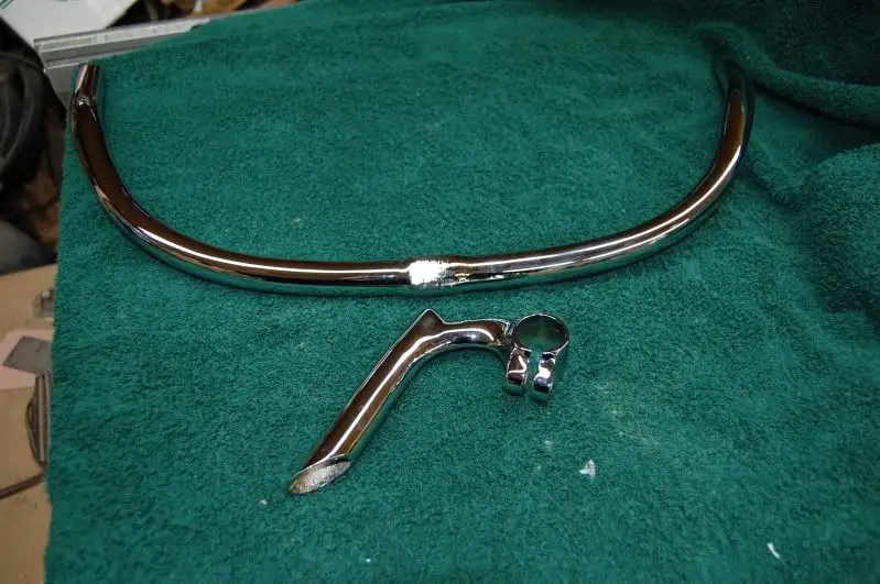

Got some of the chrome back today and it is fantastic. I didn't get any before pictures but if you look back over the photos here you will see the bike and I think there are some there that show what it was like.
The cost was $650 for what I had done. I'm taking the rims, hubs and the pedal frames in next. The pedals have Monark pressed into them. Springer parts have to go also..

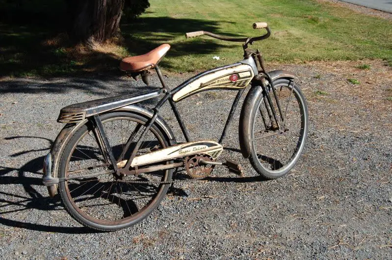

I'm putting Worksman brake drum hub wheels on it but I'm having all the original parts redone so that I can return the bike to original restored and keep the sidecar if I want and use it on another bike. The bike was 100% complete and original when I bought it.

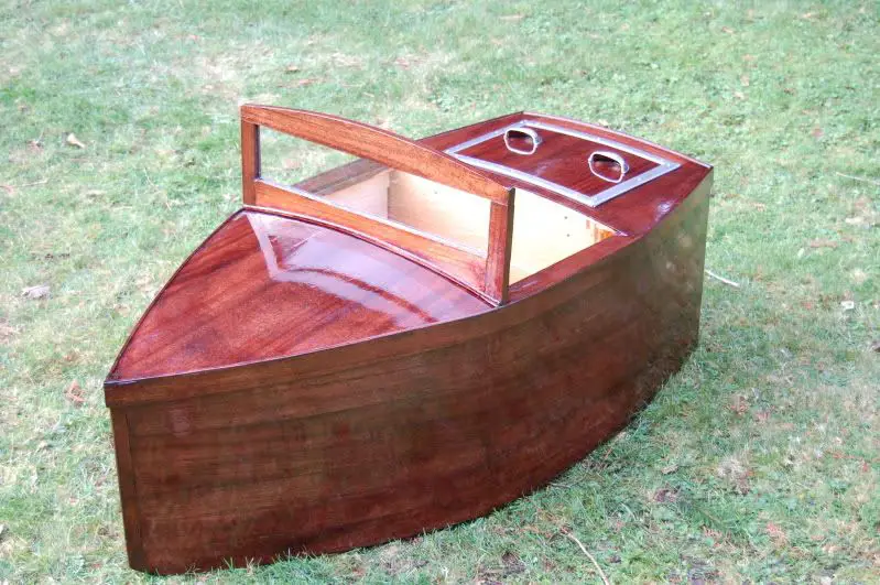

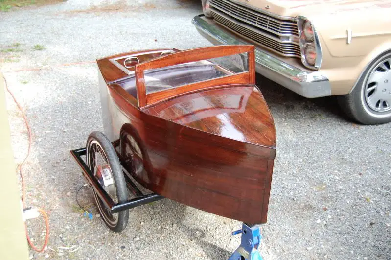

Well the hot breath of success is on the back of my neck. Got the side car on the frame and put some photos on photo bucket. Have to get a 20 inch fender for it but I'll go up to the bike store tomorrow and see what they have.
I think that by the time I put the battery in the back I will have hit a pretty good balance with the sidecar so it's not heavy on one end.
Tomorrow I'll start sanding and buffing all the bumps and insects out of the paint and polishing it. Mabe by the end of the week it will be done. I may have to swap the spare front wheel I have to the back to get the right height to hook up the sidecar. Have to get in touch with Worksmans Canadian rep. tomorrow to try and get a wheel. Replacement springer chrome is coming from Crossbow.
