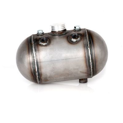

Hi Dave very nice I really like the wicker gives it a vintage look I bet that tunes some heads I'm new at this but your design is close to what im thinking of two things having the sidecar on the lift side like that do you feel more comfortable when cars pass you ?
And my main question is did you make that gas tank or are there remakes of a cylinder tank ? Im thinking of getting two side by side cylinder tanks I wish I could find half gallon copper ones that would look so 1900's .
Like this its a oil tank for a chopper But I still would like copper or brass coating my be that would work

The fuel tank with some help, I made from some 4 inch exhaust pipe $10 for about 1 foot long length, I paid a guy who repairs motorcycle exhausts $20 to cap both ends, I removed the fill tube and cap and also the fuel tap bung from the original peanut tank and the same guy welded them into the tank another $20.
Also to weld on the mounting tabs $10, I have about $60 invested into it, I don't know if you can make one any cheaper than that.
