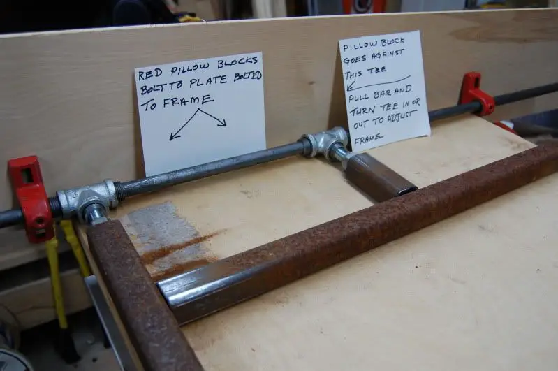

If your going to carry a light load such as a child , dog, groceries or a few cases of your favorite beverage you can use this type of a set up that I'll post below. It attaches to your chain stay and if your putting a large sidecar on it to haul your buddies around remember the strain is on the chain stay only.
This is what I came up with to remove Silverbears sidecar quickly. You will need to turn the tubing sideways to have it work for what you want. One as far forward as you can and one as far back as you can on the chain rail.
What ever you use for the sidecar frame I would weld a plate on the end with a piece of tubing that fits tight against the mounts on the bike. You don't want it sliding back and forth at all. Slide a length of solid bar inside the tubing so that it goes through both the mounts so that the load is spread evenly and you will be ready to go.
I'll post a photo of my first attempt at doing this which worked but with my bad sense of balance it didn't to work for me. It will give you a better Idea of what I mean.
Steve.
Frank,
This is from my Photobucket build file so if you want to look back and forth on it please do but this will cut out the searching.
The threaded rod was to make the toe in and out of the side car ajustable. If it's not just right it will push the sidecar against the bike or pull it away from it. In the end when I rebuilt it as a solid mount sidecar I built in about 2% toe in and that worked out quite well for me.
As DaveM said you may not want to make it so it tilts. The reason I mentioned that you need to watch the sidecar weight is because you will be constantly trying to keep the bike upright as the weight of the sidecar pulls down.
Hope this helps.
Steve.
