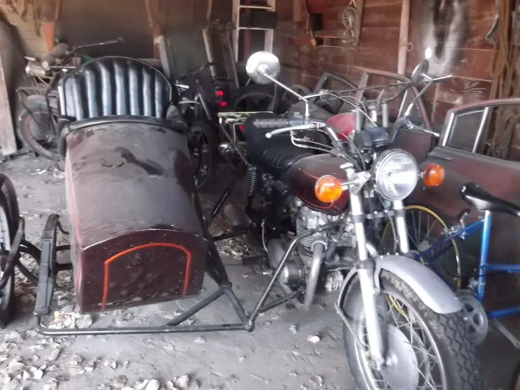

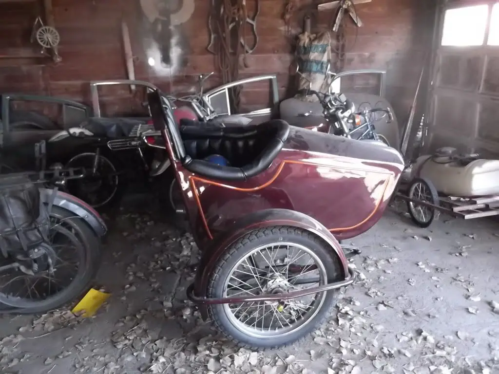

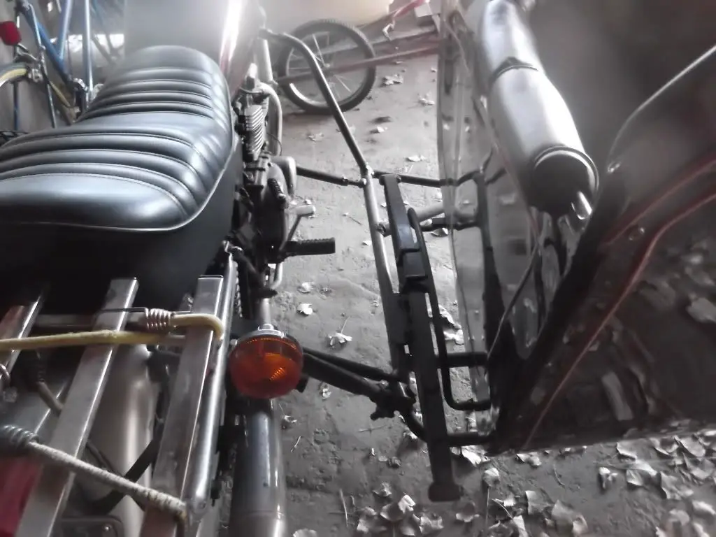

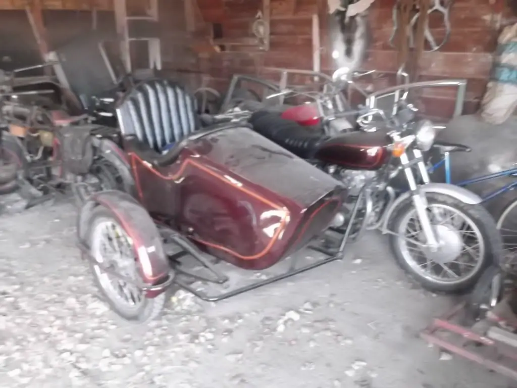

Here's the pics of my dad's Kawasaki...
Yeah, my dad owns a leather shop, (hence the upholstery). Also, it's all skinned in tin!, just some thin steel we had laying around the shop. It's not much, but it's cheaper to ride to town in that to get milk than it is to spend the money on gas for the truck :). He likes to give our dog rides... If that tell you anything...
Your dad gives the dog rides in the sidecar? Yes, it tells me he's a great guy and it gives a new meaning to the term "lucky dog".
