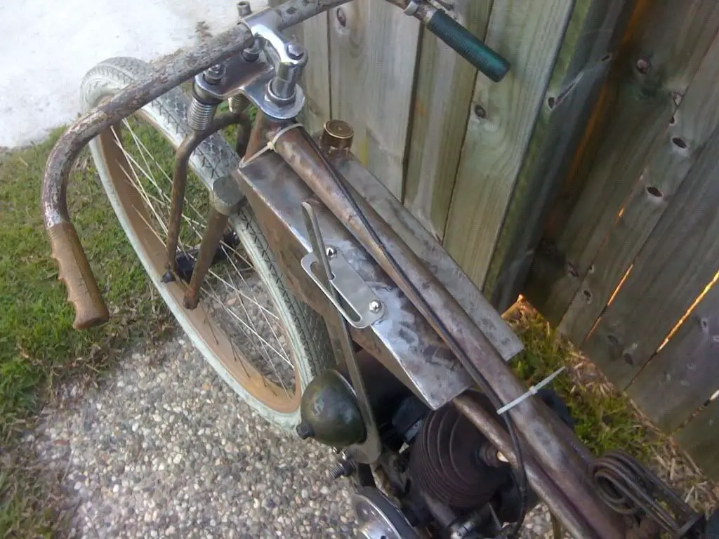

I’m looking for an creative ( ie: inexpensive ) filler tube & cap for a new gas tank build.
What did you use...?

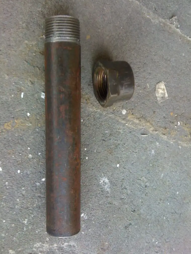

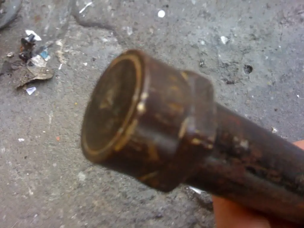

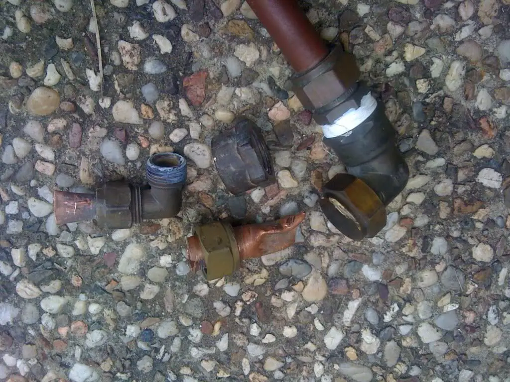

I use gas fitting end plugs, they are made of brass, i found some old ones on a hotwater system that got thrown out at work, but i have gone and bought a new one for another project and the cap was under $5 which i think is hard to beat for such a nice looking cap. I then just found some old pipe at work and threaded the end of it.... all up cost me nothing but looks very cool IMO
The diameter is about 25mm or 1".... some people may not like the small diameter for filling, but if youre careful it shouldnt be too troublesome, and i just prefer the look of the small diam fillers but i guess it isnt for everyone.
