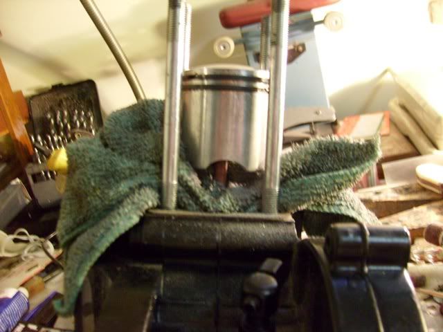

I did the skirt trimming on one of my bikes a couple of weeks ago after reading about it in the performance tips section and some advice from 2door. As was said the increase in power on mine was mostly low end, I gained about three mph up the road from my drive to the crest of the hill. If you think about it any amount you take off the skirt in affect doubles, it opens the port fully at tdc and opens the port sooner on the up stroke. I took around .250 off in the center of the piston so the way I see it the intake port is open alot more.
