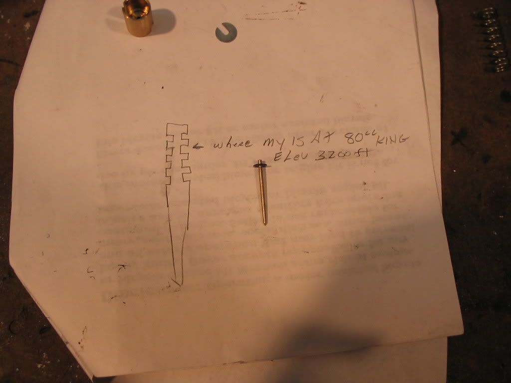

drop the needle down. stock is #2 spot up from the short end. For example the c-clip on the last groove closest to the taper is richest and c-clip on the every end is leanest. Does that help and make since? I need to get a picture. As it would explain it best.

Think of it like a stopper.
the longer the stopper the better the seal... So when you move the clip UP toward the flat end the rod, it becomes longer and goes farther into the seat making a better seal.
If you move the clip toward the pointed end then you prevent the stopper from going into the seat as deeply letting more gas by it.
More gas toward the point ... less gas toward the back.... Probably not as good as explaination as some but it tends to make it easier for me to remember ...

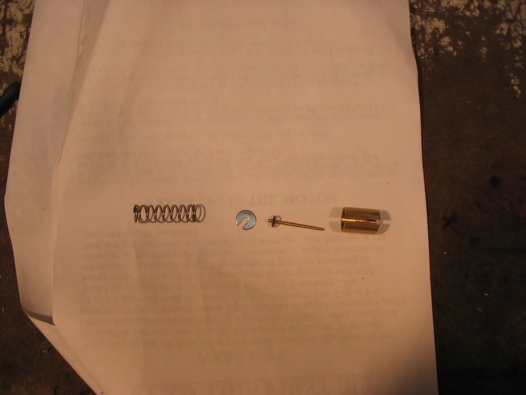

The needle and e-clip goes in first then the slotted washer next so the slotted washer goes over the needle and e-clip.The spring and the slotted washer hold the e-clip and needle in the slide.

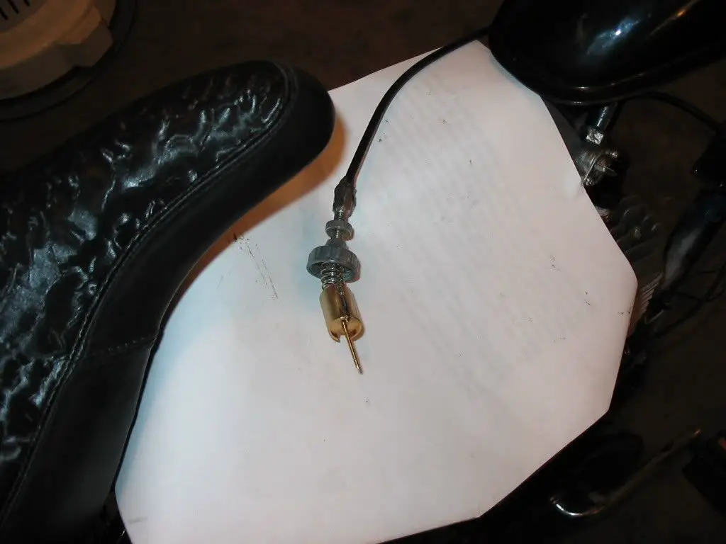

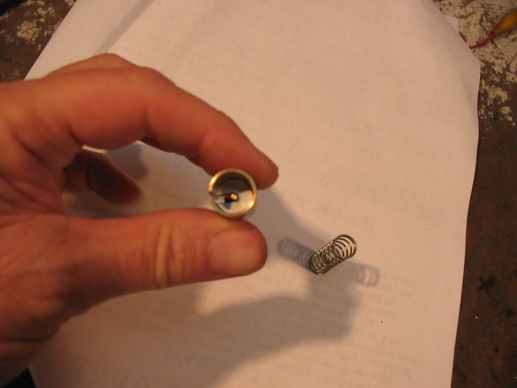

Here the pictures of the carb and how it goes together I also made a mistake my engines both have the e-clip in #2 slot from the top or short end. Pictures will help explain.

Hold on do I have mine assembled backwards. Does it not go from the shallow end through to the deep end. It looks like yours goes through the deep end to the shallow end.
never mind I think now i have it. I flipped the brass pipe over and now it all makes perfect sense. Dang it Norman I can't believe my mind is that soft that I couldn't see what was going on. Geeze now I'm ashamed to show my face here.
Norman
LORD VADER Moderator
Jan 16, 2008
2,606
7
38
71
pampa texas
Deacon
Are you asking about the slide? the slide is flat on top the bevel end goes into the carb first or the proper name is ( cut away) on the slide. The floor on the slide tube will be at the bottom when all goodie are in place. Does this make better since.

I got it from the pics. The reason the one bowl of the pipe is so deep is it HOLDS the spring right? I had the darn thing backwards maybe why it was so rich.

Those pictures are how I have mine now and guess what? It runs!!! It's a little lean from the first adjustment to the top groove (and I didn't feel like fixing it now). Bottom line - your pictures above are correct!!!
Just how many errors could be in those instructions? That one is particularly bad! Actually I'm rather pissed!!! People would put it together per the instructions and the thing won't run. That is terrible. I flooded the thing and wiped out two spark plugs. I guess it's kinda good for the metals - soaked with very oily gas.
Anyway the bike is running OK. I'll need to go back to the second groove and set the idle. Probably get a fresh plug.:ride2:
