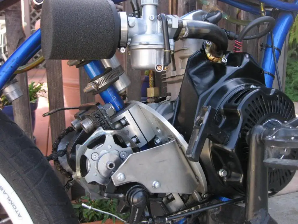

I really like the brake rotor on the jackshaft... Have a write up on how to go about the rotor mounting? It would be greatly appreciated! I plan on doing the same to my Genesis Astra when I install my 70cc Loncin :D

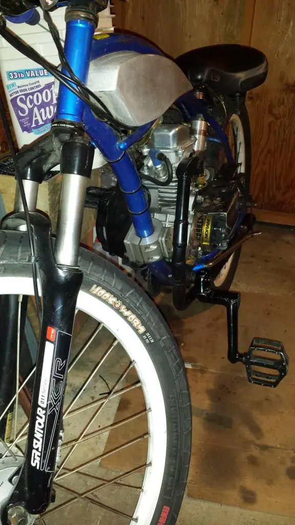

I'm currently, or going to start, a Dyno build. What did you use for a rear hub? I measured the rear dropouts and its 110mm. Did you spread your dropouts to 135mm to get a disc break hub in there?
I'm only asking because I'm unable to find a 110mm disc hub besides the Dam good engineering one.
Thanks
scotto-
Custom 4-Stroke Bike Builder
Jun 3, 2010
6,505
25
38
Ridin' inSane Diego, CA.
Scotto
Thanks
Hey Mike,
I used the Grubee HD axle kit hub and it is 135mm spacing at least. I did spread the rear stays a bit using both feet pushing the inside of the left stay while pulling with both hands on the right stay in a seated position.
Just do a little at a time and measure as you go. It's kinda tough but don't get to carried away as you don't want to fatigue or kink the metal by going Superman on it ;). A true precision way of bending the frame how you want it laff
It's better to leave it a little bit snug, than having to pull it together with the axle nuts.
The reason I use the Grubee hubs is they have four sealed bearings, they are made of steel and already drilled for 36 12G. spokes and the flange or freewheel threads onto the hub keeping a fairly true running rear sprocket.
Sure they are kinda cheap and heavy, but they are also inexpensive and rather strong as well.

What size is that rotor you ended up with on the jack shaft?
I can only seem to for 160mm and if I do the same as you did, I like the cleaner look of the small one.
If I remember correctly, I cut down a 185mm rotor to about 90mm. I don't like the look of anything much larger in that area of the bike.

Niiice. It works that way even with the centrifugal clutch? Been a while since I've ridden anything with one...
Yeah the clutch doesn't disengage till around 2,000rpm when decelerating.
On my 212cc the engine braking is three to four times more powerful using the same clutch set-up. Just like a real 4-Stroke laff
