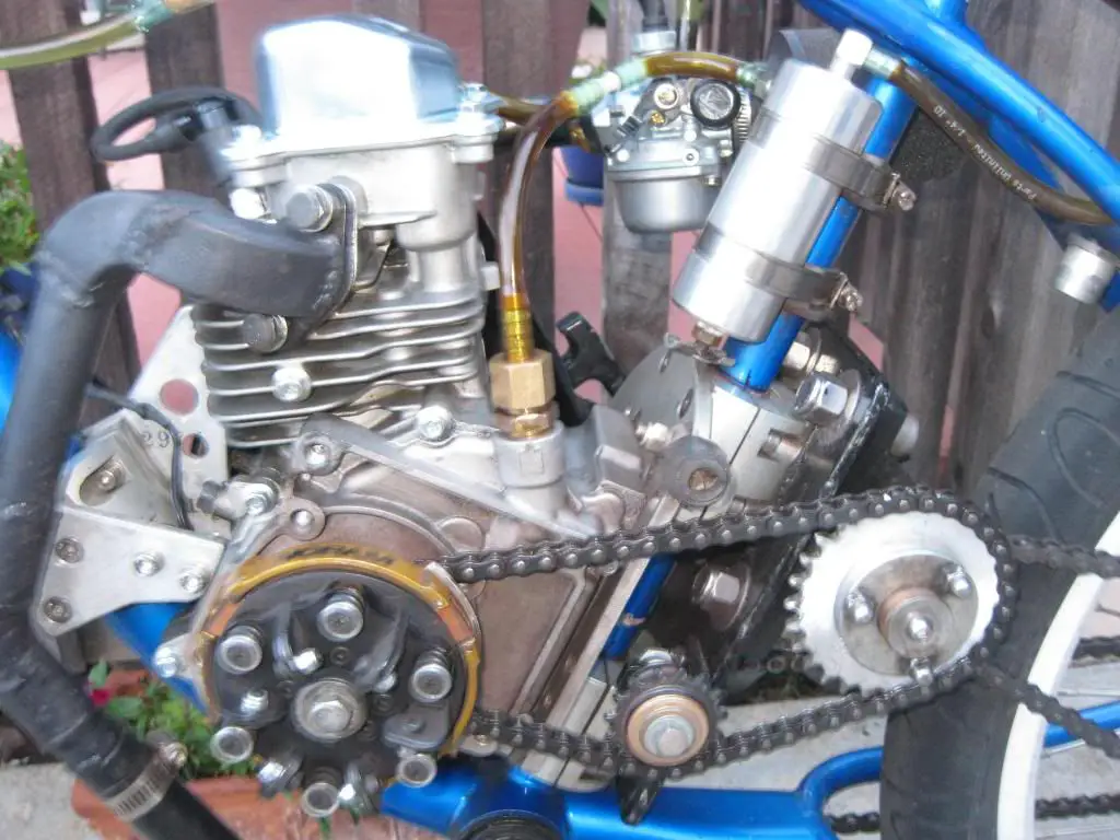

You might not have noticed the new Honda valve cover......it is much nicer than the stock Pred cover. The beauty of this cover is that instead of a hole in the cover for the rubber breather hose, this one has a welded on nipple.
The big difference is you don't have oil coming out from this area of the cover. No matter how well I sealed the hose where it goes into the valve cover (not sealed from the factory mind you), oil would somehow find it's way through and cause a little mess after time.

Speaking of valve covers.......look at the new idler pulley made from a Noram clutch driver. Was riding home in the cold dark last night and the idler came off and threw the primary chain somehow.
I ran out of skateboard wheels, but have plenty of clutch drivers......problem solved ;)

How did you sleeve the shaft to fit the clutch?:-||
I bought some tubing that was made to reduce 3/4" OD down to 5/8" OD and cut it to the correct length. Then I cut a slot in the reducer to accommodate the the key for the shaft key way.
one more question i dont think you ever said this but what size sprockets are you using? teeth wise
You're right, I never did say what size sprockets I am using cuz it's top secret. The gear ratio is 12:1. Do you want too know what size sprockets I use with the jack shaft to get that ratio? Of course you do :D
Here is what I use, a cheetah 2-disc clutch w/13t driver to an agk 26t......then an 8t off the j-shaft to a 48t rear sprocket. It ain't rocket science, but it works for me.
I have one also,did you use a thicker key on the shaft along with the sleeve?.........Curt
Yes I did Curt.
