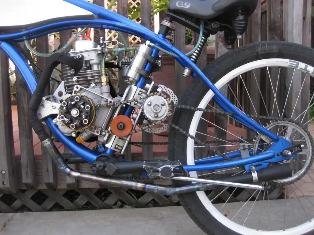

Predyno 99cc......the ultimate daily cruiser!
Haven't blown an engine yet.......the valves start floating at about 6,200rpm.

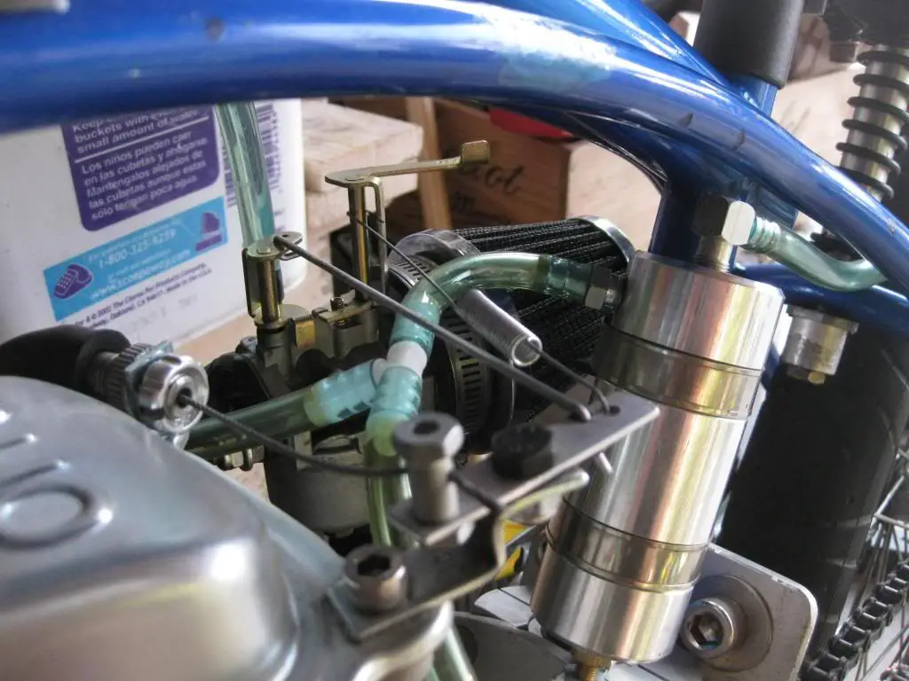

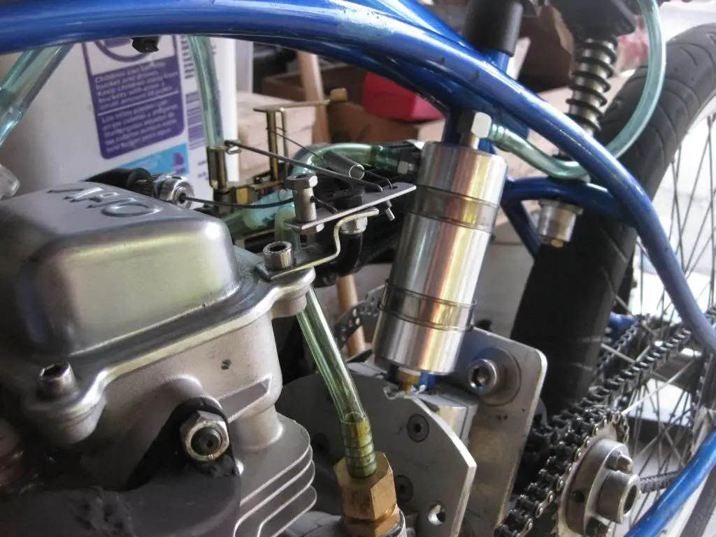

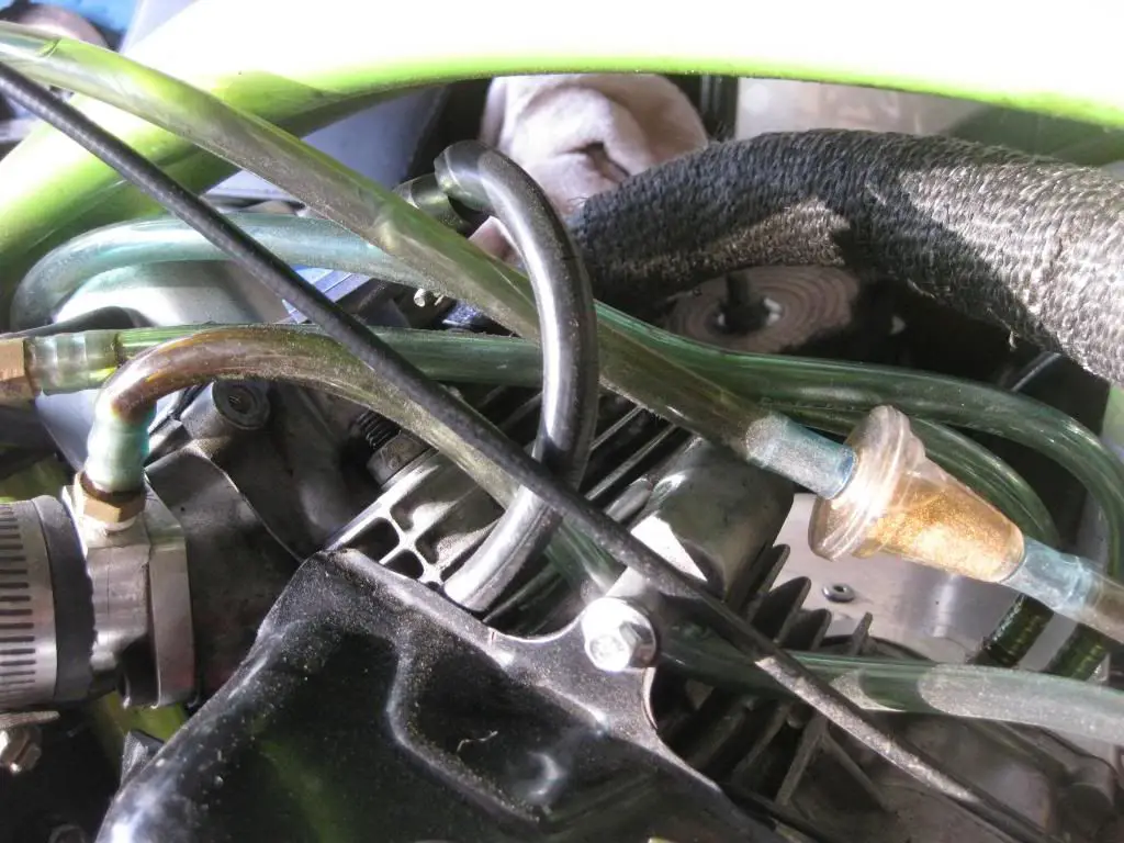

Thanks, some heavier springs would be nice but I'm keeping this engine stock outside of the larger carb that I installed from the beginning. And yes there is a catch can on the green bike, that's where a lot of the hoses are running to :D
dnut

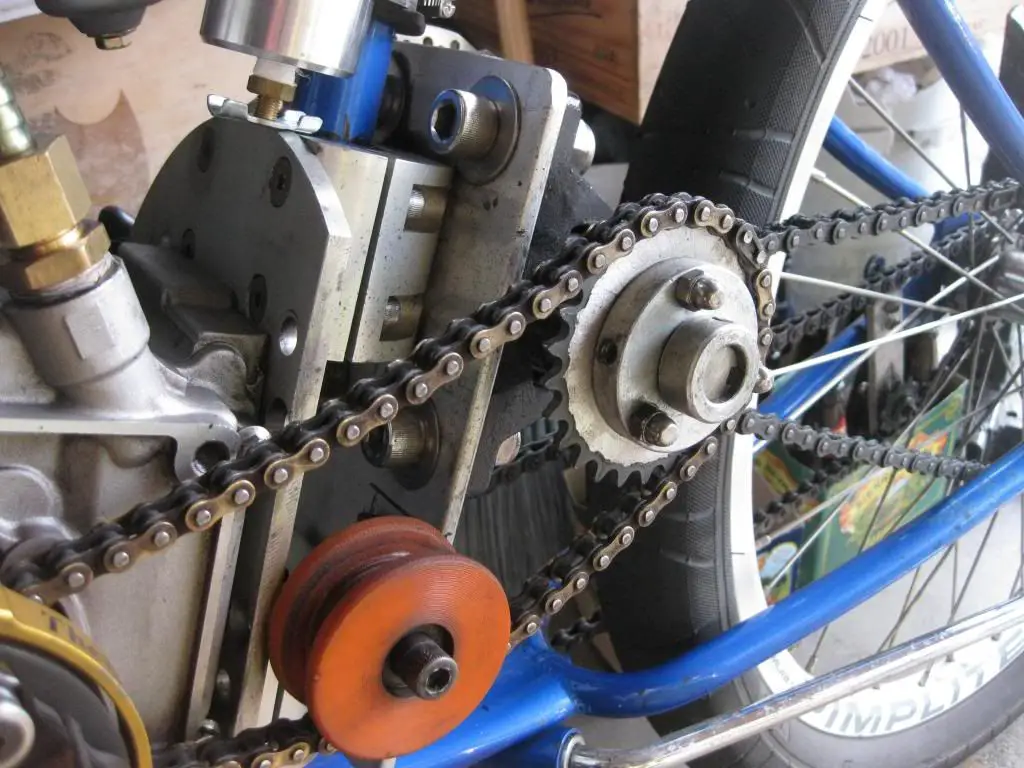

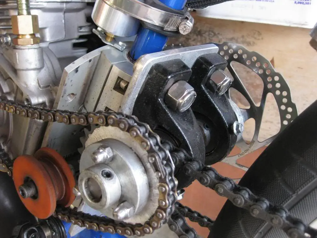

Here are some close-ups of the throttle linkage, catch can and the jack shaft set-up that might help you with your own build......

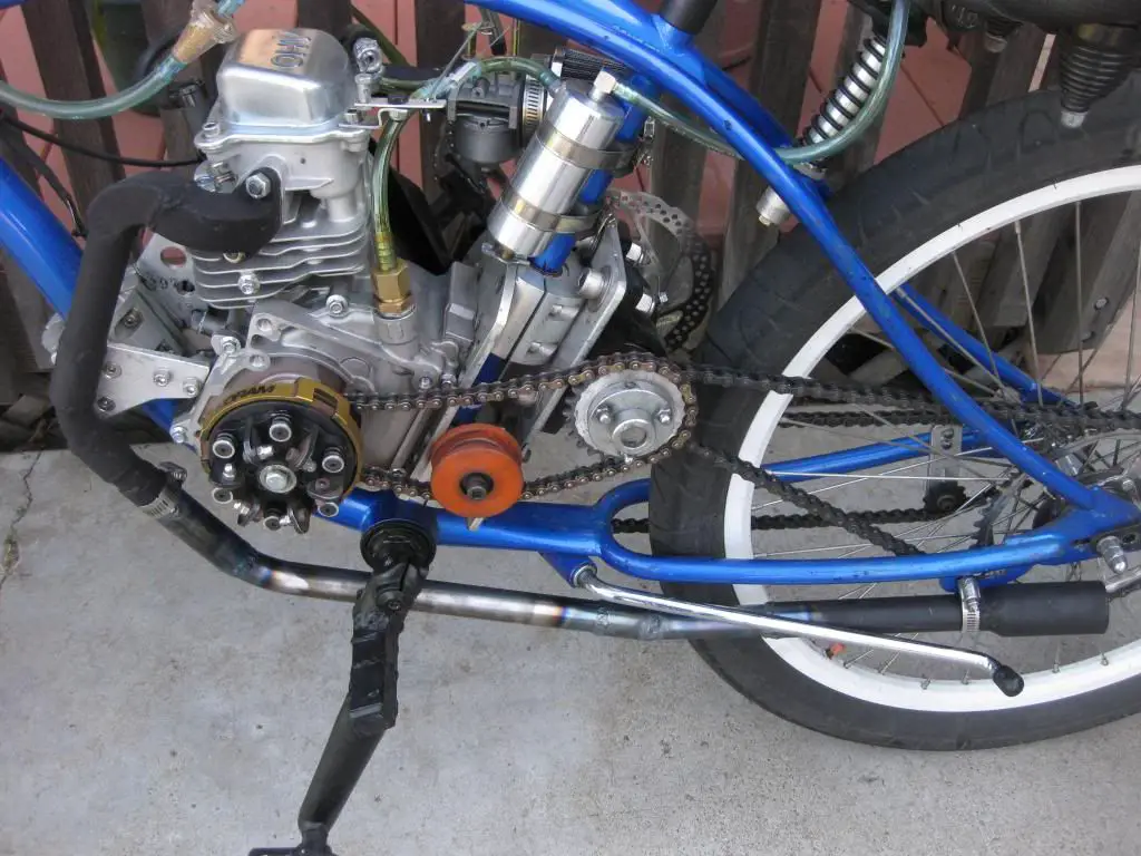

Finally got around to building the quieter long street pipe for predyno.......what a pleasant decibel reduction! Here's the pics......
This pipe is like hush puppies for the 4-stroke.......
Can ya tell I don't own a tubing bender? laff
This pipe has cut the sound level in half and still sounds really good with a nice low pitch. I made it a convertible so to speak, too make oil changes easier and be able to switch back to the shorty version for different applications. A slip joint and hose clamp make for an easy add-on......I still need to weld a tab for the rear mount to the coaster brake bracket (temped with just a hose clamp atm) and paint the pipe.
