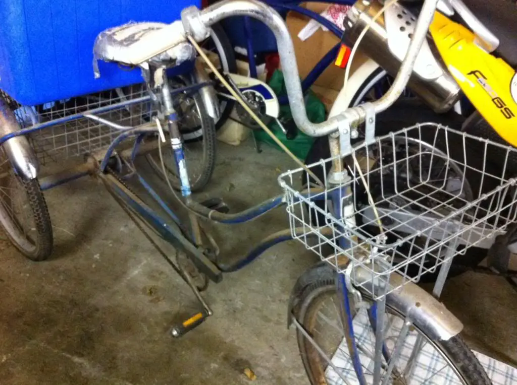

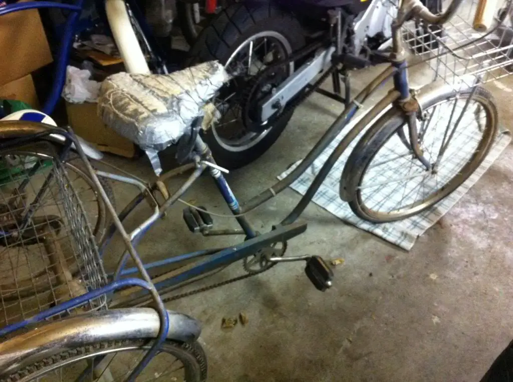

I have the below pictured trike that i bought for burning man. Due to a recent personal injury I am looking into motorizing it. Unfortionatly its frame build does not fit the current expected form for fitting the engine. Does anybody know if there is a way for me to do it?
Here are a couple of shots, let me know what you all think and thanks!
The simplest way to motorize the trike would be to attach a friction drive motor to the front wheel, If you live in a dry climate, like SoCal. Not as good in wet climates.
You could also go with an electric hub motor front wheel but it would cost more.
I agree that mounting a China girl motor in that from would be a hassle.
Not THAT big of a hassle Wheelbender, Just mount it to the seatpost as usual, Then weld in a front "braced" mount. Then all thats really left is to attach a rear sprocket to a locking axle collar.
I've only built this type on a mens cruiser frame, so I kinda know whats involved, And it ain't real easy, but it's doable.

If I am motoring around at no more then 5-10 miles per hour will I have those issues? It is not permitted to go any faster then that as it is.
At those speeds it shouldn't be a problem but I can't say for sure.
From the looks of that rear end I'm going to assume your limited to front wheel drive or jackshaft to the stock rear end and sprocket?
I would say the best bet to achieve your goal would be front friction drive. I would use a harbor freight 79cc with and 11 tooth clutch bell ran to a 22 tooth sprocket driving a 1.5 inch roller. This would give you a top speed of about 8mph with the governor still connected and cost less than $250 if you can build it yourself.
Would the kit I linked earlier get me close to that? It's a smaller engine and different sprocket but with some self control I am hoping I can make it work. On my budget I was also thinking I could maybe mount a China engine behind the seat and run a chain up from the rear sprocket/axle. My biggest concern is that I am going in for knee surgery soon so I want to settle on a project that will not require a massive amount of tinkering to make it work. My other option it seems is to drop $800 on electric system it seems to me.
