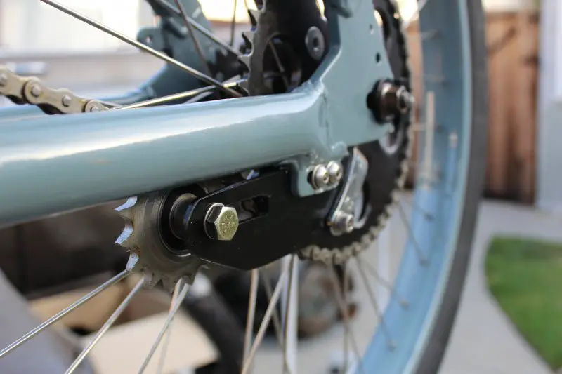

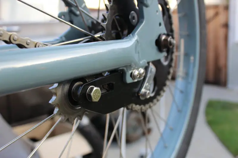

Pat D's 3 piece hub adaptor holds big torque better than the Manic in my experience. I tried both on my two bikes using 10 hp + 5 speed wet clutch Honda 125 cc clones & the Sportsman product is what I stayed with. That said I am also using red locktite applied to the clamps surfaces, not the threads (blue for that), after prepping the hub and clamp surfaces with 80 grit & de-greaser. No slip to this point, many miles, later and that wet clutch really locks up and launches incredibly hard. Though I'm positive lacing up a moped hub with 8 gauge spokes is the real answer to wheel problems & braking while using more powerful motors; I'm really looking for the look & feel of a bicycle in my builds, regardless of motor size.

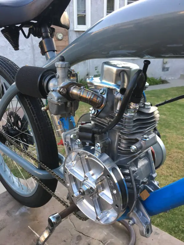

The little things, like selecting clamps for motor supports, are actually huge in the areas of practicality and dependability. I've used Harley tube clamps as the sole support for a 70 lb. motor/transmission & it's remained rock solid & vibration free...good clamps, accurately positioned really work as motor mounts. Look great also. Use of the small rear sprocket on the pedal side gaining case clearance was innovative and absolutely solved a real design problem often faced with big motor builds.

I need to try what you say about the sprocket adapter, checked my stock and looks like I have the first version Pat made, looks a little weak and the 40 tooth is small, have another one from Jakes Bikes with a little more meat on It i may try...46 sprocket.

Jeff the HD clamps are the go to clamp for Harley's 1" and 1/1/8" tube diameter, black or chromed. 1/2" hole is most common I've noticed, which I've made bushing for several times. I'm telling you they CLAMP. and I'm pretty familiar with the high dollar tube clamps used on roll cages and tube frames for off road racing. In the sizes available these are better. The size spreads the clamping surface area & really resists lateral forces while preventing tube damage from clamps compression, though not a problem with even thin wall DOM tube, could possibly damage a box store frame, but know you won't be using anything that is suspect. For those who don't have a good AC/DC Tig and want to build using an aluminum frame they are quite helpful in the limited sizes available.

A two piece adapter may hold firm with Locktite though I haven't tried it with a high power and low ratio engine and drive train, my Simplex runs a 56 tooth rear (really low with the 5 speed gearing & rendering 1st. gear a seldom used selection) and the Harley runs a 44 tooth...& the same light drive reduction from engine secondary offset sprocket cluster, although the Harley has some significant additional power mods compared to the stock CG 125 in the Simplex build, which I'd estimate add add 3 or 4 hp to the output. I bang into second and third occasionally and the setup hasn't bent any spokes to date.

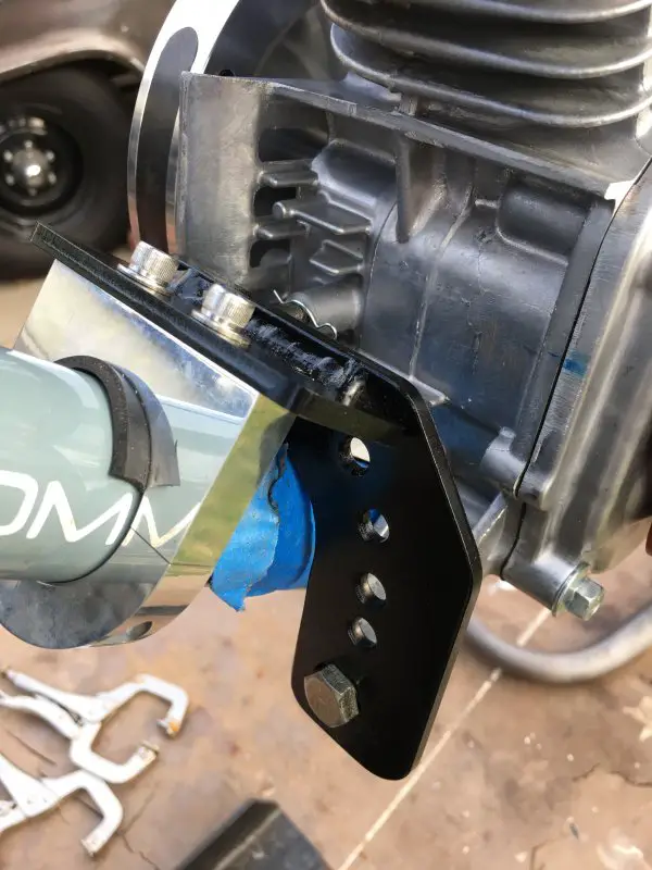

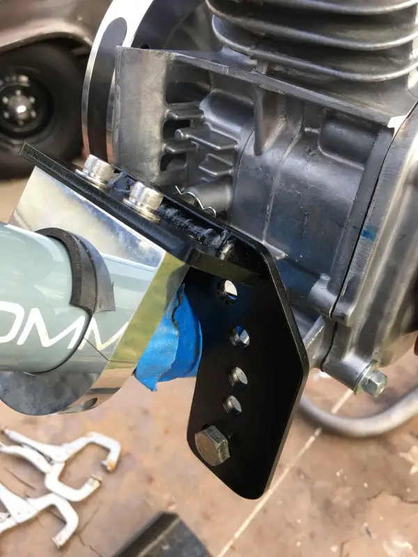

Hey Rick, think I have the sprocket issue resolved, did a couple things you mentioned, thanks for the help.
I have been on a couple decent rides on the bike and noticed the engine and cvt plate had issues, the motor was moving around a little too much and the cvt plate was flexing bad during hard acceleration. Added a couple supports, one on the head and another on the cvt plate to the rear motor mount. Made a big difference and put it on a good test ride today. A couple pictures which include the Porsche event at the Flying Museum in Santa Monica I stumbled upon on my ride.

Building something that really works well (for what it is intended) is huge. I'm so glad the problem issues mentioned are being gathered in. I've used the head bolts as an attachment point for frame support since my purchase of a Cushman Eagle in '59 or '60. It had a small bracket that secured the cylinder to frame that kept breaking & the big bore engine would shake like an out of balance washing machine! I finally made one that held up to the stresses. Some well balanced engines may not seem to need cylinder support. but I think it a good idea anyway. Sometimes the answer lies in using the head...good solution on your bike.
