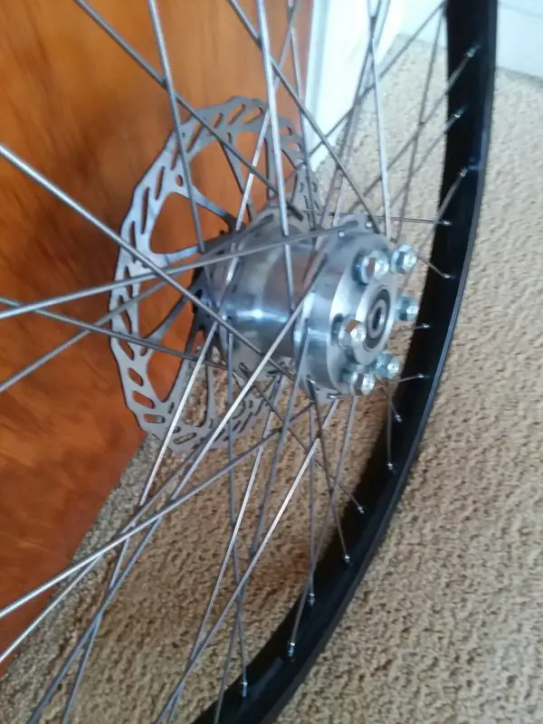

@ indian22 that is one sweet build. How did you mount the disk on the other side?
Thanks Wayne that rear disc was made possible through my purchase of a billet aluminum hub with sealed bearings and steel wheel with 12 ga. stainless spokes. I just bolted it in place (well 'kinda) and with the new Maxxi Holy roller and Avid Caliper (cable pull) with dual pull brake lever and my wallet $350. lighter. Now I've a disk brake on the rear right side, almost painlessly. Correct?
This won't be the last time I use this exact hub on my bikes front and rear. My Simplex will be next and it gets 10 gauge, DOT rims and billets hubs front and rear. The hub was a great addition to my extended frame hybrid.
Rick C

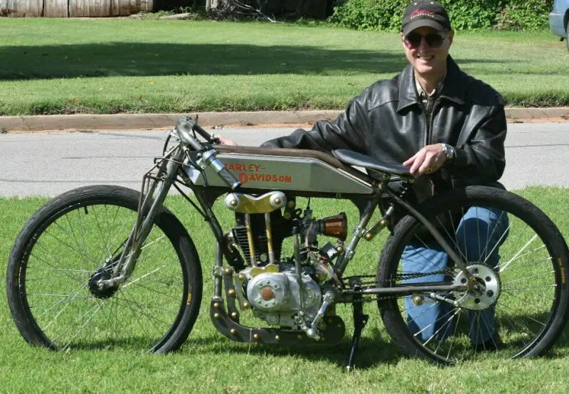

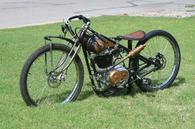

What happened to the Lifan that somebody was going to tune for you? I'd like to see how they got on with it. Ours came in at over 14hp at the back wheel on a slightly pessimistic/realistic dyno.
Lugwig I've mentioned the two Lifan's outputs in scattered posts, but don't think I've been very specific on the engine that eventually found it's home in my 145lb. Harley "Peashooter" build.
Mr. "Grumpy" was the motor guy on both the Lifan's 125cc engines the one used in the Simplex makes 12hp plus in the 6,250 rpm range and the Harley mid to low 14 at mid 7,000 rpm. Both engines will crank to insane rpm levels but are not doing anything much after 9k by the seat of my pants. Grumpy's small engine dyno limits out at 30hp or so, but is quite accurate between 5 and 20 hp. I've learned not to ask him anything specific and that loosens his tongue to relate a little. His nickname is actually quite flattering as he's a real bastank through & through!
Your motor output was probably pretty accurate Ludwig. The cam and valve work on the Simplex was mild and low end tractability is still excellent pulls easily from dead stops from second to give you an idea and is a joy to ride at all speeds.
The Harley isn't. Going for a couple more hp came with a cost. It's high strung as heck, but really fun when she comes up on cam and being a real light weight, compared to the light motorcycles she was designed for, speed on cam even in third hole is significant. I've topped 80mph several times, after break in, during brief run ups at the air strip in fourth. The bike tracks well on this smooth surface, but I'd want a steering stabilizer mounted for use on public roads at highway speeds. I seldom ride the Harley because of this tune, but that's ok; it was built as a tribute to a real racer and my bike's performance is a tribute of sorts as well. I could gain some daily transport utility with the HD by switching to a 54 tooth final, which I have on the shelf, but probably won't. So there's that!
Cams lumpy as heck on the HD but the Simplex grind is quite mild, Grumps is an engine master but slow and seldom takes on any work of any type. He shuns using parts he didn't design or modify to his purpose and what he builds is what you're stuck with. The good news is his motors always seems to work, 'cause your not getting any money back!
Ludwig that's about the extent of my insights, engine wise, to these two 125cc 5 speeds. I'm glad I chose them and pleased with how they perform though each displays distinct personalities. My use of fake heads and side pushrod tubes on the Harley accent it's nature as "Grumpy's Toy" (different Grumpy however).
Rick C.
