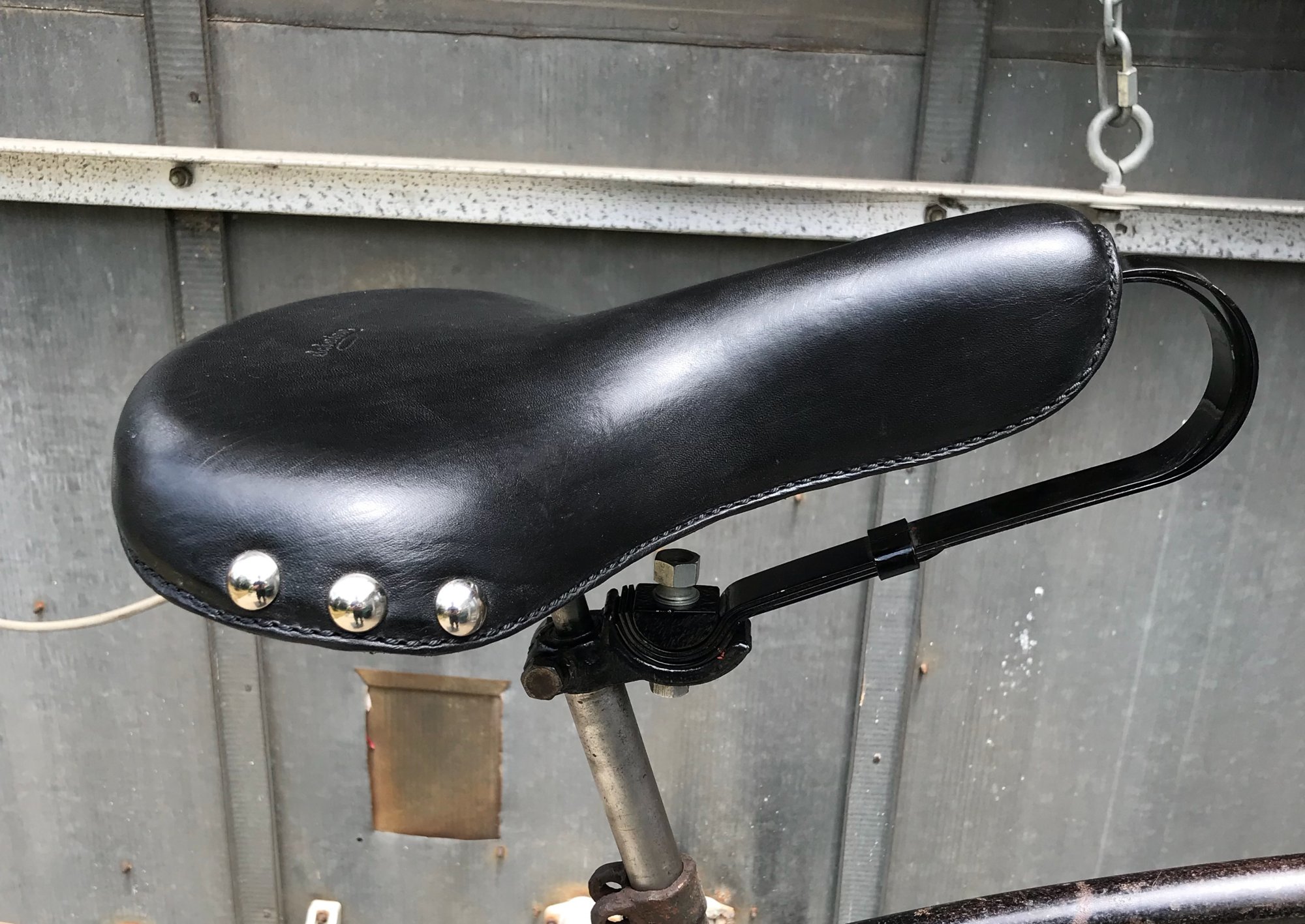

Tom the 1936 Schwinn "Auto Cycle" used the Milsco saddle that's was called the "pogo" suspension and was aptly named for it's seat post vertical spring concealed inside the post. The pogo spring tension was adjustable by a simple bolt located at the bottom of the post tube, so adjustment required removal of the post from the seat tube.The attractive, Brook's style leather saddle, was extravagantly brass studded, the seat was sprung by leaf springs forming a spring loop at the saddles nose, at least on this first year Model offered by Schwinn, the leaf may have been changed on later models of the Milsco, but the pogo remained.
I think I saved a screen shot of the suspension details a few years back, Sheldon Brown article/blog I think? I searched for the photo, but think it's on an old drive. I'll check & post if found. Milsco catalog reproduction may also be available on line
Does this sound like what you are interested in Tom?

This is Kool Didn't know Schwinn made one, but have seen leaf spring seats on old motor cycles of the past. I bet this would be a soft ride...........Curt
Yep Curt that's the original as I recalled it and there are 2 springs and he calls it the Pogo full floater saddle. Nicely restored original Milsco that was introduced on the Auto-Cycle of 1936 for the first time. Yes with these photos a fellow could build a full float saddle.

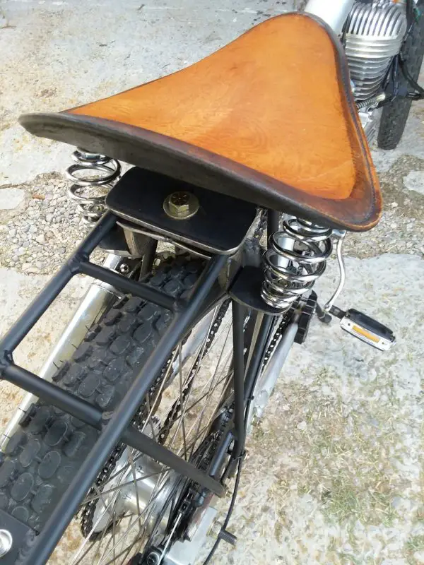

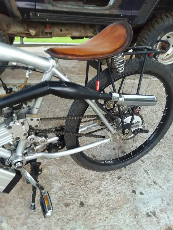

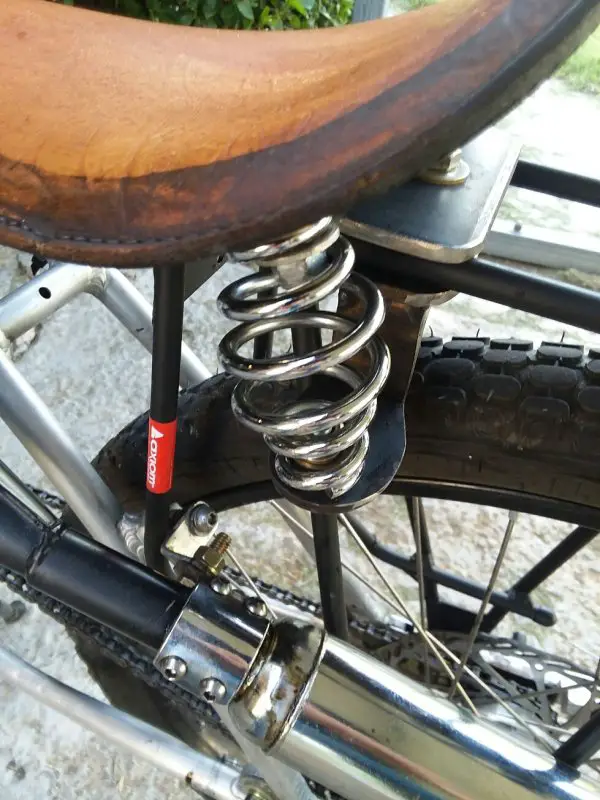

I completed the alteration of my saddle mount, at least it's installed and it sits level & low like it did prior to adding the springs, forgot to take photos but I'll do better tomorrow. I do think it will be more effective in keeping my backside properly located Tom and look better doing it. Both the nose and bolter were lowered 2" in front & almost 3" in the rear.
Rick C.
Photo update of progress. Good news it works well & bad is I have to take it apart to finish. I'll wait till the Maxxi Holyrollers get here for that.

Rick, seating set up is looking good.
