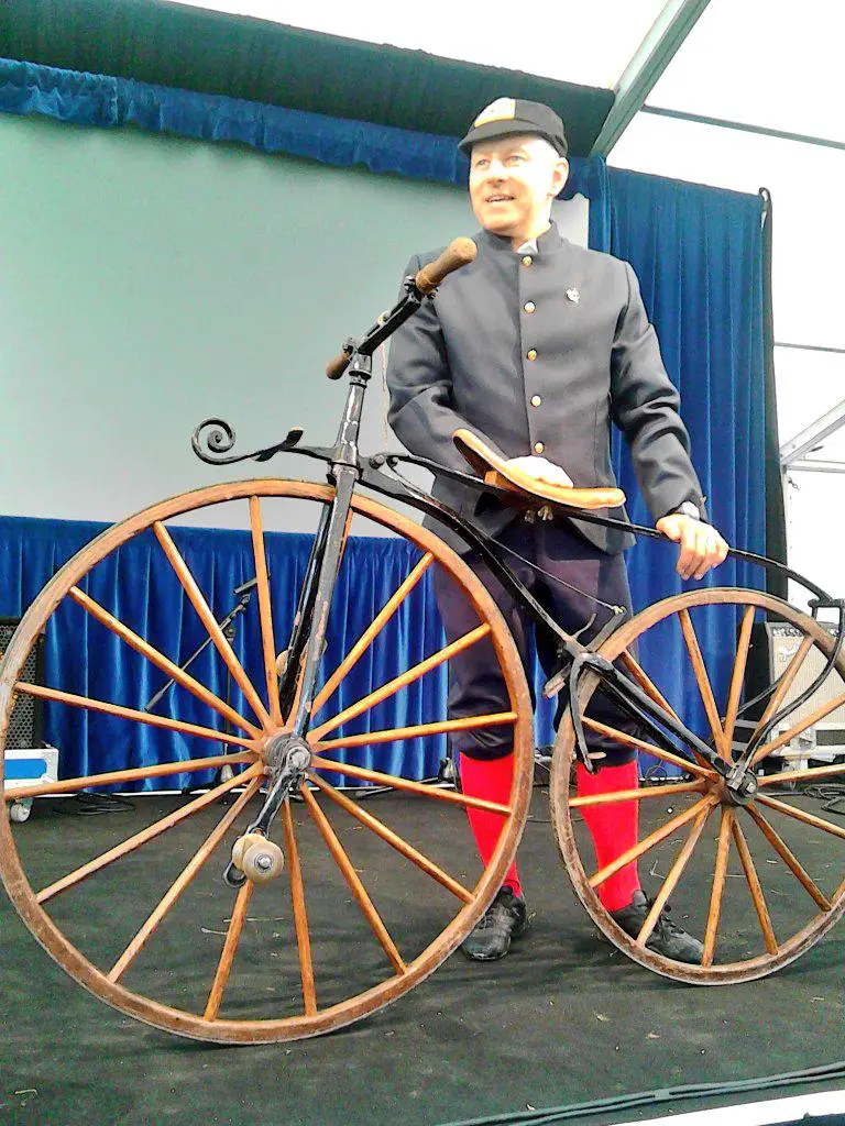

Doug is heir to the Pinkerton Collection, hundreds of old bicycles, some historic and rare. He has lots of frames, forks and wheels from various eras in his shop stock. Sometimes a bike is released from the collection as well, it's currently in storage.
In addition there is Yeoman's at Belbroughton not far away, vintage motorcycle spares in 7 sheds. Want a cylindrical tank for a Ladies Model Royal Enfield off the shelf? No probs!

Ludwig I am some of that in love with the beautiful bike pictured! It's great to have friends with similar interests like Doug who understands your passion for things memorable and perhaps historic, not just transports. I myself like old dogs, fast horses, ancient whisky and younger women (especially when they mature gracefully). I certainly regret not taking the time to search out some of the curiosities of the U.K. when passing through years ago; just always in a rush.
